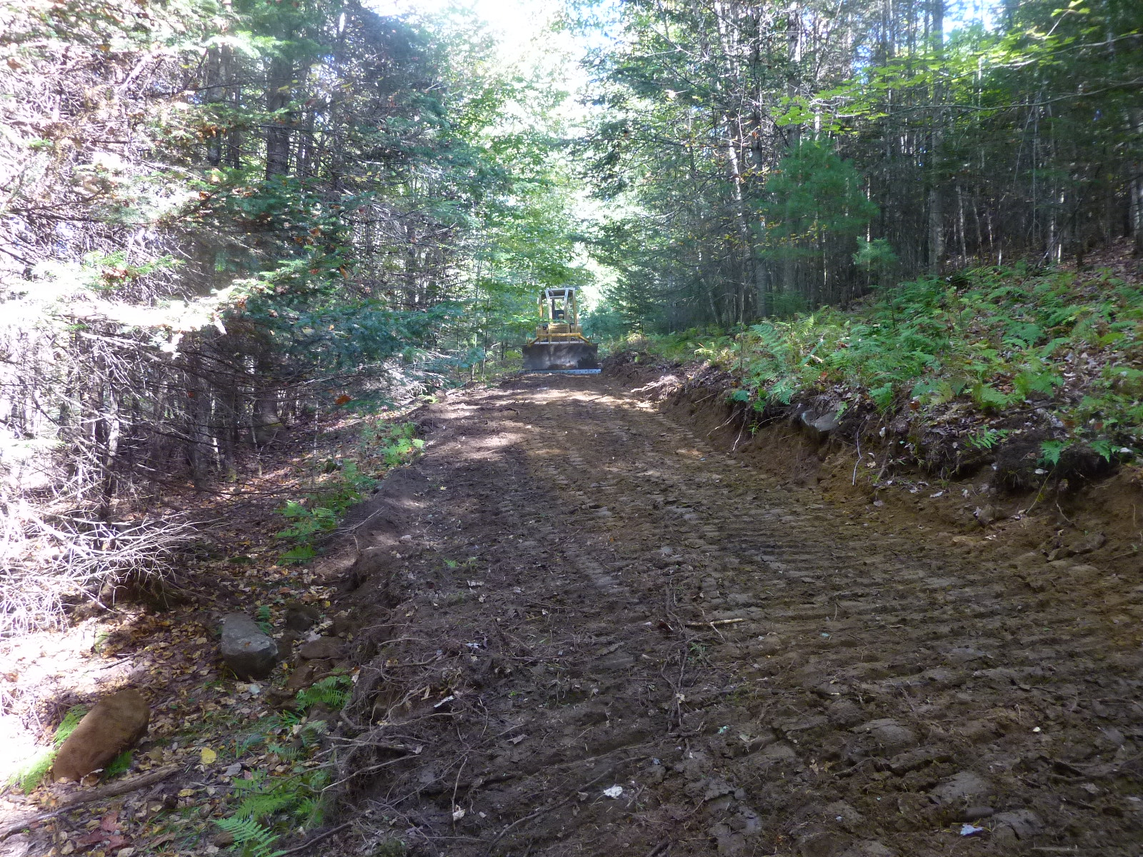

We tend to like a little bit of outslope on our side-hill trials to help keep them from retaining water.
   / Cutting ATV trails into cross slopes #42
I'd not call outslope a "tend to like" property. If you don't have it, your trail will be washed out asap.
   / Cutting ATV trails into cross slopes #43
I agree. I really understate the need for this. Without outslope or some other measures will either wash out or be a muddy mess.
We do have areas where outslope is just not possible, or where outslope alone is not enough to protect the trails. So we resort to other or additional measures to make sure the trail drains properly.

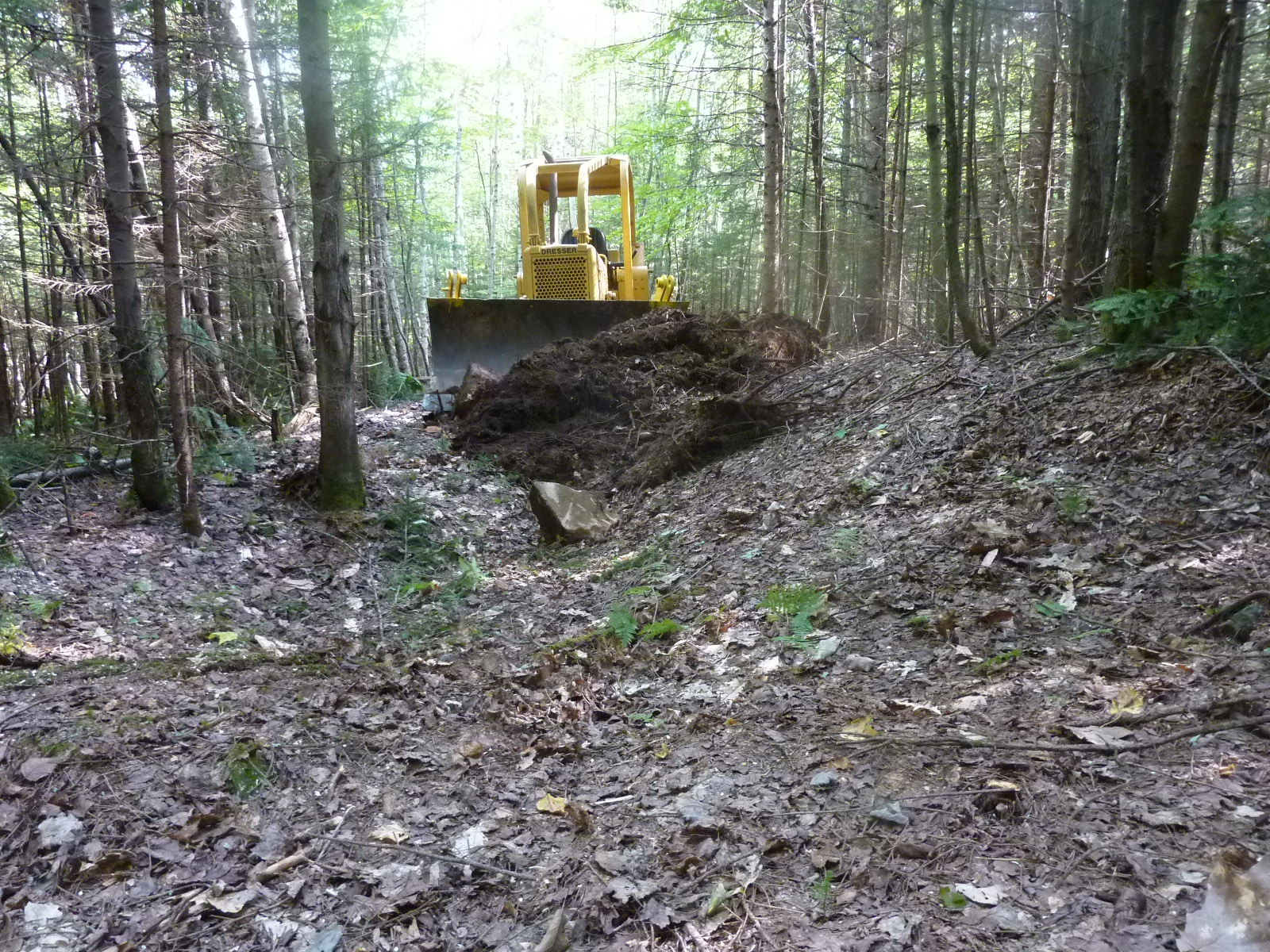

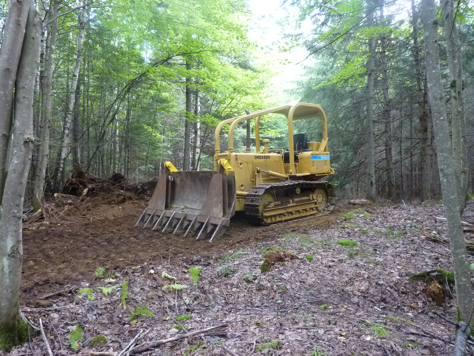

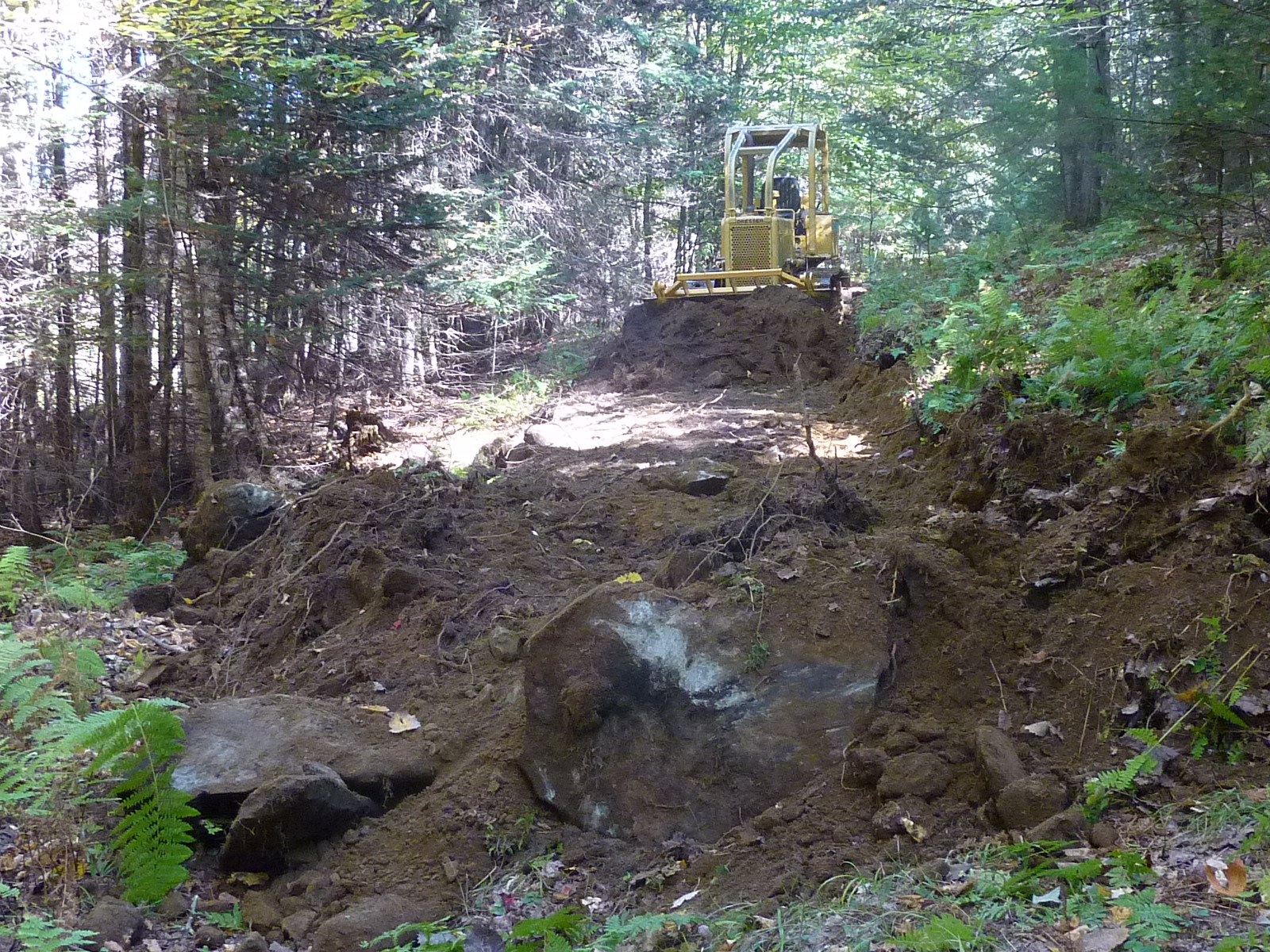

I use a small 70 hp 14,500 lb dozer to build tractor roads.

Be careful with your spoils - they are best cast downhill and spread- using them as the outer part of your tread will likely result in the outer portion failing early and could lead to a safety issue- its best to have the entire bench result from the cut.
And use a mini-x
Correct - the big thing is the base of the trail stays on the original cut, the spoils go off the edge for extra width, and pack them in with the bucket if using a mini-ex.
