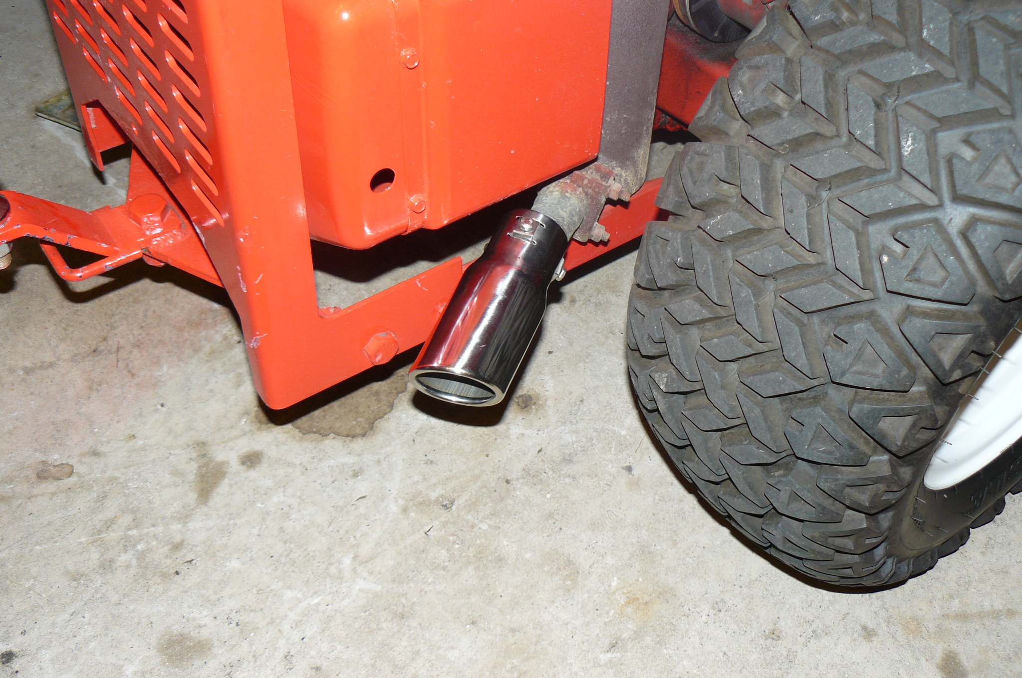

I have HDAP tires on my Gravely and they are superb in the snow, btw.
