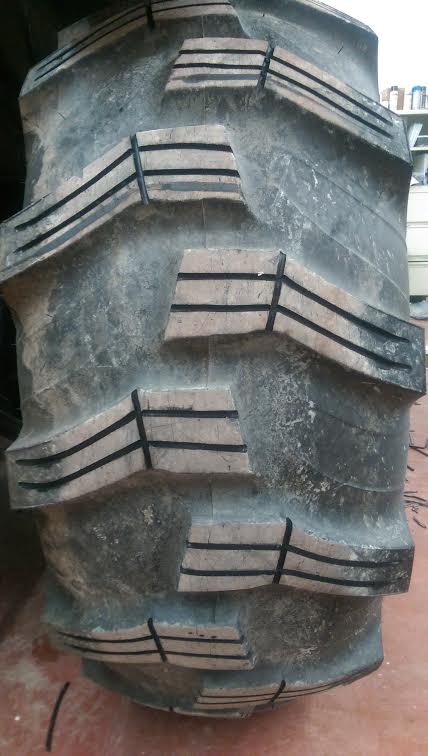

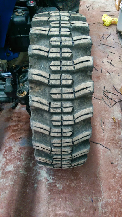

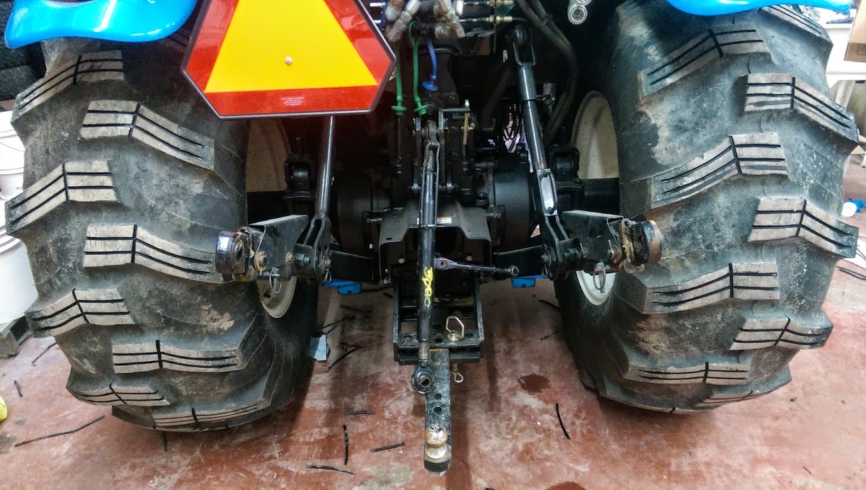

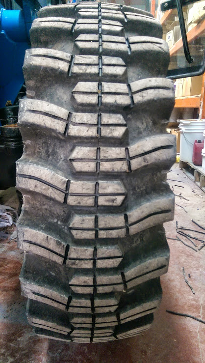

Just finished grooving my tires. Now if we would only get some snow this season!
I plow a lot of paved surfaces and do a lot of road running so chains were not an option. The areas I plow are very steep with turns and switchbacks. With loaded rear tires and pushing up hill in 4wd and the rear diff locked, I can easily get tire spinning. Due to this sipinning, I added two grooves to the rear tires instead of one the most here have done. Afterall, 2 is better than one...right?! :thumbsup: I only put150-200 hours/year on the tractor with 100-150 hours of that snow removal. Can't wait to try them and report back!
Used #4s on the front and #5s on the rear.

Looks really cool ... I was afraid to sipe my fronts too much because I do so much loader work ... they're already wearing MUCH faster than my rears. I only siped every 3rd tread. Those look like they'll get great traction tho.
   / Cutting / Groving / Siping R-4 for snow #359
Danny, I think that's going to work really well for you.
