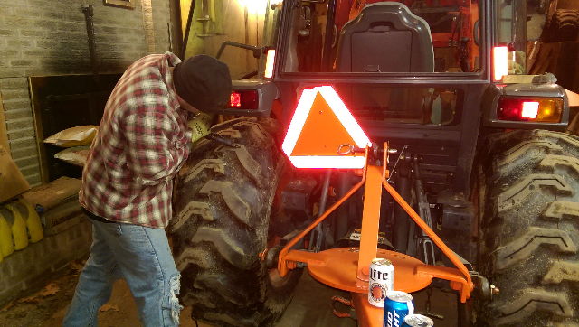

Well, back to topic... The other night I borrowed my neighbors tire groover (thanks KenB2920) ... And grooved the tires on my Massey. Soooo easy! I think I had the whole thing done in under 1.5hrs. <img src="http://www.tractorbynet.com/forums/files/snow-removal/400243-cutting-groving-siping-r-4-a-forumrunner_20141126_133227-png"/> <img src="http://www.tractorbynet.com/forums/files/snow-removal/400244-cutting-groving-siping-r-4-a-forumrunner_20141126_133239-png"/> <img src="http://www.tractorbynet.com/forums/files/snow-removal/400245-cutting-groving-siping-r-4-a-forumrunner_20141126_133250-png"/>
Looking good!

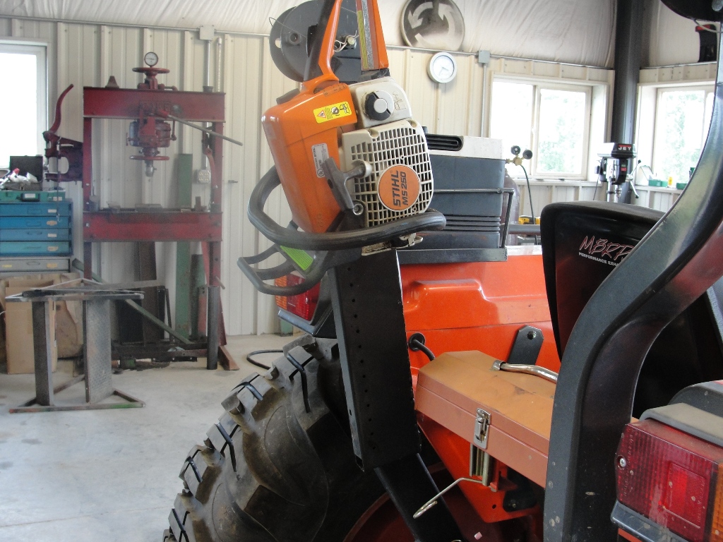

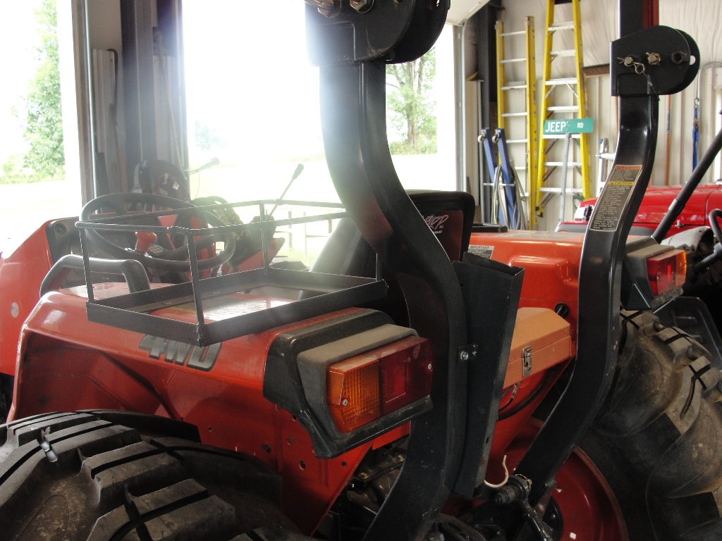

My gang uses a tire cutter a LOT on 4x4 rigs.

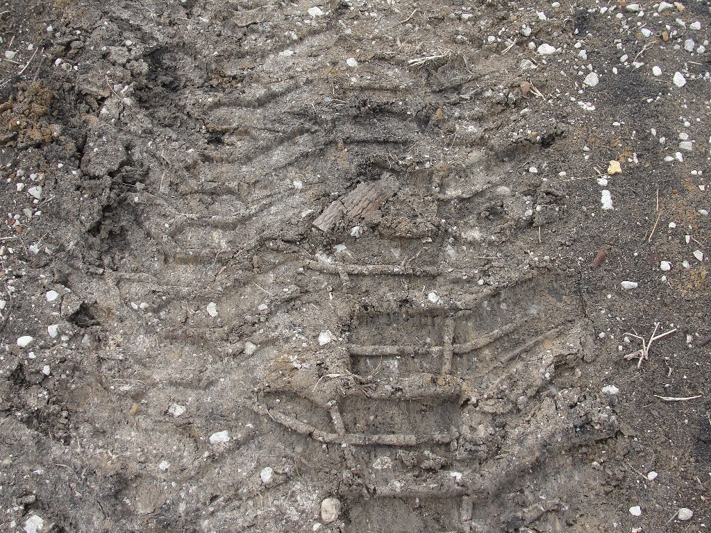

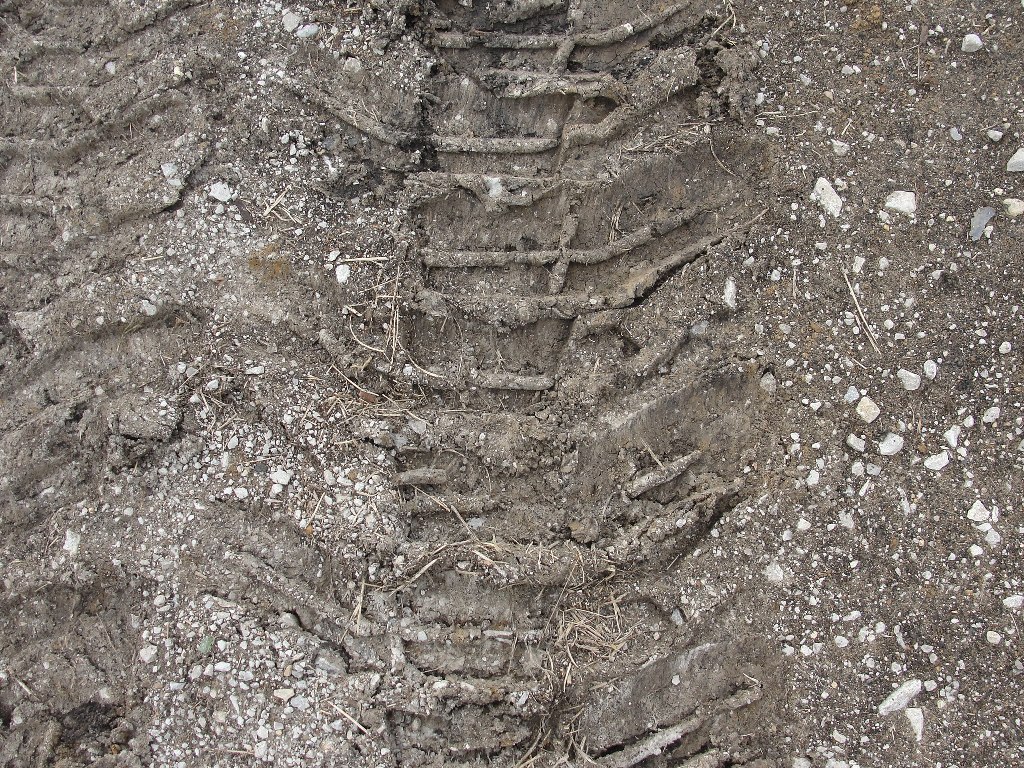

I used it on my previous tractor's rear R4s. Noticed a marked improvement on snow and especially on hard packed dirt. Sorry I don't have better pics.
View attachment 399615View attachment 399616View attachment 399617View attachment 399618
Hi Ovrszd,
What size tip did you use to make those awesome grooves?
Great pictures- don't apologize!
