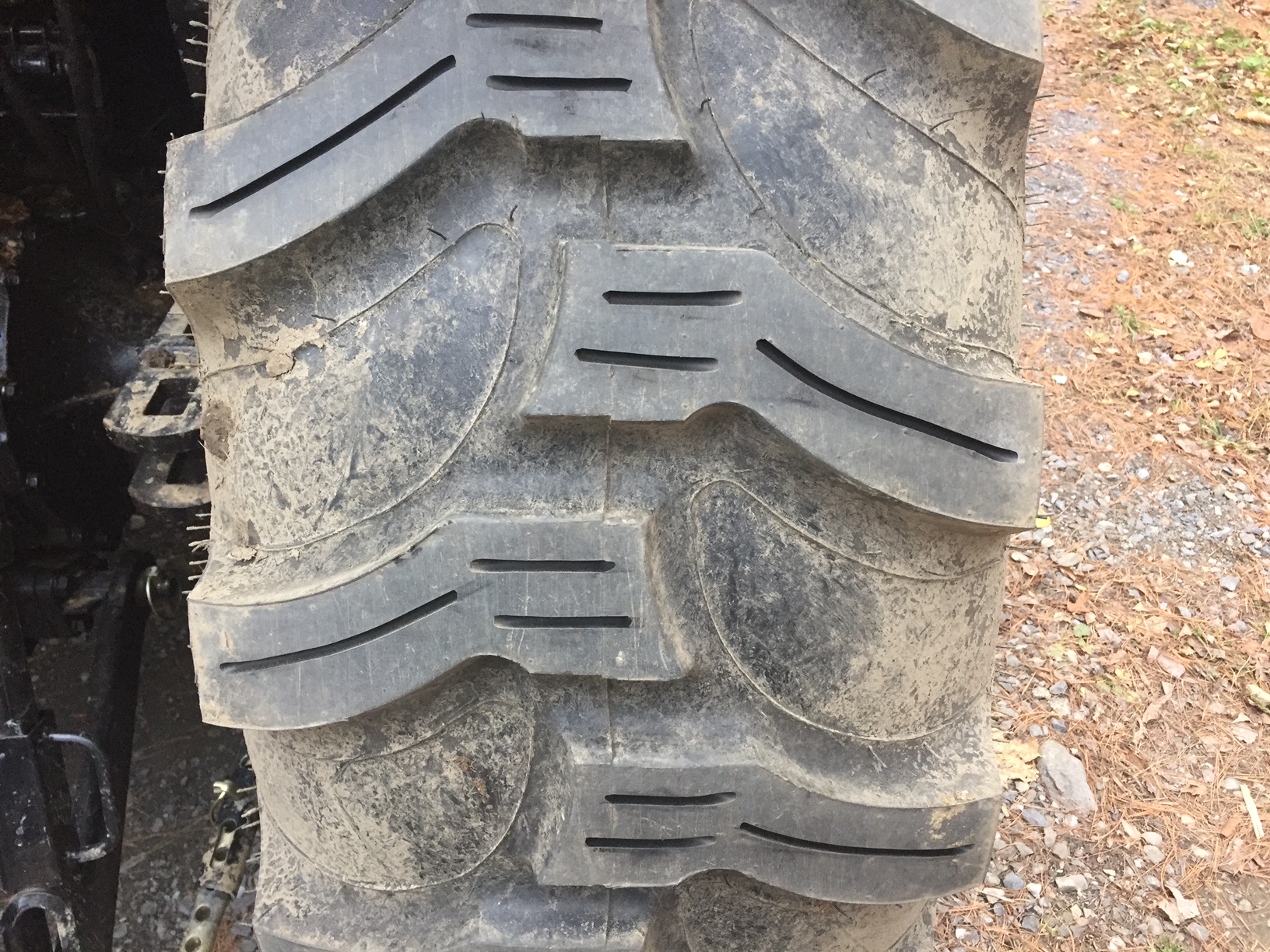

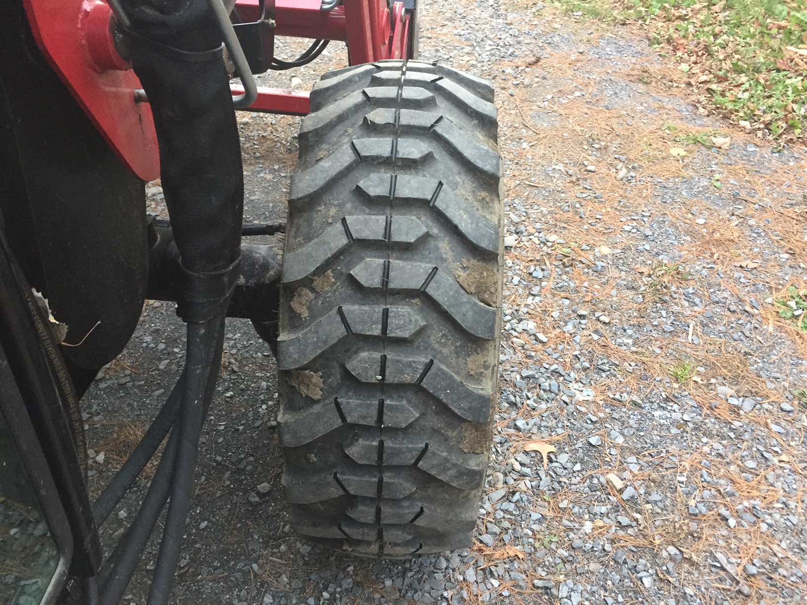

I didn't really have much of a hard time with cutting through the cold rubber. I did all 4 tires in little more that 90 minutes and that was with the 2 cuts on the rears. I made a pattern on cardboard and used it to draw a line on the lugs, then I just followed the lines. I cut 2 or 3 lugs and then let the iron heat back up for about 1 minute and then cut 2 or 3 more.

Those look to be 1/4" grooves. I'm thinking that the larger 3/8" size is what's making it harder. The pamphlet than came with iron even states that larger grooves takes more time and effort. I know I was out there for longer than 90 minutes and only got about 1/3 of the rears done. I was really putting some weight behind it. I have it set to cut 3/8" deep so the deeper depth and flat bottom probably has something to do with it too. I will start with a new blade when I get back to the rears. I plan to do 1/4" X 1/4" in the fronts and that blade has a round bottom.
I have pea gravel spread where I park the tractor and the 3/8" grooves match the pea gravel size so they're getting stuffed with gravel. Studs?
