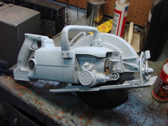

Although I've never used a worm drive saw to cut metal I'm sure they could do it with ease. I bought this one at an auction years ago for $25. and all I did was put a new cord on it and clean the cement off of it. It was used for cutting cement so they must be tough.
What a saw!! It looks a lot more rugged than the new Skil 77's, but I'm sure it weighs a lot more too. I inherited a late 1950's vintage Skil sidewinder from my dad. Using that saw gave me quite a work out.

Yes it's a brute. If it didn't have a power cord on it I would have thought is was diesel powered.:laughing: It's heavy but it don't bounce around when your using it.
