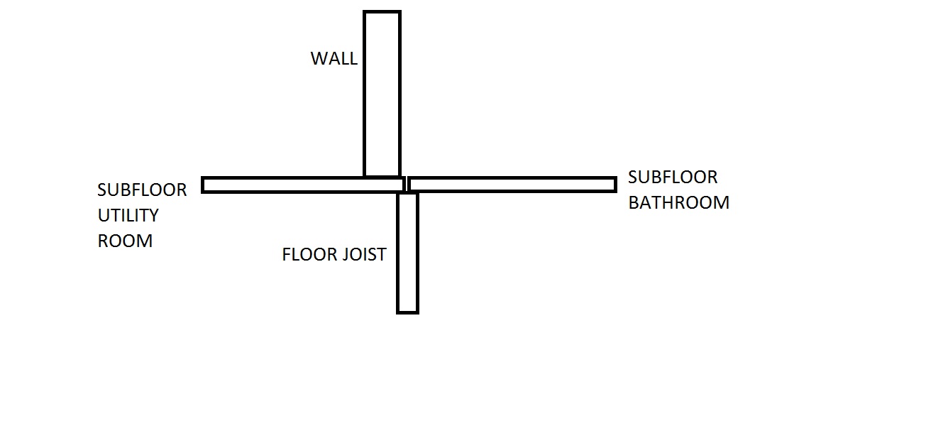

The bathroom floor is sagging and moldy all the way to the wall.The wall is non structural and is offset toward the utility room but is still over the floor joist.If I can get the old subfloor out close to the wall,I can lay the new subfloor right on top of the joist.From looking under the house,it appears the joist is still solid.If I have to,I will run stringers (?) from joist to joist to support the new subfloor.Any way it goes,that floor has to come out.It's to rotten and mold to stay in there.

Usually when a floor is sagging it is the joists...if the crowns have reversed you can sister (scab) 2x4s to the top sides of the joists using a string to remove the sag...glue and nail the scabs to the string...
...a row of bridging or solid blocking will help distribute the the load and help prevent future sagging....

Your diagram helpsbut how about a picture or two. Can you get yourself under it? Crawl space.
From the info so far about your project, I would create support for the wall, take some of the pressure off of it and then cut between the subfloor and bottom plate and between the joist snd subfloor. Ild use either a sawzall or one of the tools the other guys mentioned. That should remove the fasteners for the subfloor and you should be able to get it out.
To supprt the shared wall, you could attach a 2 x horizontally about 6' up on both sides and wedge some 7' or so braces against it to support the wall and take some pressure off the subfloor.
Then I would sister that joist on both sides if accessible from underneath, otherwise sister the bathroom side.
I woud want support under all seems of subfloor and under that shared wall.
Thats the best I can advise without actually seeing your project first hand
