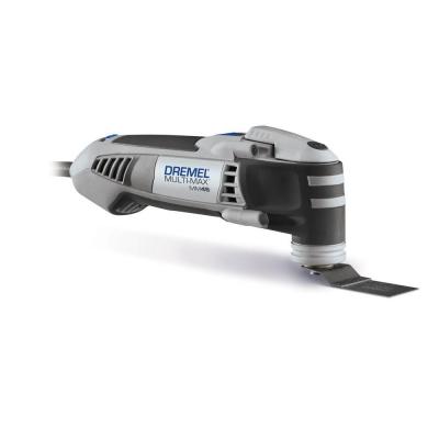

The Dremel multi-tool isn't little, this is the one that I have.
The 3 amp MM45 is sold here: Dremel 3.0-Amp Multi-Max Tool Kit-MM45-01 at The Home Depot

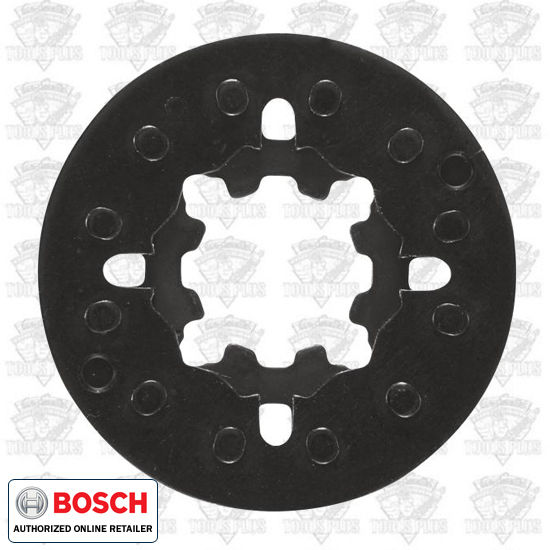

Seems like I saw an adapter to use Bosh blades on it.
Like this one.
http://www.ebay.com/itm/Bosch-OIS00...rg=20131231084308&rk=3&rkt=24&sd=271414309266
