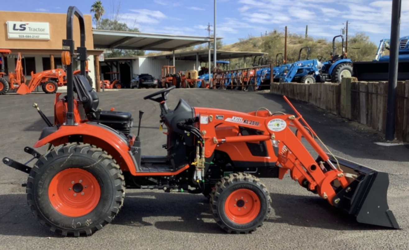

I'm about 6' and have to have my suspension seat raised all the way on my CX. As such the loader valve control arm is about 4-6" shy of where I naturally grab for it.
Does the knob just twist off, or are they a friction fit? No set screw that I could see. Gave it a good twist, but because I wasn't vice gripping the lever itself didn't want to spin something beneath the boot. I'm thinking because it's sort of rubbery I may need to pry it off. Wanna see what I can do to lengthen it.
Also somewhat related there's about 3/4" slop all around on the control. This is cable piloted. Any way to tighten this up, or better I just leave it and not risk it drifting/not return to center?

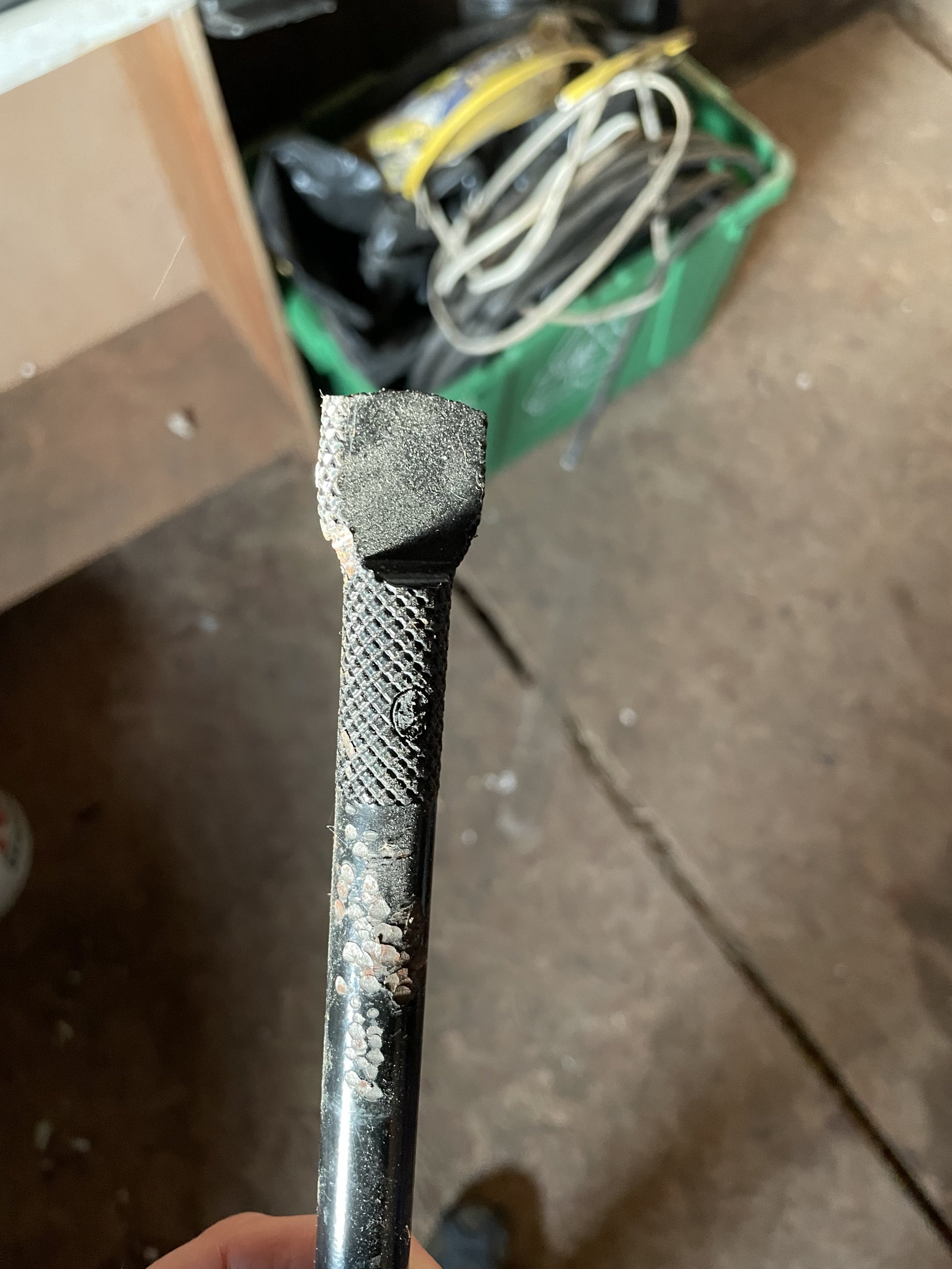

Mine was permanent. Glued on, I think. PITA to get off. Used a Dremel at first, screw that, went to my Angle Grinder and cut through it.
I don't believe it would like to be twisted off. It's pretty well-attached. Whatever they used, has it on there.
I had to remove it for my 3rd function. PITA.

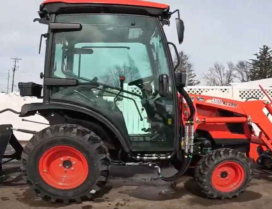

The CX cab model has a slightly different positioning, naturally to accommodate the cab, but interestingly they position the knob higher, about (mid) steering wheel height.

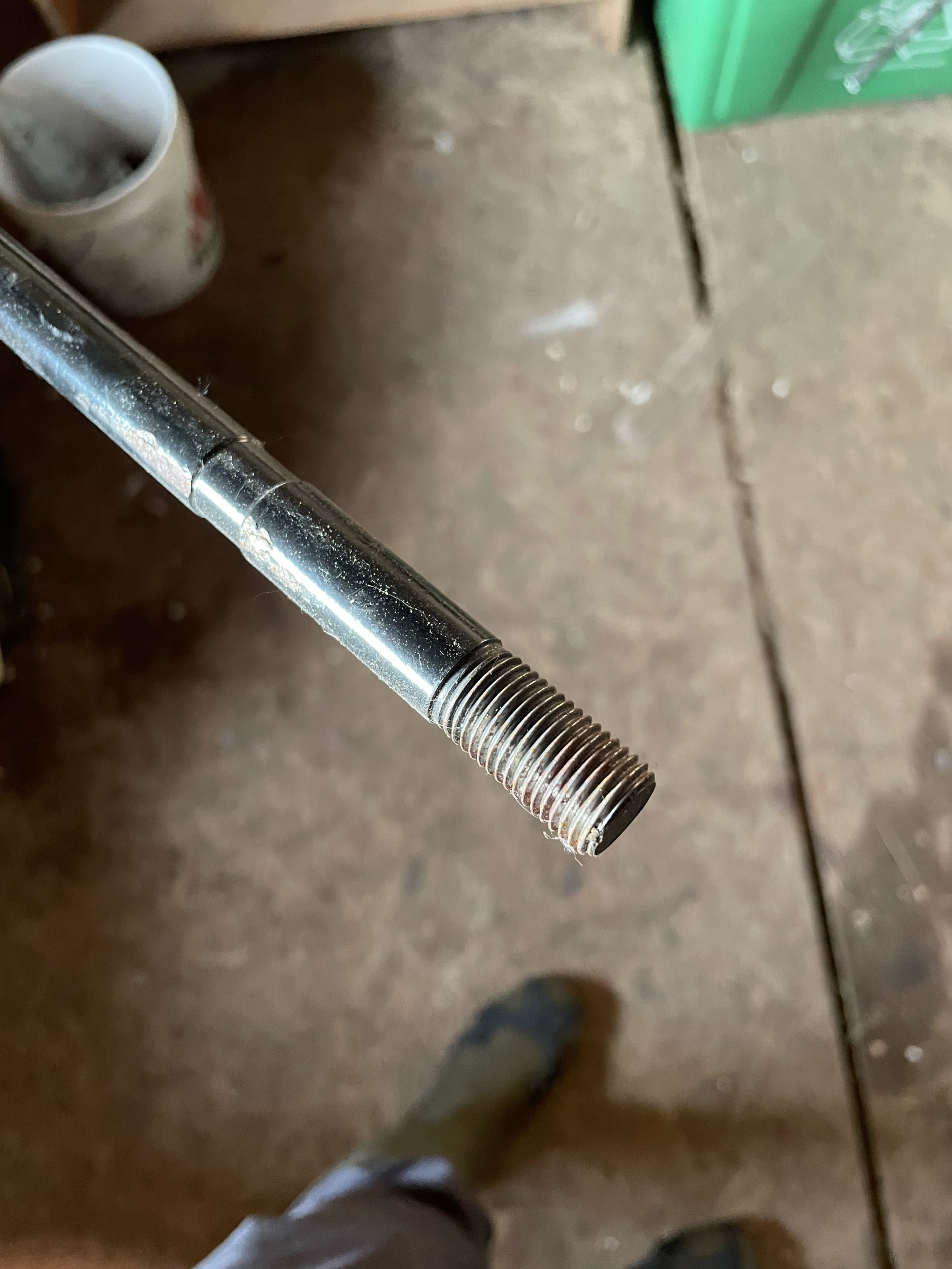

I think I might be the person you're referring to. I made a new lever for my CK2510. The knob isn't glued on if I remember. The top of the lever is gnarled and pressed flat so it spreads out wider than the diameter of the rod. The knob is just pressed on. I had a heck of a time getting it off. I just glued it onto the new lever I made. The bottom of the lever is threaded. To disassemble, you have to slide the rubber boot up the lever, take the 2 bolts holding the assembly together out, then there's a jam nut you loosen, and the rod just unthreads. I made the new lever out of 1/2 steel rod and cut some new threads, I can't remember what pitch, but I could get that info for you in you'd like. I'm only 5'7, and I made the lever a little long and angled back so that my arm is bent just short of 90 degrees when using it. I highly recommend making a new one, so much more control. I do remember 1/2 rod was a tiny bit smaller in diameter than the original, so the threads are a little shallow, but I've used it for over 200 hours and have never had an issue.

I did see exactly what I needed to do to extend. In fact I've looked at some shift knob extensions that could be a drop-in upgrade. I believe it was an M14x1.5? Somewhere in that neighborhood.

M14x1.5 sounds about right with the threads. I'll check next time I'm out in the barn. It will be really enjoyable using the loader once you have it the length you need. I don't understand why they have such a short lever from the factory.

As you may have noticed, the cab model has it substantially higher. Perhaps lessons learned. Anyway at this point I just need to quit complaining/shut up and make a new one. :)

You are right about the threads being M14x1.5. My lever is 21" long to the top if you measure from the plastic below the rubber boot.
