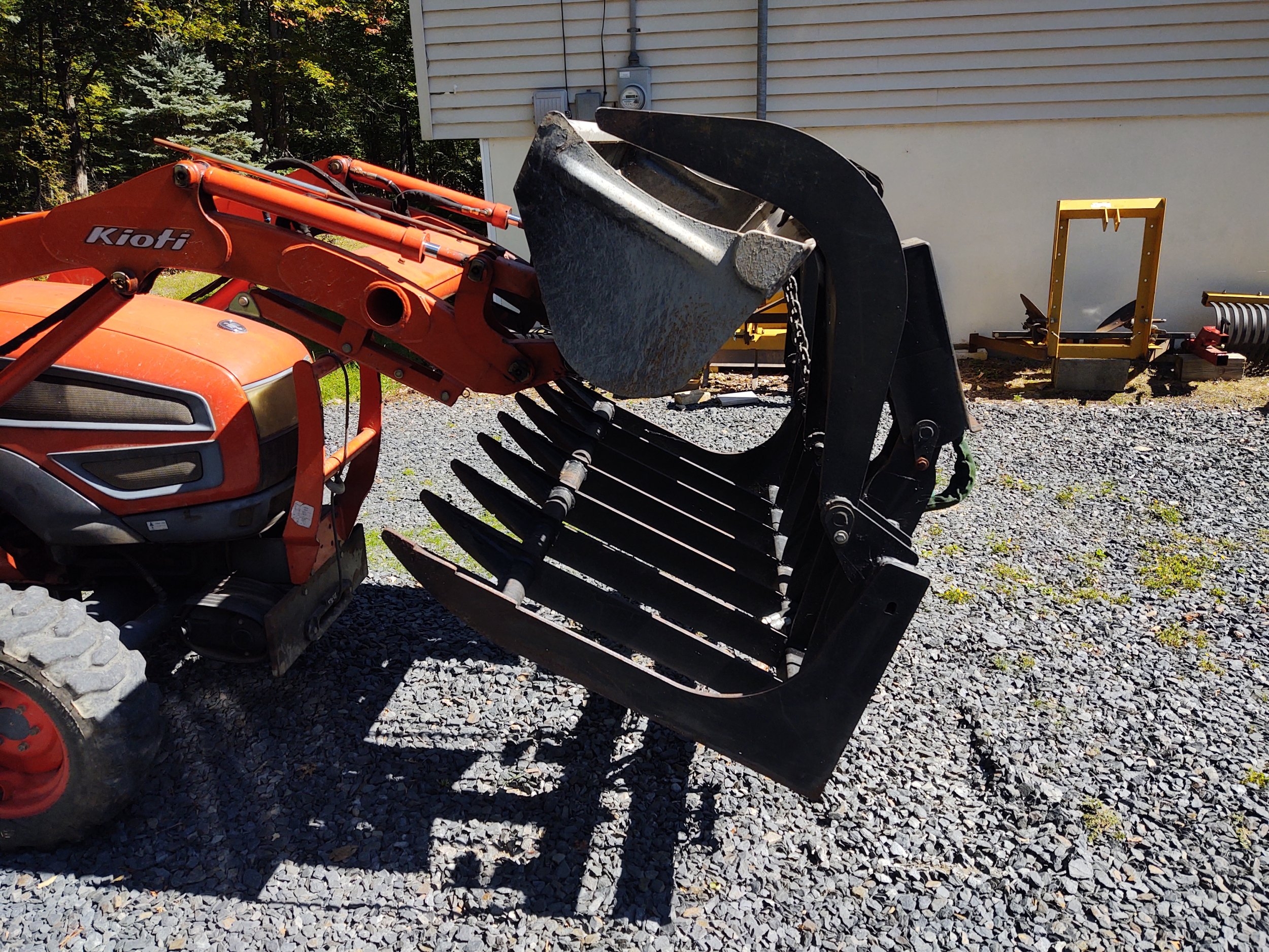

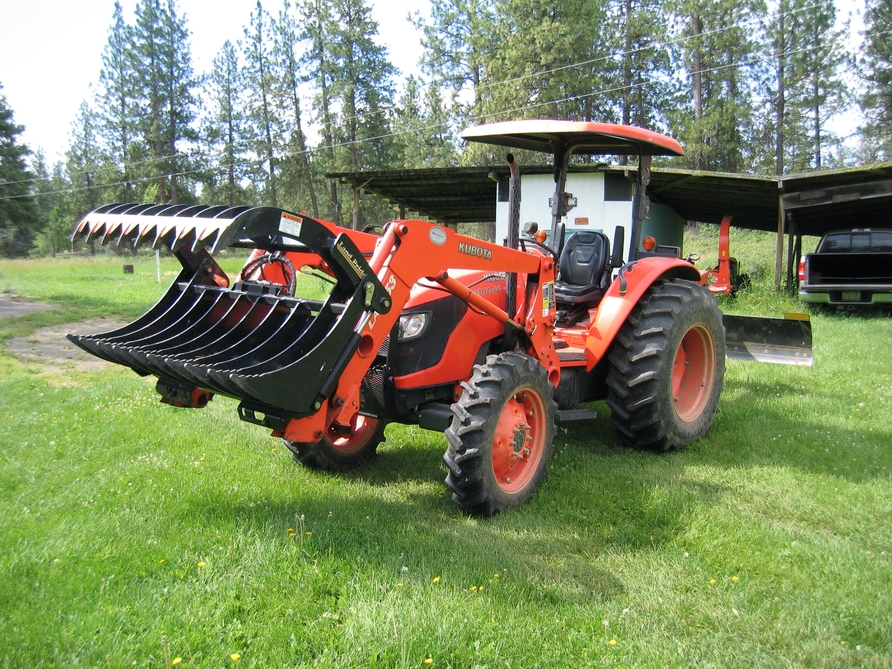

I've been using this 60" for 15 years, and every time I feel like I'm abusing the loader with the weight. CK25. Pin on pita. Changing to bolt on bucket grapple, and bolt on teeth.
That does look like a pretty heavy unit. I'm looking at a short bottom tine design that closes tight for the kind of stuff I want to do most. It also keeps the weight down for my baby tractor. 😉
