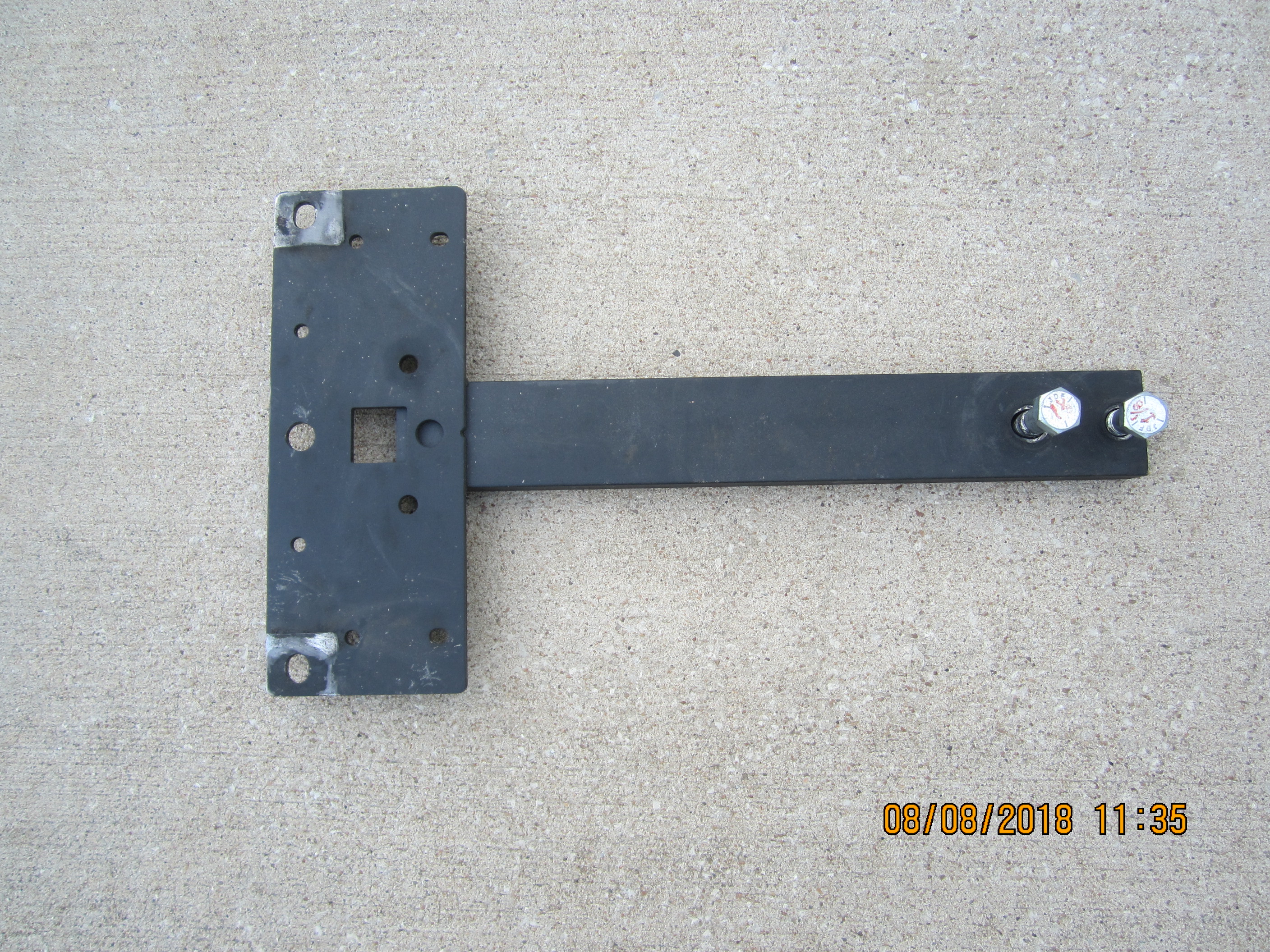

Here's that pic that you asked for JackyJ. As far as I know, Woodland knows of the various dimensions/hookups for various tractor models. This the pic of the one they sent for my B2620. 003.JPG. It hooks up to the tow bar.
/ Cyclone Rake Questions #8

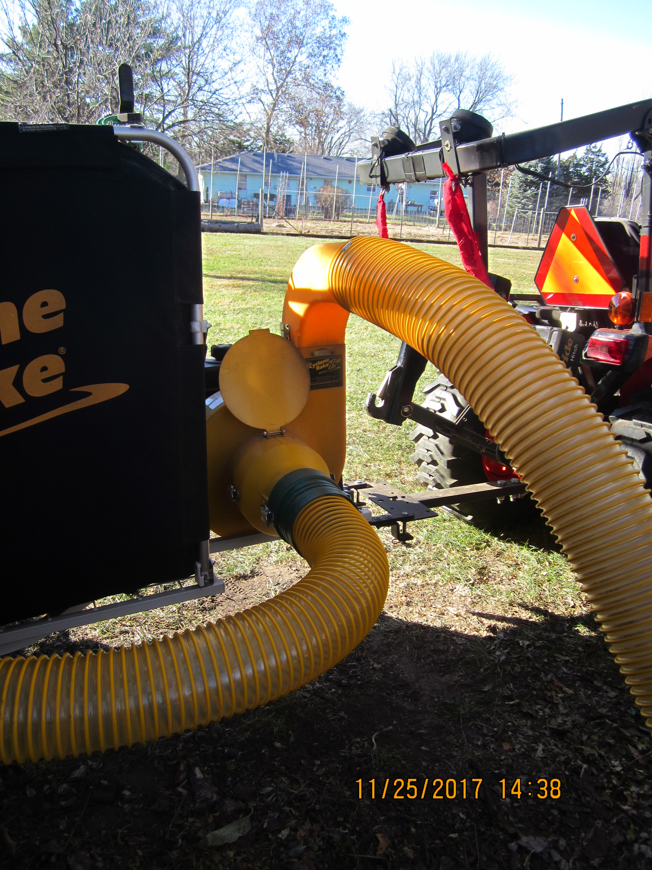

004.JPG003.JPGHere's some additional pics of the hook up on my rig.
Cheers,
Mike

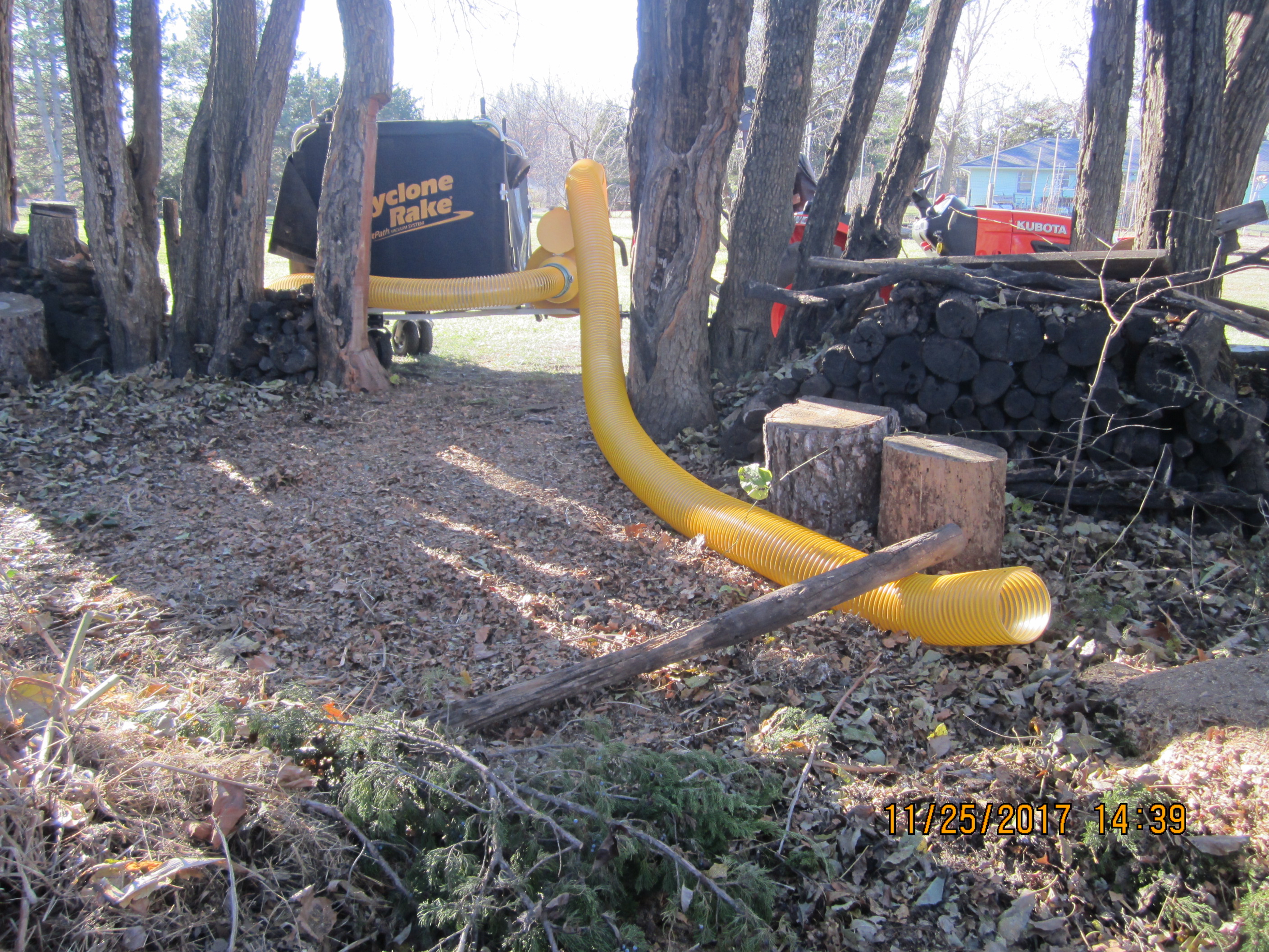

As 4570man says it will be heavy to dump; BUT you can vacuum the trailer out and use the vacuum to act like a silage blower to discharge the clippings and leaves and blow them to where you want to pile everything. if you have the five paddle blower and the longer hoses.
/ Cyclone Rake Questions #11
Once I'm at my dump area, I don't have a problem with raking some out to make lifting easier......and....I'm only 5'2" and 145 lbs and 85 years old. I guess after all the other raking options I've tried over the years, this seems negligible.
As leonz notes, one can vacuum the trailer with the appropriate hoses (more expense) to shoot it over the wall, hedge, etc.

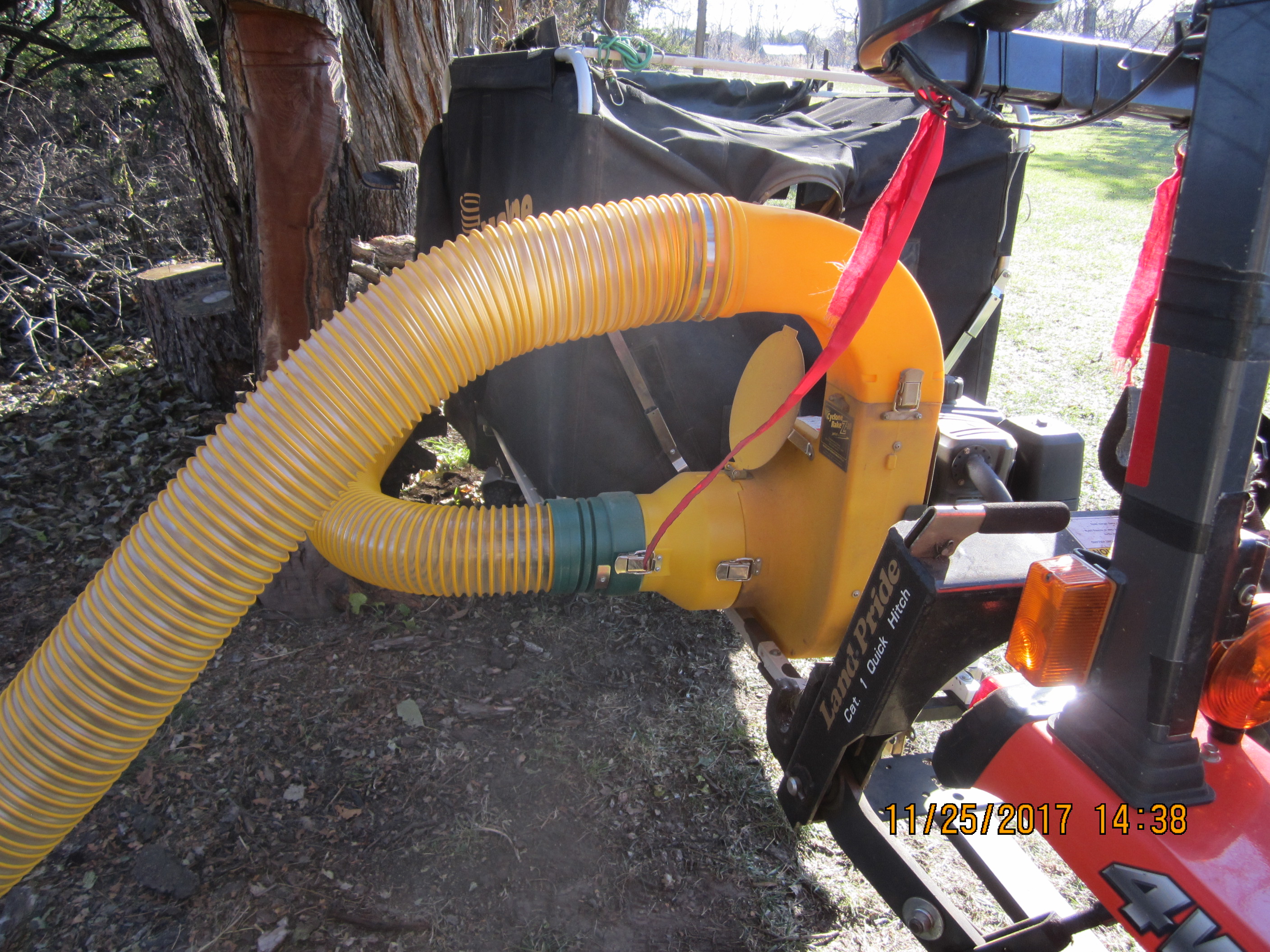

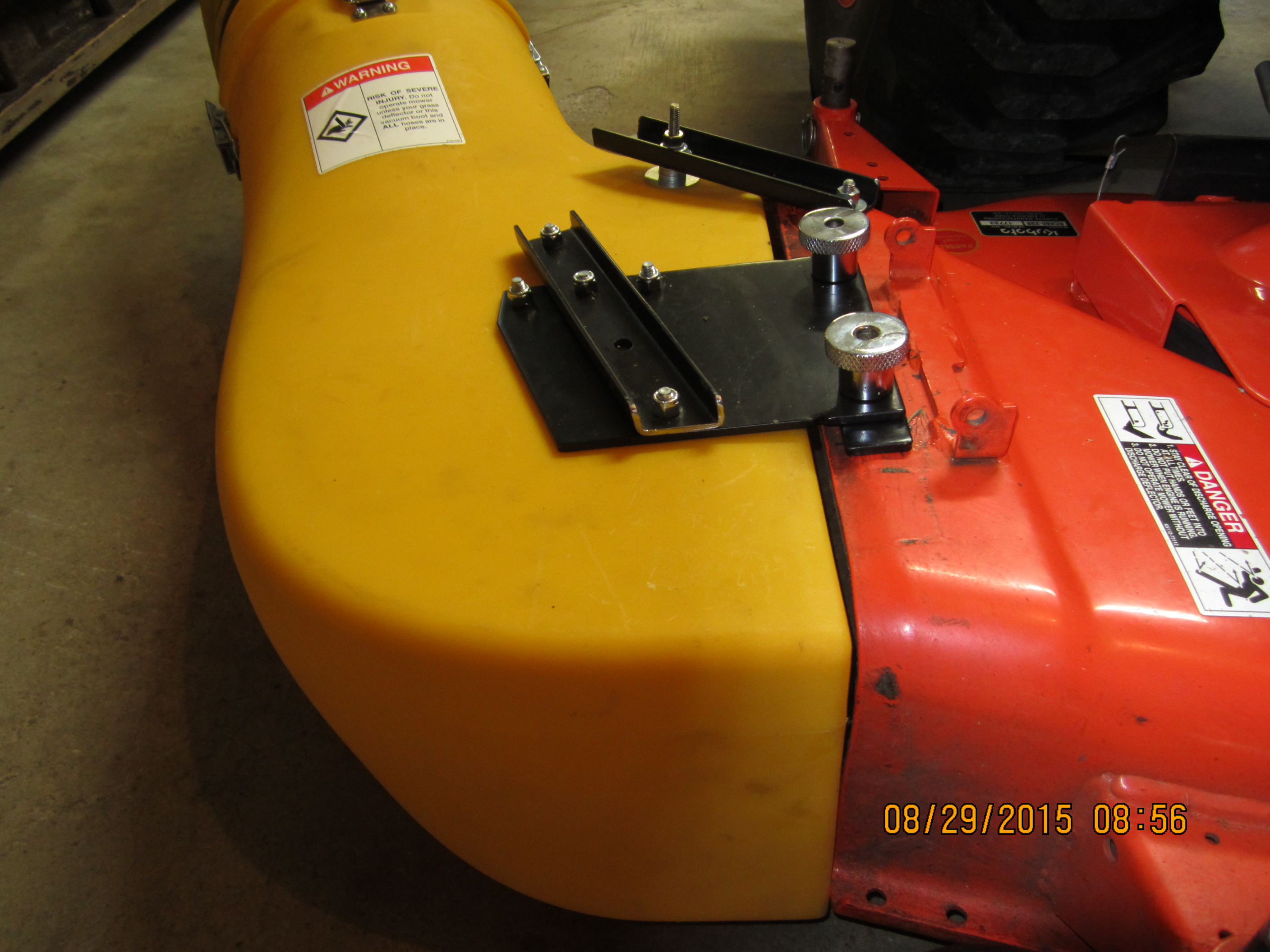

I din't know that Kubota made a deck adapter. I had to modify the CR boot that they provided to get it to my satisfaction. Here's some pics of that and also.........................................................note that...................getting rid of all those leaves can be troublesome. I distribute mine all over the garden and plow/till them in. Sometimes I eject them into a hedge row.....007.JPG004.JPG005.JPG so..........some more pics.006.JPG
Cheers,
Mike
P.S. That's a nice set up KennyG......because you do not have to bolt on/off the CR hitch....just go with what you built is easier and probably functions just as well.

I also use the Kubota deck boot - of course it costs a bit more but it fits my deck perfect. I then used an adapter to get the bigger cyclone rake hose to fit the Kubota deck adapter. I have had it clog 1 time in about 3 year and that is because I had a 10" stick make it part way down the shoot and get stuck and then the wet grass got built up on it.
