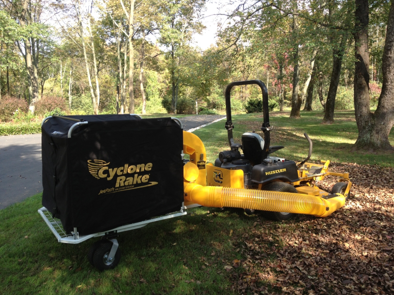

I am going into my fourth season with the XL behind a 60" ZTR:
We have lots of leaves and decent hills. I cannot imagine cleaning up without it. As is I spend six 8 hour days each season and end up with a huge pile of shredded leaves that becomes the basis for our compost.
Our lawn looks great and the product works great. A few notes:
- takes getting used to the swing driving as the hitch is a fixed 2 point hitch, on my mower this makes the drive wheels true pivots with casters at the front and under the collector, not sure how this will feel on a tractor
- even half full it is like driving a bus around the yard, get the dual wheels
- hills should only be taken up and down, not cross, I still get front wheels off the ground if not careful
- the gas tank lid has a filtered vent that clogged last year, had to special order a new one as it was not serviceable and was expensive (maybe $30)
Bottom line is I cannot speak highly enough of this product for my application and recommend if you can fit it around your property obstacles and have leaves it is a huge timesaver.
