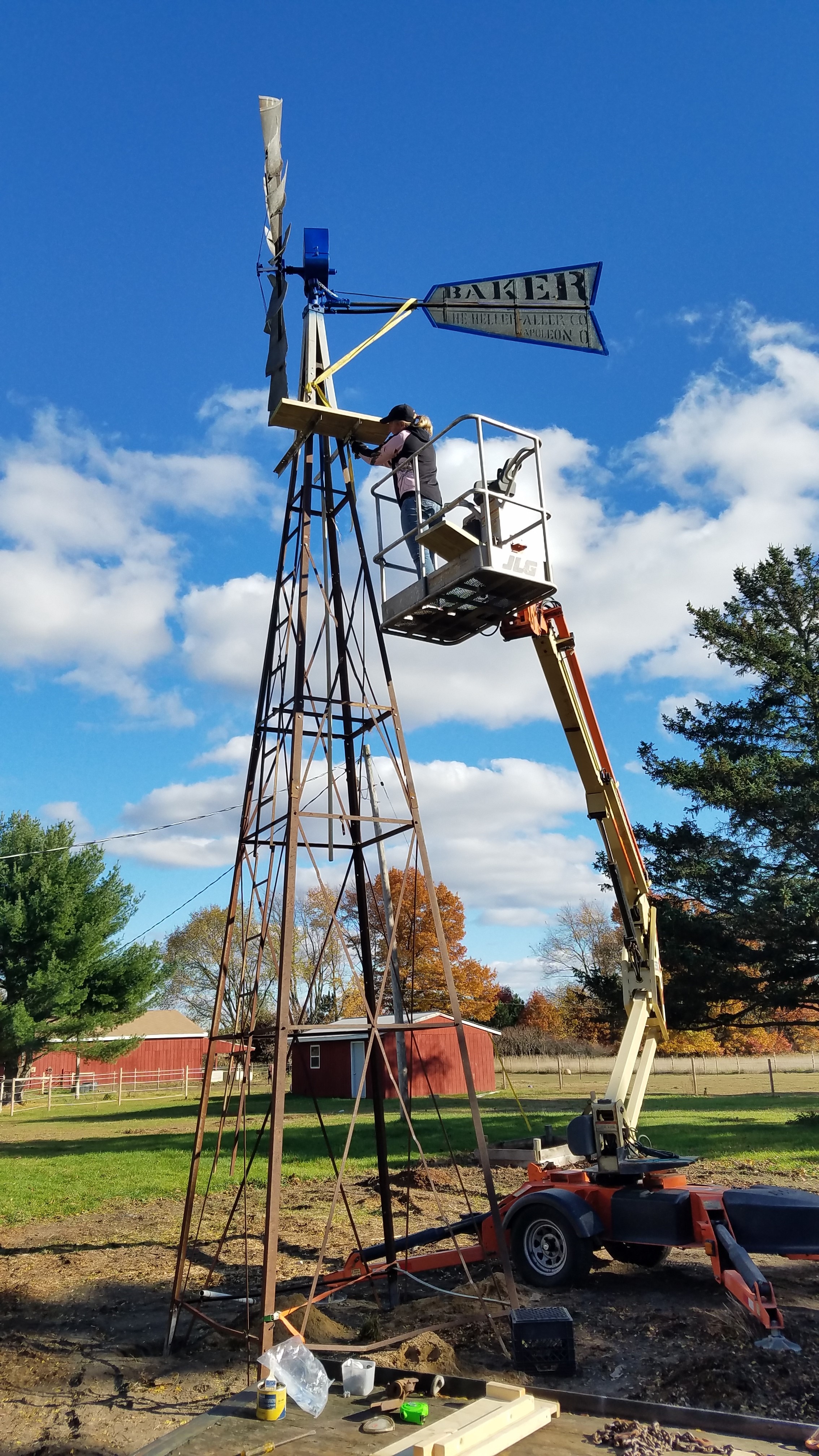

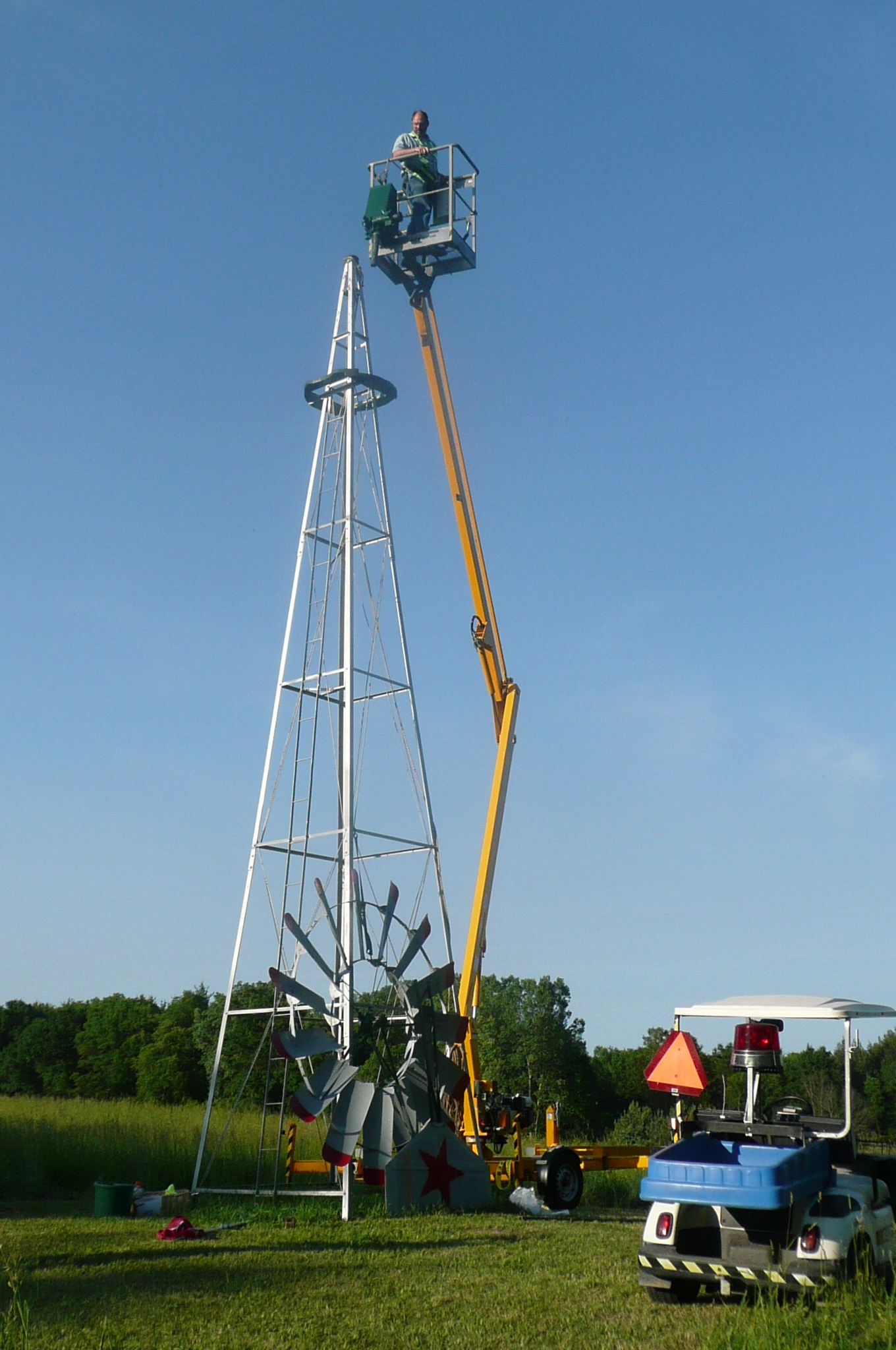

Couple of thoughts: 1). when your platform is low, it has to be tipped forward in order to be level when it's raised to working height, unless you have a mechanically self leveling bucket. 2).There are also self-leveling control valves which try to maintain the platform horizontal position for short periods of time. 3). Another though is the use of a platform mounted remote height & level control station added to your post mounted control valves. More hoses, more chance for leaks, more risk. Don't bump into it while working the job or you'll be bailed out.
Why not just buy a lift specifically designed to meet your needs? I did, and found there are a LOT more uses of a boom lift and those needs involve heights much higher than loader reach. Mine is self leveling, has load sensing pads that prevent you from over-reaching your desired position in case it gets tippy. Rent one and try it out.
BTW: Unless you have rock hard tires, your platform is going to quite bouncy, something hard to get used to at first, plus with 500 lbs on it, the bounce frequency might make you 'seasick' and that's no joke. BTW: This gal had no trouble wrenching a windmill head at 30' height.
