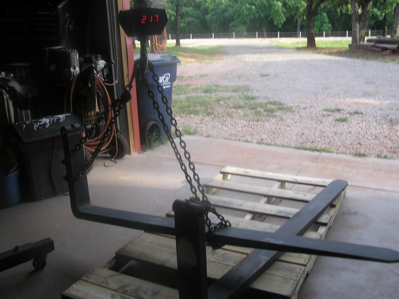

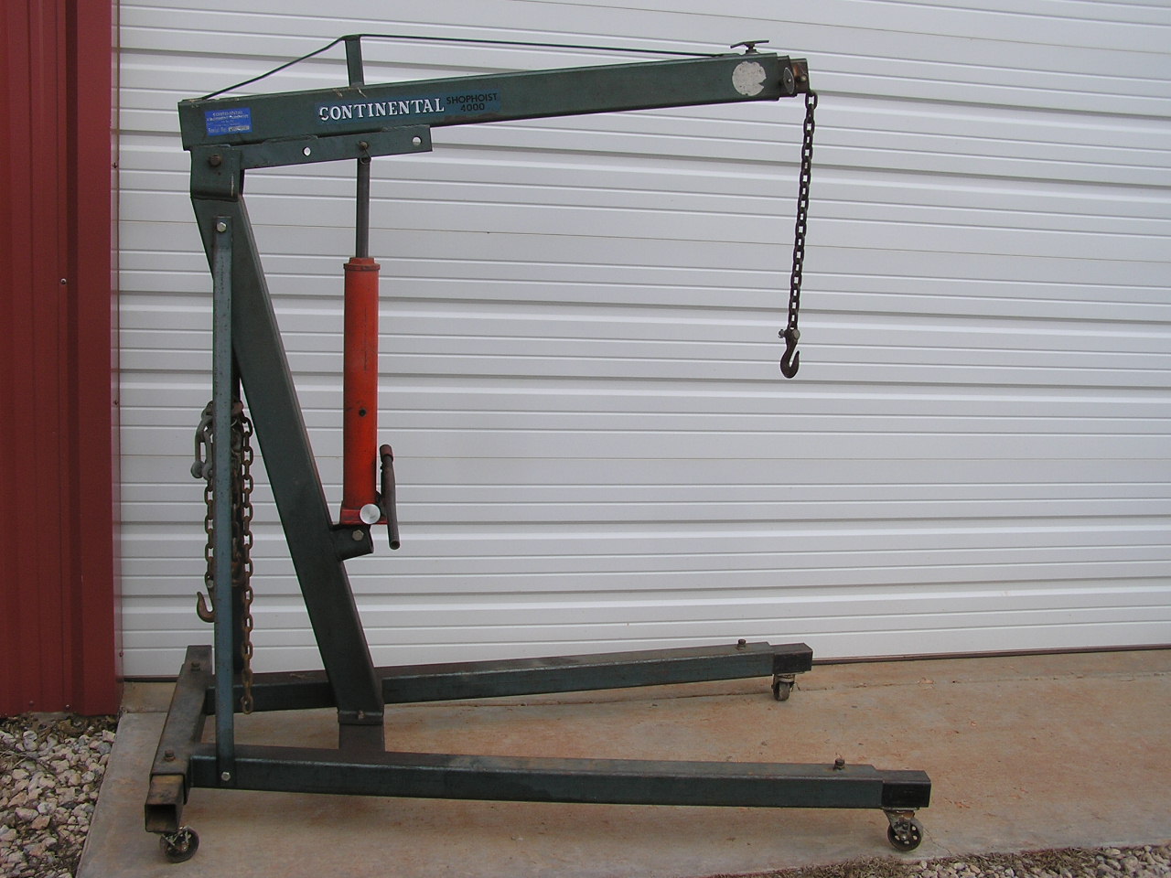

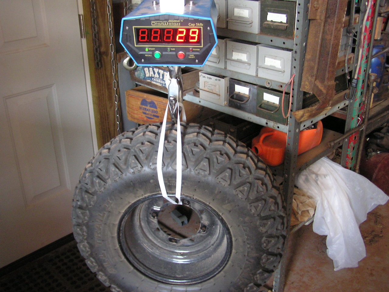

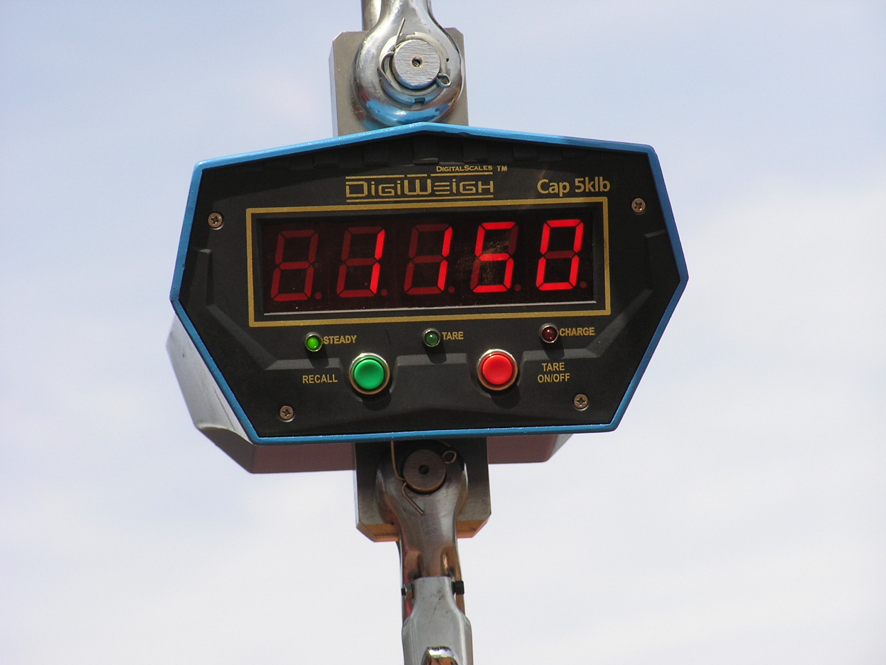

A crane scale is what I have, got it on eBay for about $300.
Also hang it from the shop crane.
/ Cylinder weight scale #9
That's a very nice setup. I looked for a year or 2 on eBay, and did not want to pay that much.
