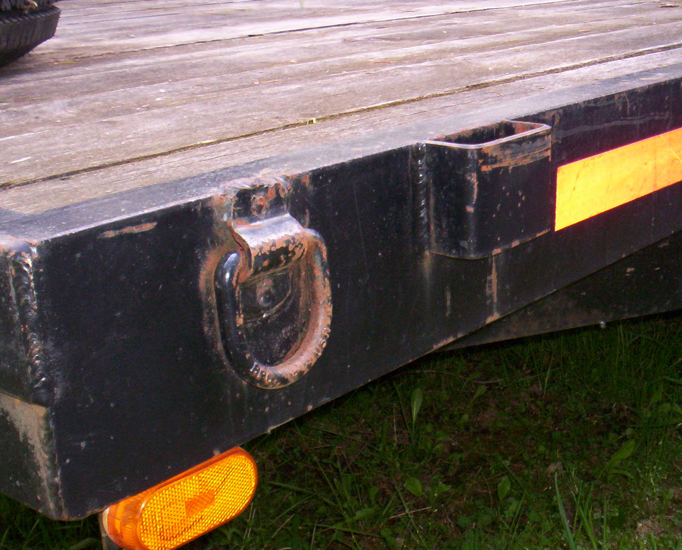

Those welds looked scary weak. What good is a 12000lb D-ring with a 1200 lb weld?

Is a perfect example of what i ment when i was comparing the relative holding strength of the D rings to stake pockets by comparing shear number of inches of weld on each.
not to mention relative strength in off axis pulls
My D-rings have a hefty bent strap a couple inches on each side fully welded to the plate that is fully welded to the frame. No pic handy, sorry. There are many ranges of quality and sturdiness of these...

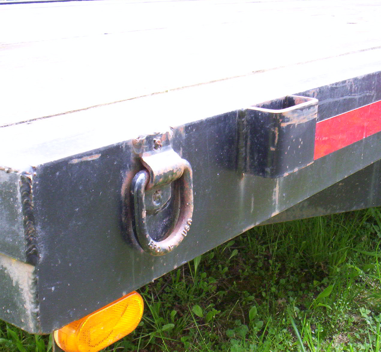

Here's what the d's and pockets look like on mine. It's a 12k trailer
   / D rings/stake pockets #24
See ive seen both designs.... ones with a simple little U that covers the D ring that is required to be welded
and others (like yours) with a strap that you can bolt down (mechanical fastners said to be more dependable than welds)
