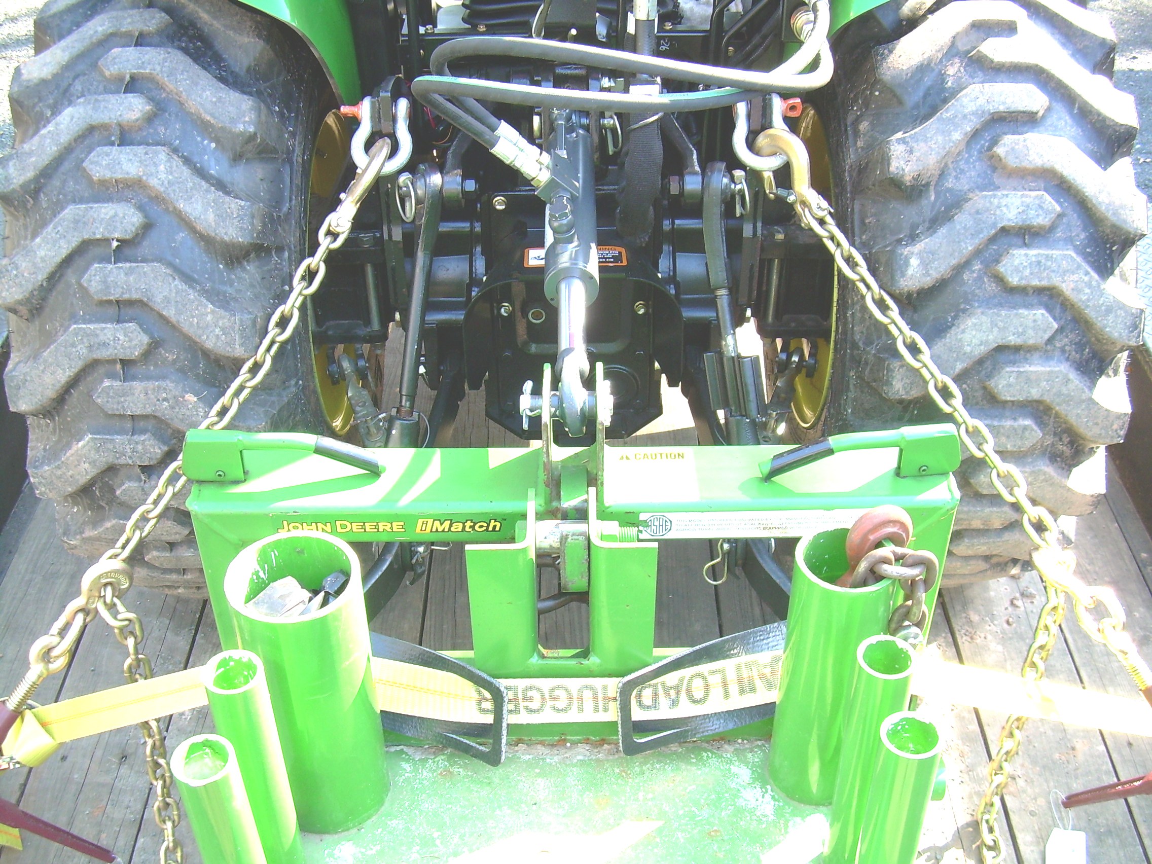

Mine has D-rings in the corners (welded to a corner plate that is welded to the frame, so they are very sturdy), but because my trailer is a bit short for the tractor, two of them get hidden by the bucket, so I ony use the two at the back of the tractor and 2 stake pockets at the front of it.

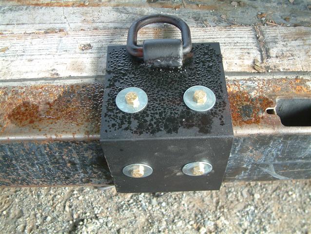

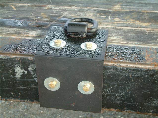

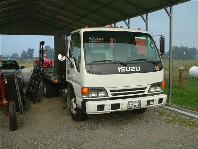

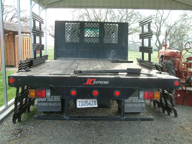

My tractor hauler is a 2004 Isuzu NPR stakebed (8'x14') to which I added a set of four 12,000 lb rated D-rings. I plan to use the stake pockets for the removable sides--hence the D-rings which are welded to 1/2" thick steel angle which in turn are bolted to the stakebed frame via four 1/2" dia grade 8 bolts per D-ring.

I have a chain hook with the spring-loaded keeper latch on it that prevents it from falling off too easily. I just hook that onto the D ring and it stays there.
   / D rings/stake pockets #19

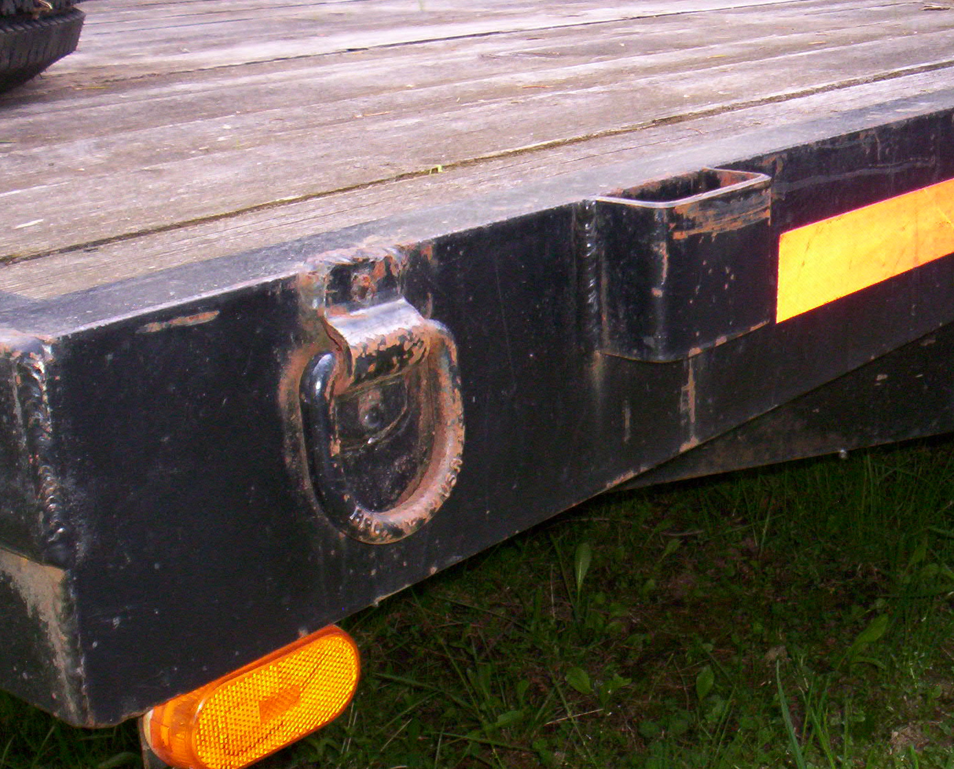

Slip hooks? that's what I do with the clevis shackles on the back of my tractor. I set up many of my chains like that, a grab hook on one end and a slip hook on the other.
JB.
   / D rings/stake pockets #20
Is a perfect example of what i ment when i was comparing the relative holding strength of the D rings to stake pockets by comparing shear number of inches of weld on each.
not to mention relative strength in off axis pulls
