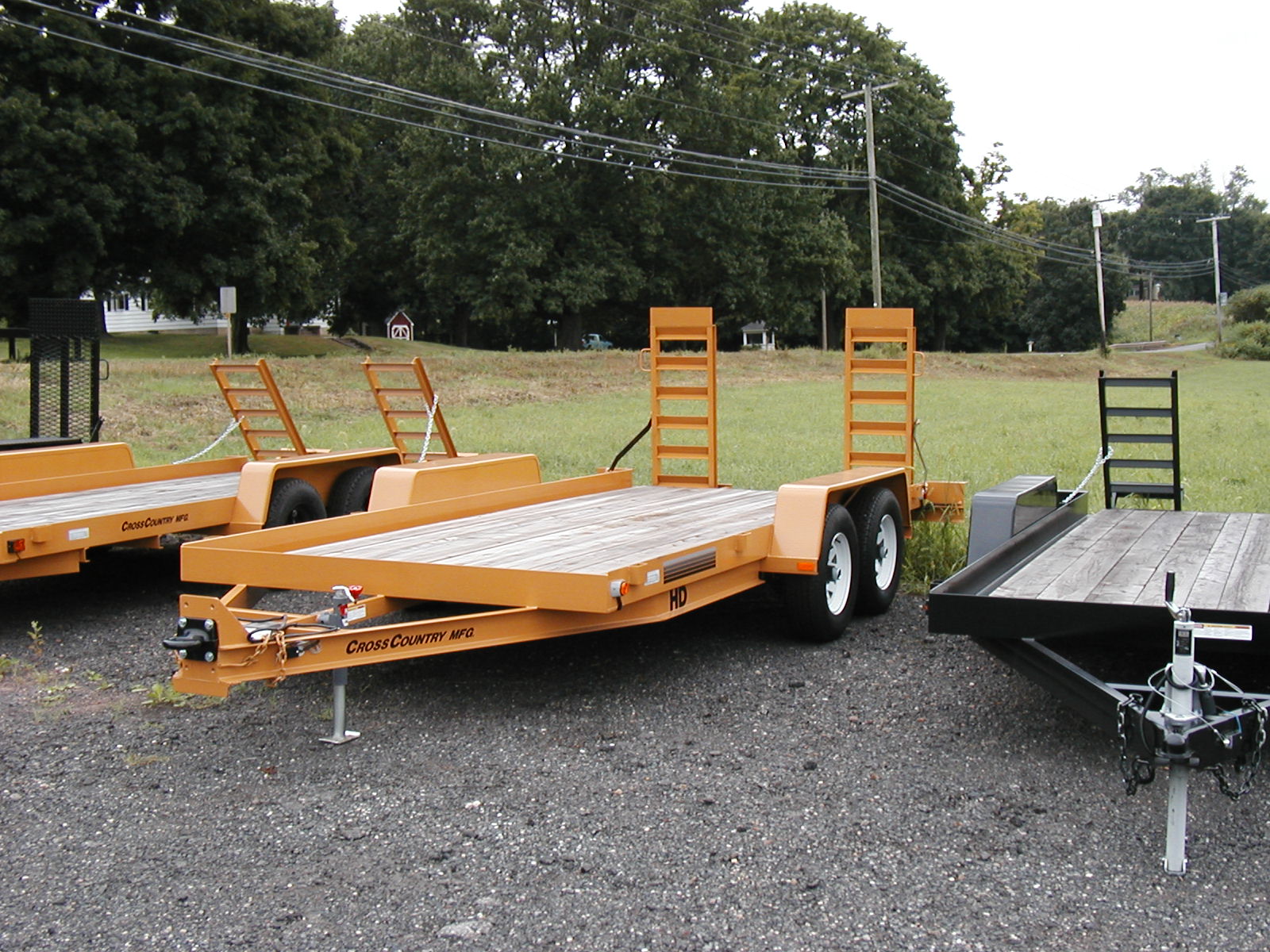

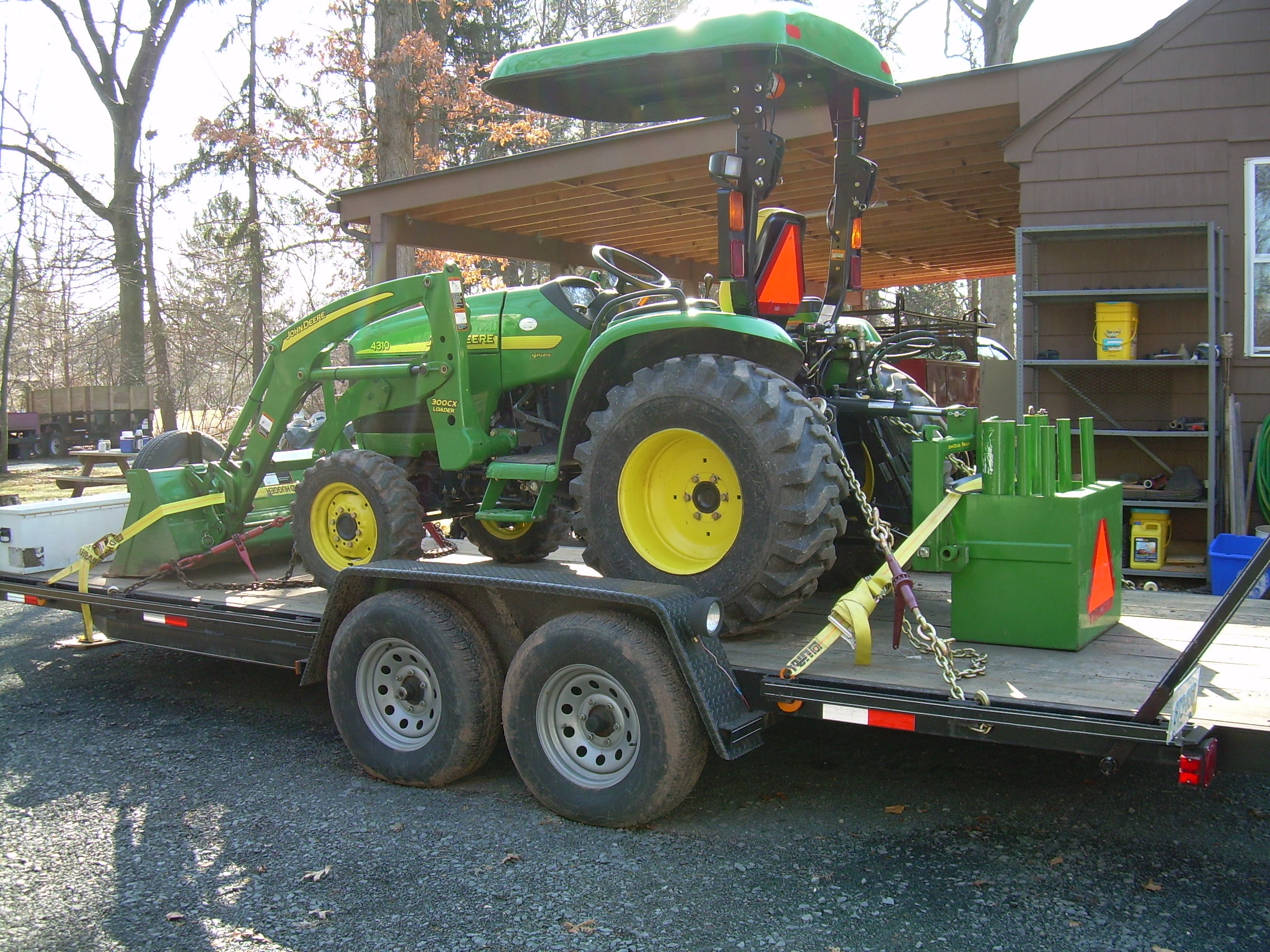

Here's a pic of a brand new trailer, no D-rings, just stake pockets. And a pic of my set up.

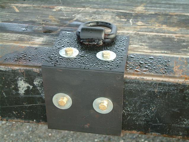

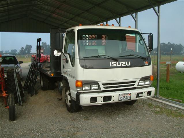

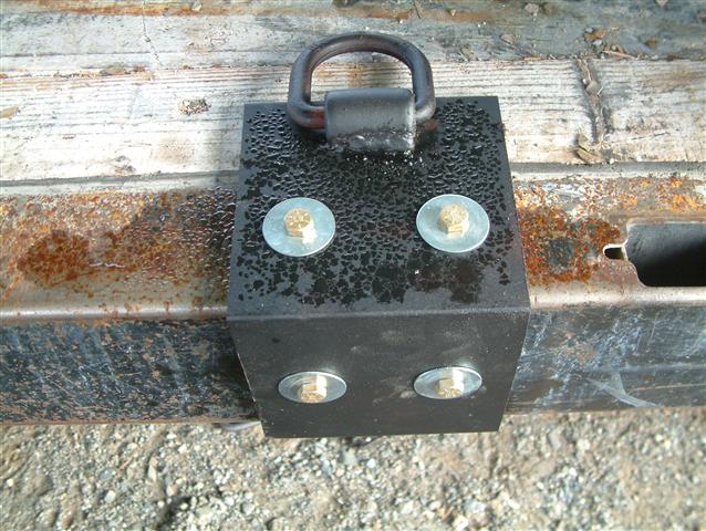

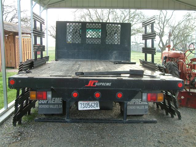

My tractor hauler is a 2004 Isuzu NPR stakebed (8'x14') to which I added a set of four 12,000 lb rated D-rings. I plan to use the stake pockets for the removable sides--hence the D-rings which are welded to 1/2" thick steel angle which in turn are bolted to the stakebed frame via four 1/2" dia grade 8 bolts per D-ring.
DSCF0086 (Small).JPGDSCF0088 (Small).JPGDSCF0085 (Small).JPGDSCF0087 (Small).JPG

I bought a trailer similar to JB4310's last summer. I ordered my Bri-Mar trailer without D-rings, because I wanted the deck to be flat without obstructions.
I had them put five additional stake pockets on each side so that there would be tie-down points in the right place, regardless of what I was hauling. The rub rail helps spread the load to some extent to the neighboring stake pockets. I also had three stake pockets welded along the front of the deck for tie-downs. Lastly, I added two D-rings to the topside of the tongue right behind the hitch coupler.

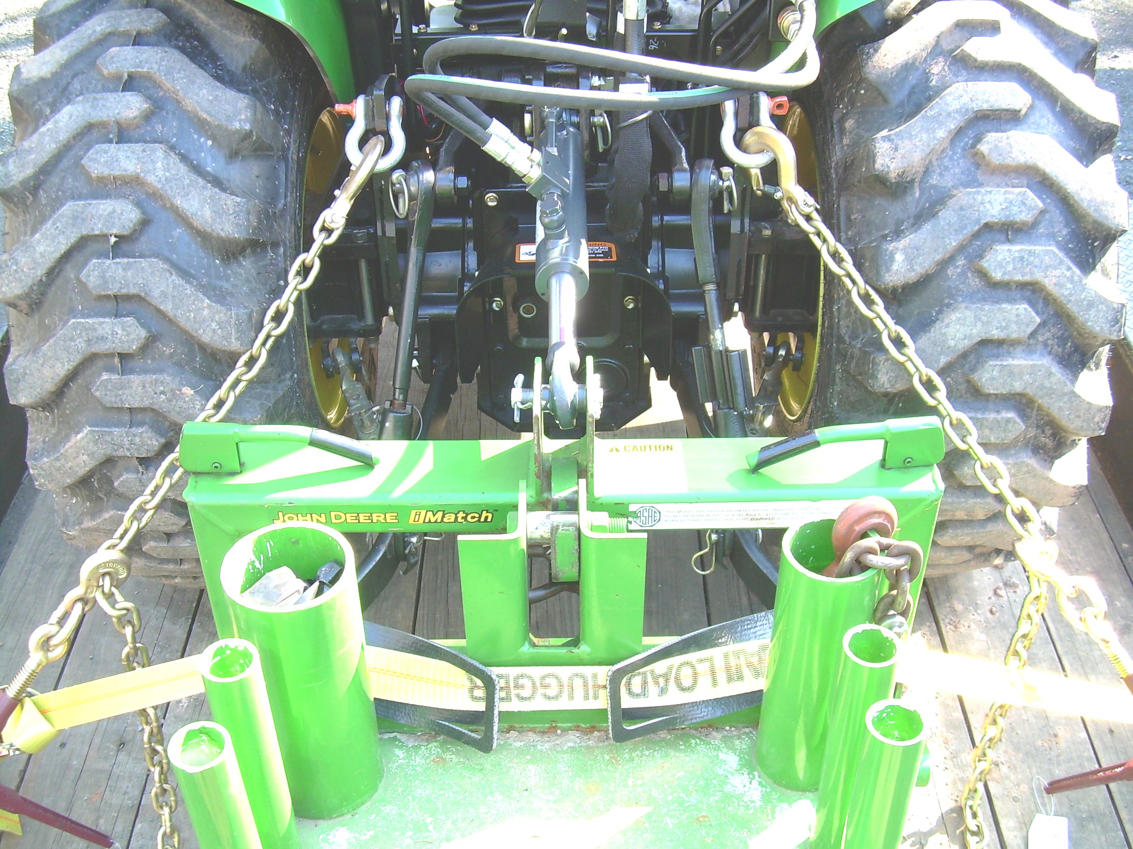

So for those who use D-rings exclusively, how do you attach chain?
With chain thru it and use grab link, or with a slip hook.
JB.
/ D rings/stake pockets #17
Chain through the D ring, bring the hook around and put it on a link. Same on the other end and use a ratchet binder to take up slack.
/ D rings/stake pockets #18
I have a chain hook with the spring-loaded keeper latch on it that prevents it from falling off too easily. I just hook that onto the D ring and it stays there.
/ D rings/stake pockets #19
Slip hooks? that's what I do with the clevis shackles on the back of my tractor. I set up many of my chains like that, a grab hook on one end and a slip hook on the other.
