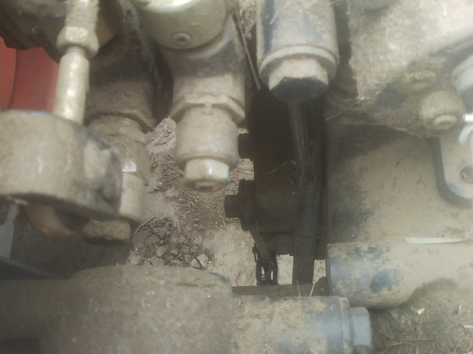

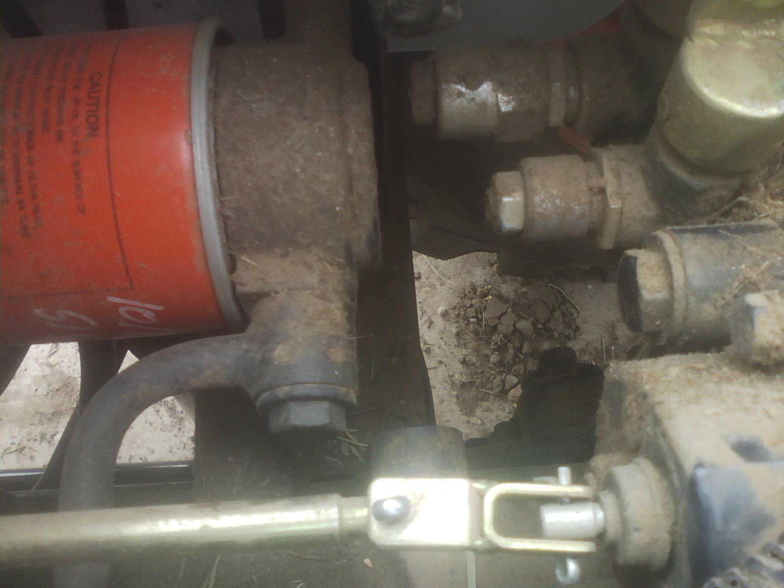

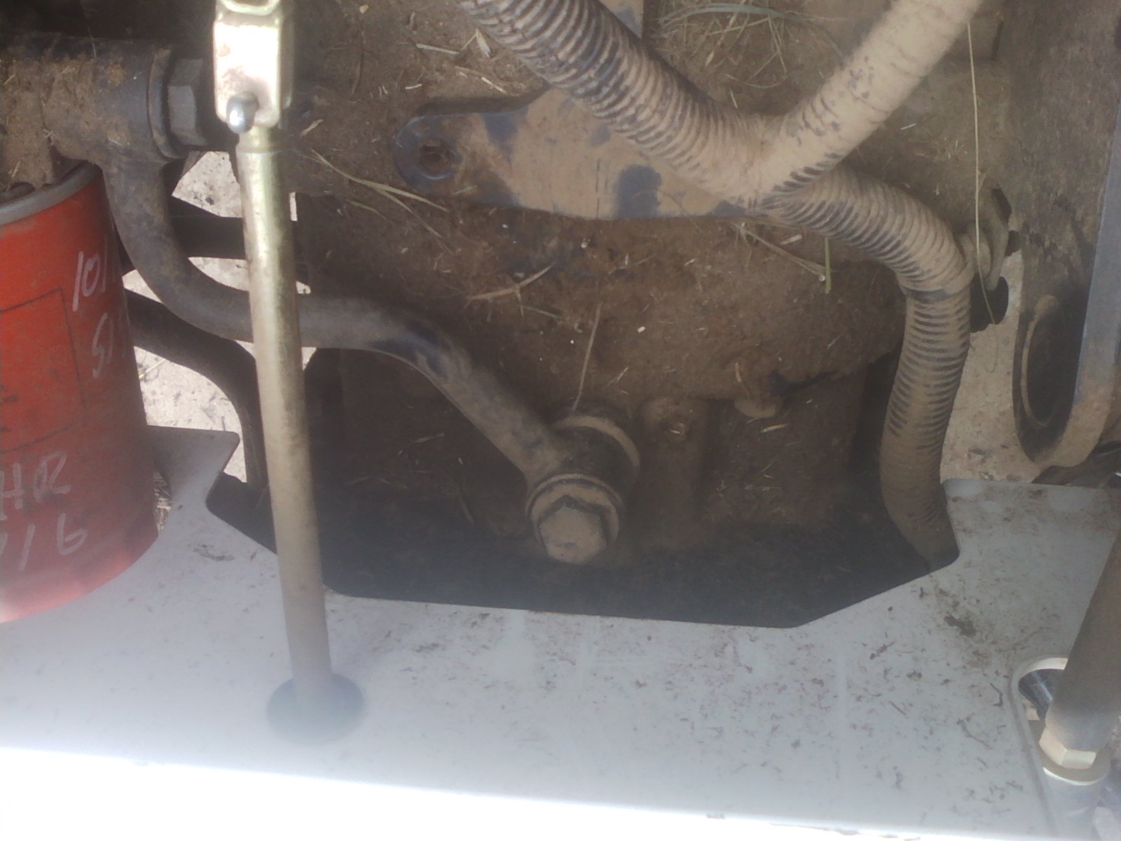

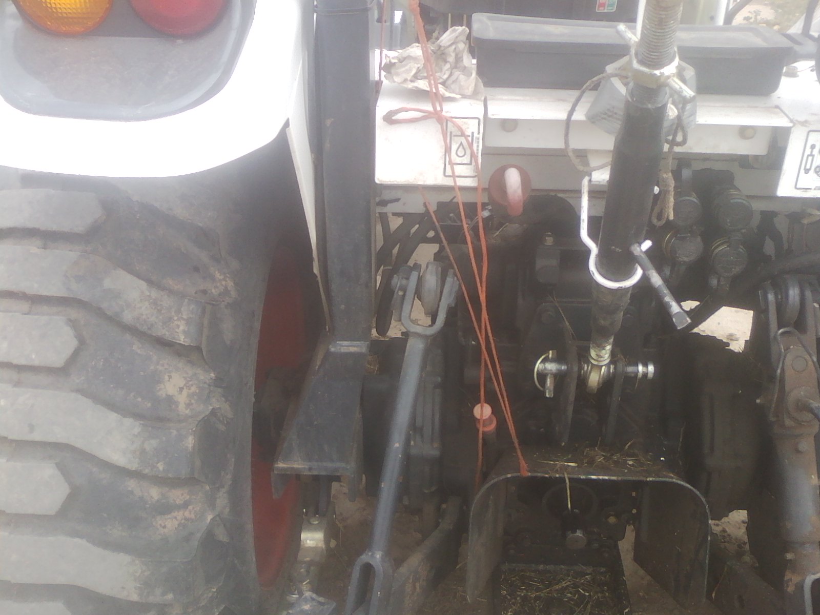

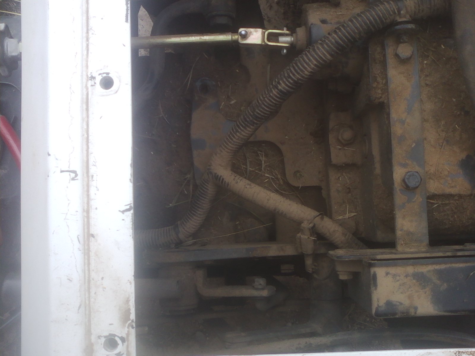

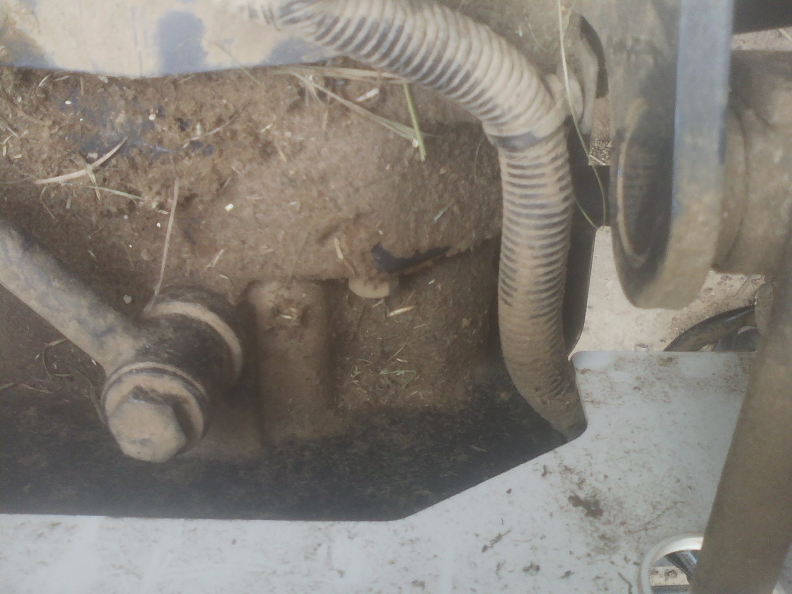

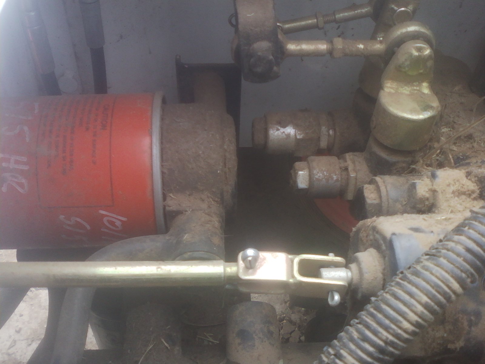

Well it is a good thing I mocked up the valve body "IT WONT FIT"
So I took a few pictures of what I found after pulling the seat. I even tried a smaller valve on the D03 subplate - still no go from what I am seeing. It appears Bobcat had a better idea on the plumbing - NOT!!!!!! So there is a difference between the Kioti and Bobcat on wiring and pluming.
1019171318.jpg Oil filter in the way of where jabelding mounted his.
1019171318a.jpg Wiring harness is in the way. I can possible move this, but there appear to be a clearance problem in the new location, rubbing on the PTO linkage lever.
1019171319.jpg return to tank plumbing is in front of mounting area that ND2Fire used, I can possibly get above this, but it will be tight.
1019171319a.jpg The port to the 3pt and rear remotes is in a tighter location with the filter being there, rear remotes will make hose running problematic.
1019171319b.jpg Picture of the return to tank fitting in front of mounting area. The top of the bolt is approximately 3/4" above mounting plate area used by ND2Fire
1019171321.jpg So I checked the area where the WR Long kit goes. They mount to the left of the trans fill tube back and above the lift arms. Assuming a typical valve and D03 plate it might fit, but hose running and the 3pt arms have me very concerned with protection.
1019171321a.jpg Close up of the existing fitting to the 3 pt and rear remotes. Would be very tight to get hoses and fittings in there to the D03 valve body which would mount to the Rt.
1019171321b.jpg The filter housing and the 3pt port fitting is very close. I might have 1/2 inch to work with after changing out the 3pt fitting and bring the line for the loader valve in.

The valve that jabelding used is the smallest I've seen. If that helps any.
I think (but I'm not positive) that it is a spring centered valve which should allow for vertical operation. Not all allow that.
   / D03 or D05 subplate and valve - Murphy proofing my 3rd function
#20
My neighbor dropped in as he saw me struggling to get the seat back in place. We chatted at what I was trying to do and I think he solved my problem. With a thicker mounting plate (or one spaced up a bit) I can get above the bolt on the return to tank fitting. This gives me enough length to use the valve jabelding used, as I do have the vertical room. He then suggested I look at the fittings dimensions. He discovered I had used the D05 base plates dimensions verses the D03 size which gives me more room. So there is hope yet. Its good to get a second set of eyes and hands getting the seat back in and yes I had it in two pieces. He also figured out a hose routing I had not thought about. More to think about. So there is light at the end of the tunnel - I just hope it is not the train :shocked:
