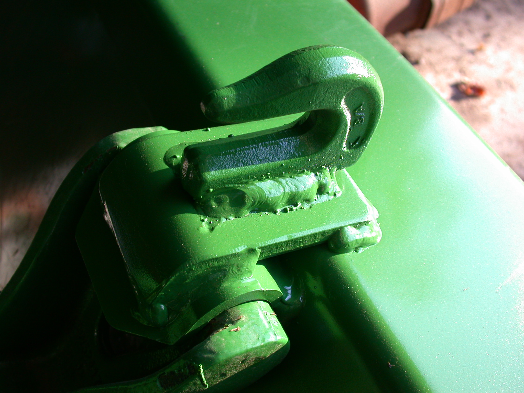

DF,
Here's a cast hook I mounted to my 300CX (steel) bucket. I've also welded teeth to my BH and repaired cast arms for bailers.(Millermatic 210)
Rob

Rob,
I would doubt that the hook is cast.... most are forged.
   / ##Damaged my 3320 today, advice please PICS## #69
All the hooks I buy are forged, and they usually say so on each one.
Rob's hook definitely looks cast, however. It has the grinding marks
along what seems to be the mold parting line.
   / ##Damaged my 3320 today, advice please PICS## #70
Forged parts can and often do have what looks like a mold parting line. The extra metal that is squeezed out between the dies in the forging process is often trimmed and/or ground off and looks like a mold parting line.
