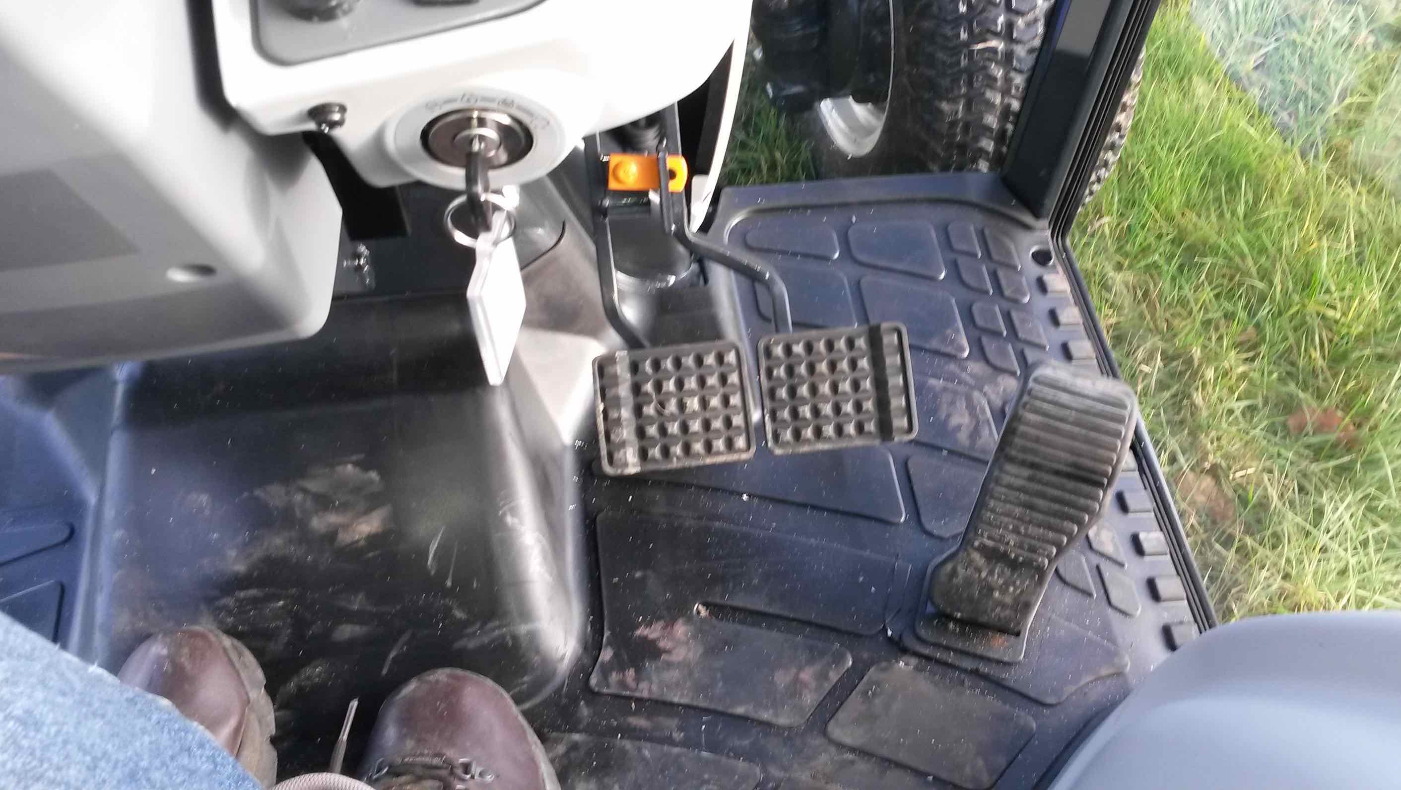

Instead of two individual forward/reverse foot pedals, or a bi-directional treadle pedal, there is just one simple pedal. This single pedal has no effect on direction, it simply controls HST speed.

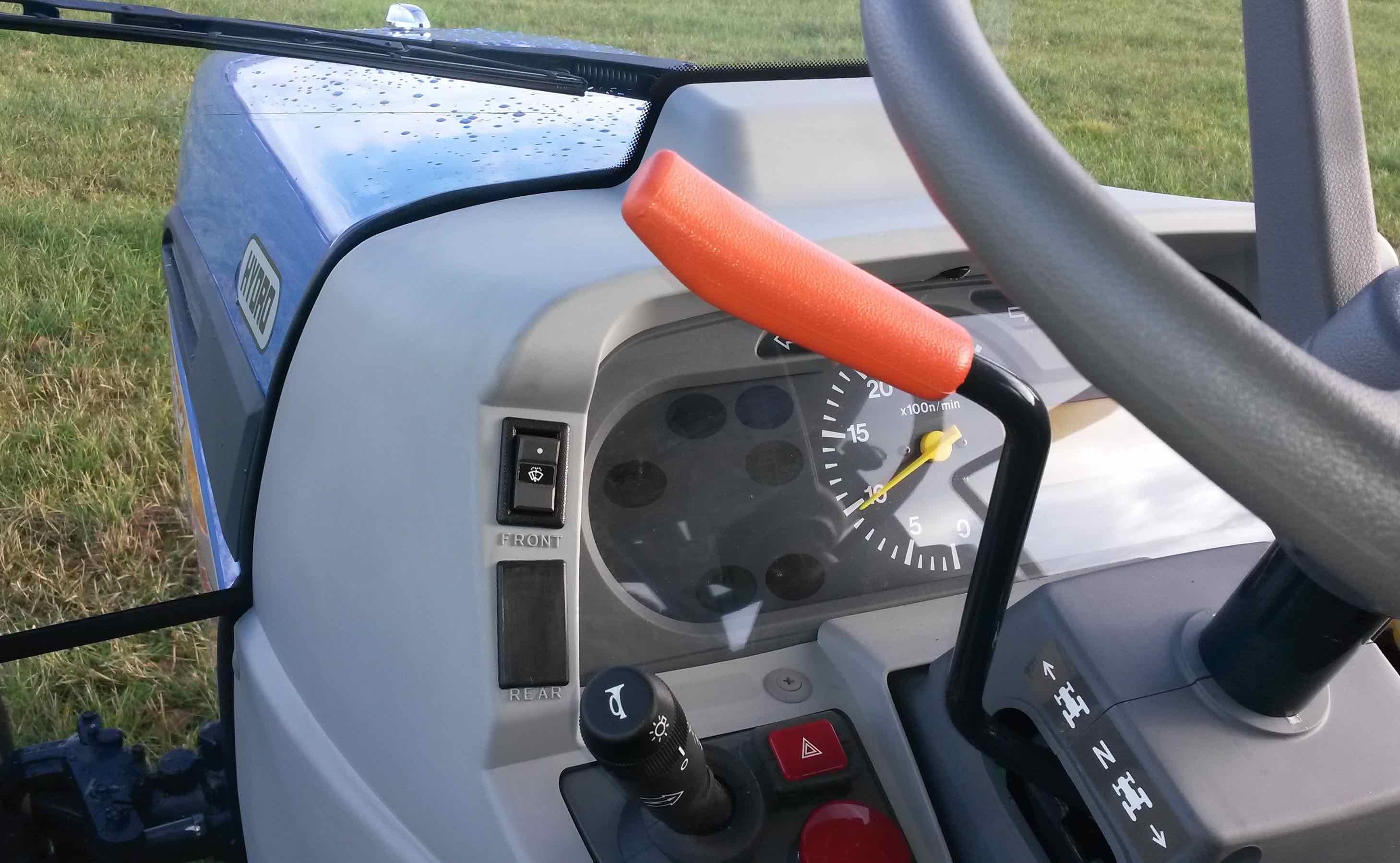

Direction is selected from a dash mounted forward-reverse shuttle lever on the left of the steering wheel - same as on many geared tractors.

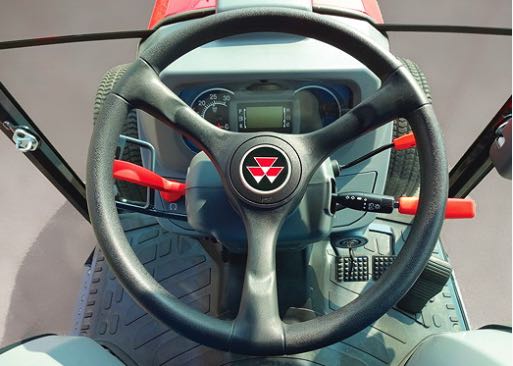

I see Massey are also using this arrangement on some 1700 series HST
Massey 1700 HST Shuttle .jpg.

Are those the brakes next to the HST speed pedal ???
Yes, the brakes next to the HST "accelerator" pedal it made it feel like driving an automatic car (Probably not as much like a car if I had unlinked the brake pedals :D)

meh... the split left/right rear brake pedals need to be on opposite foot than the throttle/hst pedal.
from back dragging via the FEL and front tires have no traction or slightly off ground, to tapping left or right brake pedal to get one tire that is spinning back under control and giving traction to keep from getting stuck. to just using split brakes to help steer on ice / snow / in mud, to simply trying to make a sharper turn.
automatic car like feel should never come across in a tractor. makes unit difficult to use, when ya try and swing other foot over to operate things. could make things more dangerous or impossible to do. and higher chance of getting a shoe caught up in the pedals. and/or pressing throttle/hst pedal, when not wanting to. city slickers vs country folks is what i toss it up to *shaking his head no*

I'm thinking the first two are an Iseki.
You are right, the blue one is a 46hp Iseki, sold in Europe and Australia as a TG5475.
It's an evolution of their TG5470, which in HST form had twin pedals.
The Massey 1700 series is only just being released in Europe. I got the Massey picture from a press release they have just done for the MF1747HC & MF1740HC (46 & 38 hp). These are made by Iseki for Massey, but it looks more than just a re-badge.
From the picture it looks like they have refined the HST-shuttle-on-dash further and put the HST direction selector on a smaller stalk switch on the steering column. Think the switch is the same as Massey use on their bigger tractors.
