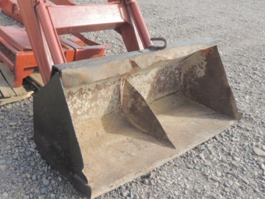

Found this loader. Why is the bucket split into two sides?
Also, if anyone is familiar.. this Davis has its own pump.. why? is it normal?
i know it's older..
   / Davis Split bucket.. What for? #2
I think that's there to reinforce the bucket. My loader doesn't have one and the cutting edge was bent into a smile when I bought the tracror.

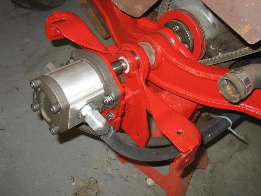

The pump might be designed to mount on the front of the tractor, driven by a coupling on the crankshaft pulley.
On some tractors the shaft goes through the axle.

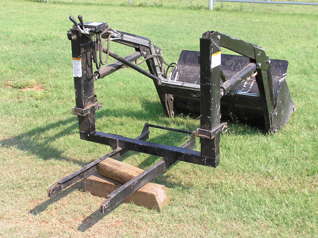

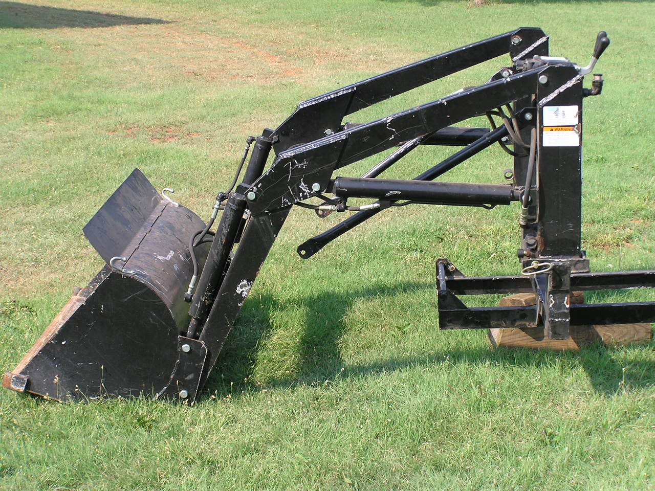

Does the loader tower have the hydraulic oil reservoir built into the loader frame, like mine?
It came with a pump also.
