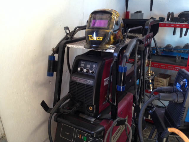

Anyone know of a cheep and good 160 or so amp stick and lift arc tig welder?
My ESAB 161 is a very good one - it is just as good as my maxstar was.
I only sold it to buy the ESAB because I had the stick only version of the Miller.
Tweco makes very nice multi process machines too.
   / DC stick amperage needed for general farm repairs. #12
Dave makes a good point. For a few bucks more you can also mig.
NOW we've started you down a slippery $$slope$$. :D
I like my little Tweco.
