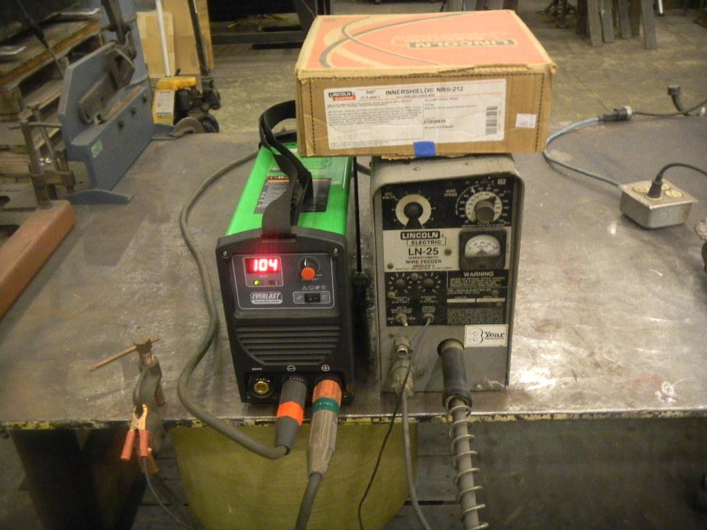

How does the PA 200st do with the tig? I have done a good bit of gas welding but never tig. Ed
   / DC stick amperage needed for general farm repairs. #23
It does very well! I'm not use to lift arc, so I turn that off and just use scratch start. It also has a very nice arc for self shielded flux core too.

What's a good deal on a ln 25? Everyone I've seen for sale has been in the 8-1200 range... So why not go for a powermig 200 for $800? Or does the ln 25 offer better performance?
Obviously if I could find a ln25 for 3-400 It would be worth considering.
   / DC stick amperage needed for general farm repairs. #27
Keep an eye on ebay. I've bought two there so far. I bought this one for a friend, (he doesn't do computers) for $400.00
