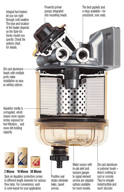

I went through the same reasoning chain, talked with knowledgeable dealer's mechanics and concluded it wasn't worth it in my case, at least. If my problems had been that the pleated filter was clogging up with coarse grit, then it would have made sense to put in a coarse filter in front of it.
To my mind, it makes no sense to put a finer filter in front of the pleated filter. As for the putting in a smaller, cheaper, more easily field-replaceable equivalent filter, it would make sense if you had some warning system (other than the tractor dying) to tell you it was clogging, and also a bypass (like your oil filter) in the event that it did clog.
Screens in fuel tanks are generally there to protect the fuel pump, which you don't have ...your's is a gravity feed system.
Again, on the basis of bitter experience, at first sign of a fuel-related stumble, shut down before you empty the injector lines and check the fuel bowl. If it's empty then mouth-to-mouth (and/or check the fuel gauge and fuel level in the tank). If the fuel bowl is full, then suspect the pleated filter and change it. Then hope that the filter did its job and that the problems are not in the injector pump etc.
If you wanted to do more serious mods, RACOR, among others, makes filtration systems with water separation (and warning lights) and heater elements.

I thought I had already posted a diagram, above, from the shop manual for his machine that shows no filter ...here are the two relevant pics from the parts manual ...I don't see a filter, and from experience with my 4330, I had a piece of crud come down the hose that would have been stopped by a screen if there were one.
the pic in the former message was more of a block diagram IIIRC.. this one is more schematic.. though lacking detail.. but yes.. It does not appear to have a screen... A deffinate oversite IMHO... A small tube like screen element would not have been hard to implement at that fuel tap.... that and a shutoff valve..
soundguy
   / Dead tractor - help! #45
To my mind, it makes no sense to put a finer filter in front of the pleated filter. As for the putting in a smaller, cheaper, more easily field-replaceable equivalent filter, it would make sense if you had some warning system (other than the tractor dying) to tell you it was clogging, and also a bypass (like your oil filter) in the event that it did clog..
There is a warning system.. it's your tachometer.. when you start loosing power and rpm, and have to idle down, and then it dies again upon throttle up.. you know a fuel filter is clogged. This 'warning system' works in conjunction with your brain.
Screens in fuel tanks are generally there to protect the fuel pump, which you don't have ...your's is a gravity feed system..
If he has an injector pump on that diesel.. then he -has- a fuel pump.
I'd rather loo$e a pre-filter and fine filter, vs loosing my injection pump.
Many canister fitlers have water seperators built in. Many tractors have water seps too. my NH has 3 places i can bleed water using finger or thumb screws.. I can't imagine a tractor company building a machine with no fuel seperator bowl.. etc. They ford and others even had those back in 1939...

Soundguy - I appreciate your wisdom here. Sadly, Kubota doesn't to my knowledge offer such an option. The ONLY way that I have found to drain water is to remove the fuel filter surround canister - a task you are supposed to complete every 100 hours per the manual.
   / Dead tractor - help! #48
I think I'd add a seperator bowl with no filter in it.
IE.. no obstruction.. just a canister with a glass bottom and an inlet and outlet, and a petcock on the bottom. It will let you 'see' water and heavy debri.. and drain them.
IMHO.. Kubota missed the boat on that design.. it's pathetic...
soundguy

If you want to add something, how about this Racor?
soundguy
That's hardly unique to Kubota. Every compact ever sold by Ford/New Holland is exactly the same as well as many, many larger FNH's. Few, if any Deeres have had separators.
An additional filter won't help if whatever is causing the blockage is too large to make it out of the tank. From what I am reading, I am not sure gelling is the issue so much as one or more large foreign particles in the tank.
