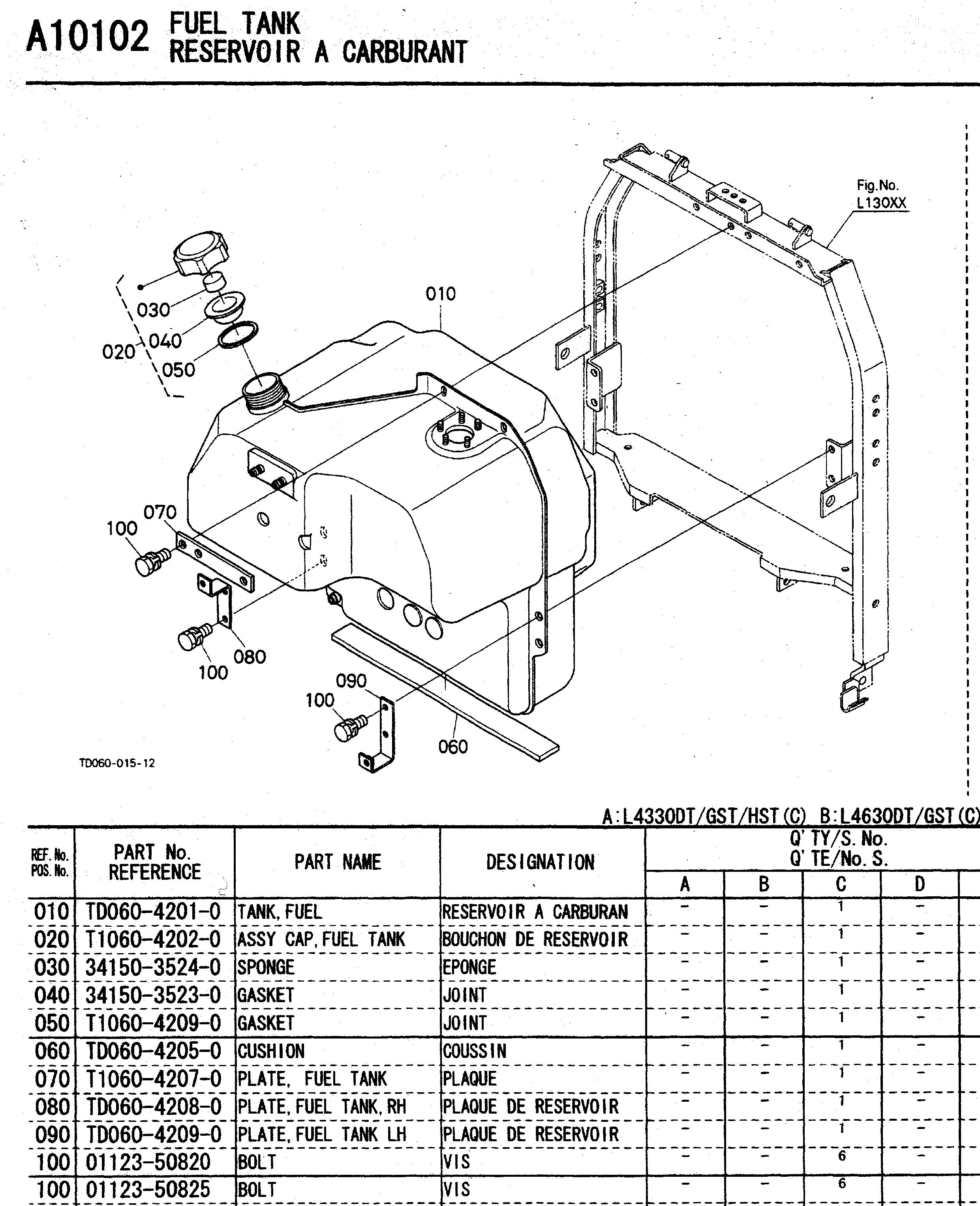

I do not believe you have a screen in the bottom of the tank ...it would make no sense since it is nearly impossible to get to such a screen in your tank ...the outlet is offset from the fill opening. As the shop manual for your 5030 (and my 4330) shows, no screen ...see attached jpg, which you might find generally useful.
If you read my earlier post, it described the easy way to empty the tank, filter the fuel ...put the fuel back in ...if you want to flush, repeat the process a few times.
Let me know if this helps.

I thought I had already posted a diagram, above, from the shop manual for his machine that shows no filter ...here are the two relevant pics from the parts manual ...I don't see a filter, and from experience with my 4330, I had a piece of crud come down the hose that would have been stopped by a screen if there were one.
