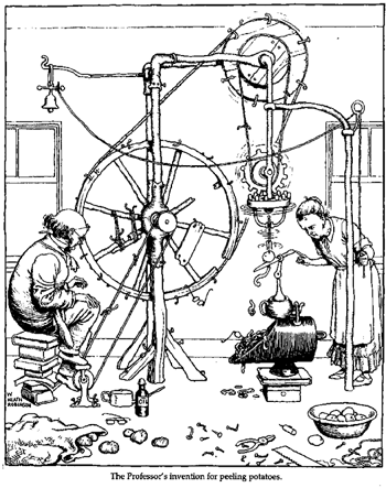

You ever see those Rube Goldberg drawings from the past??? Heres one of your compressor :laughing: :laughing:
   / Dealing with air compressor condensation #23
That's exactly what my son said the first time he saw it ..... :)
