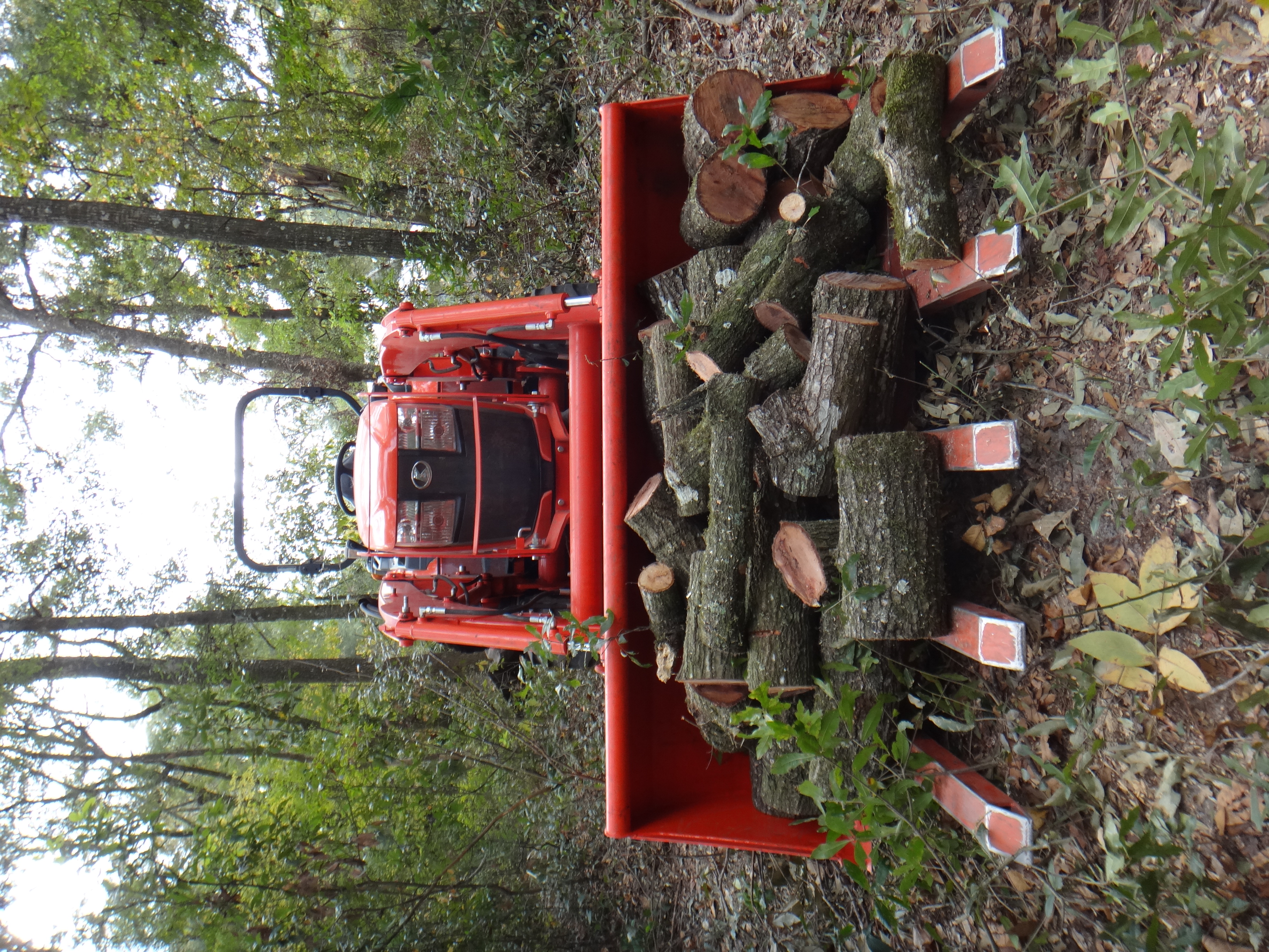

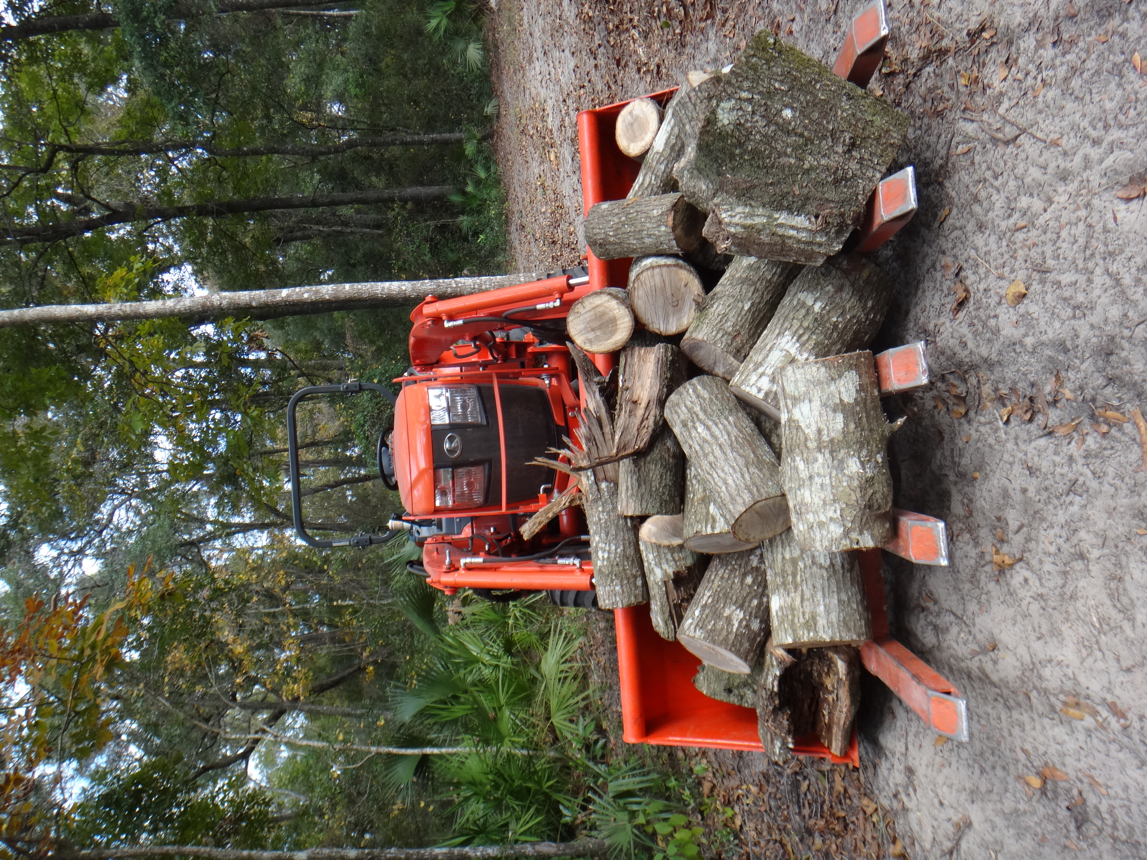

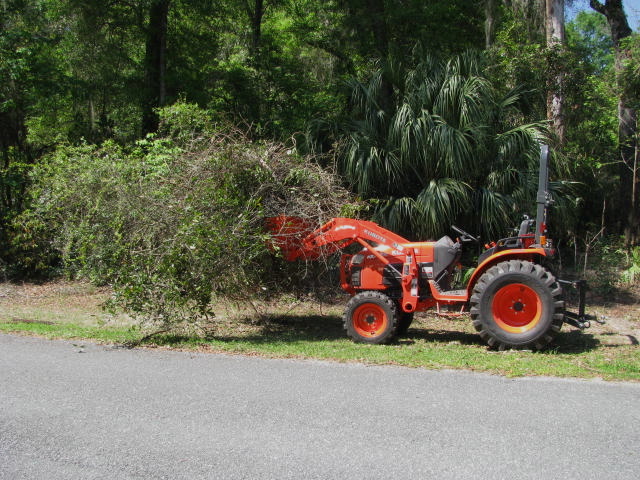

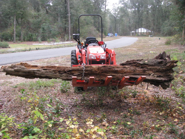

Steel Debris Forks are heavy, reducing your lift capacity.
Aluminum Debris Forks are light but expensive.
"Wondering if those forks are too thick for what I want, and if a spear style fork would be better?"
While my Payne's aluminum Debris Forks have been indestructible, they pick up considerable dirt with the debris.
Here is a LINK to several firms producing manure/silage forks for tractor FELs.
LINK: tractor manure forks - Google Search
