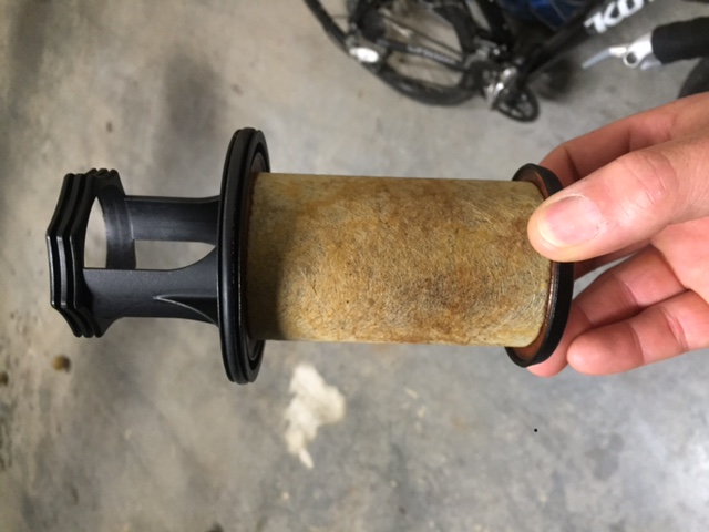

As for the separator/catch can system I am running...... take a look at the last pic I have in this post. It is the current state of my PCV filter. It appears to be removing material. How much as compared to the total amount, and how much benefit it is providing in the long term I wish I could say.

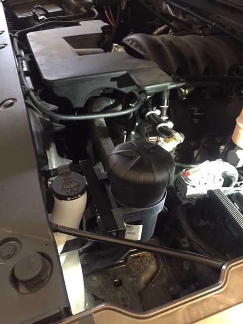

Several oil changes ago I started running a can of CRC intake valve cleaner through the system a day or so before doing the oil. Been using a flex nozzle off a can of WD40 and inserting it right before the throttle body.

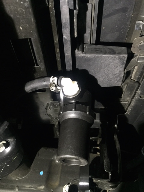

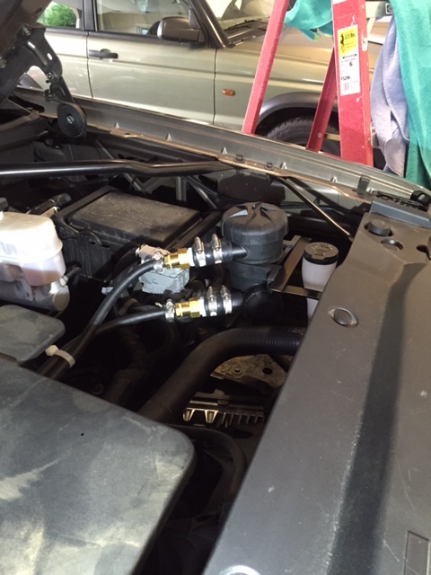

I also retrofitted a Mann Hummel Pro-Vent 400 Oil Separator (i.e. catch can) to the truck at around ~20,000 miles. It is a canister filter with a replaceable paper element as opposed to the colescant filtration typically seen on other catch cans. It has a drain hole below the filter element which in typical installations for TDI engine can be routed back to the oil sump. In my case I routed it to an additional collection sump below my bumper to eliminate any possible concerns with contamination. When I have emptied the sump I have only really seen water condensate in the collection area. A big plus for this layout is that it pretty much eliminates any concerns I have with condensate freezing in the main filter area and clogging the system.

I've been using CRC every oil change so at ~7K intervals. I believe the instructions on the spray can recommend every 10K. As for the Pro-Vent, I check the condensate canister every month and will be changing the filter this next oil change. I'm pretty sure the instructions for filter changes recommend once a year depending on soot levels - and I am actually due to change the filter this next oil change.

Would not recommend a catch can either, especially in cold climates where they can freeze up, not allowing your crankcase to breath at all. Plus, if the system is not set up correctly with the proper evacuation with check valves, you're doing more harm to the engine than good.
Snobdds - I would be really interested to hear more of thoughts about the issue of check valves and evacuation. The last thing I would like to do is to cause damage to my truck's engine. My understanding, and it is limited, is that check valves for the 5.3L eco-tec engines were only necessary when you run a clean side separator system in addition to the more typical PCV catch can installation. As for freezing up, I'm hopeful that I eliminated that concern with having a condensate sump that drains from the bottom of the filter housing. Seriously, if I am missing something I would really appreciate a critique of the system I installed.
