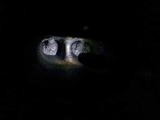

Here's what my buddies plugged up bmw looks like, they are in the process of using walnut shells to blast the carbon away.

Can't fool me - that's detailed archeology work from Pompeii. :laughing:
Yikes ! That looks like a Break My Wallet service !

Lol, It's actually a mini in the pictures.
I don't have all the details of the job but they are doing the blasting with the head in place and vacuuming afterwards, he did say they had 5 hours labour in it so far. He was telling me when I was machining an adapter for the spark plug hole so they could check compression and do a cylinder leak down test. Apparently the mechanic did not have one.

He's lucky to have a friend with your machining skills; buying an individual adapter can be a PITA.
5 hours+ with the head attached..... slow going with that heavy of a deposit. I guess today's borescopes are good enough you can be confident that everything is vacuumed out.
If you get a final total cost, pls let us know....
I, as well, would be interested in the final price for the service. And you sir are a good friend for doing the machining so his mechanic did not have to purchase an adapter!! Those Mini's are a pain to do anything with because things are so tight in the engine compartment that you almost have to pull everything just to get anything done.

What you bring up right there is the main reason, aside from perceived cost, that I've not pursued getting the Mini blasted. I've read some horror stories about what happens when all of the media does not get removed after the service. We got lucky with mom's purchase in that the timing chain had already been replaced and judging by the service records most of the kinks had already been worked out by the time we purchased. At the moment I'm treating it kinda like Pandora's box....pretty but I don't want to open it up and let the demons out.
Boy that looks worse than an old V8 that's been run around with no valve guides left...

My preference would be to have it blasted with the head off, but not if I had to pay somebody to re/re it...
