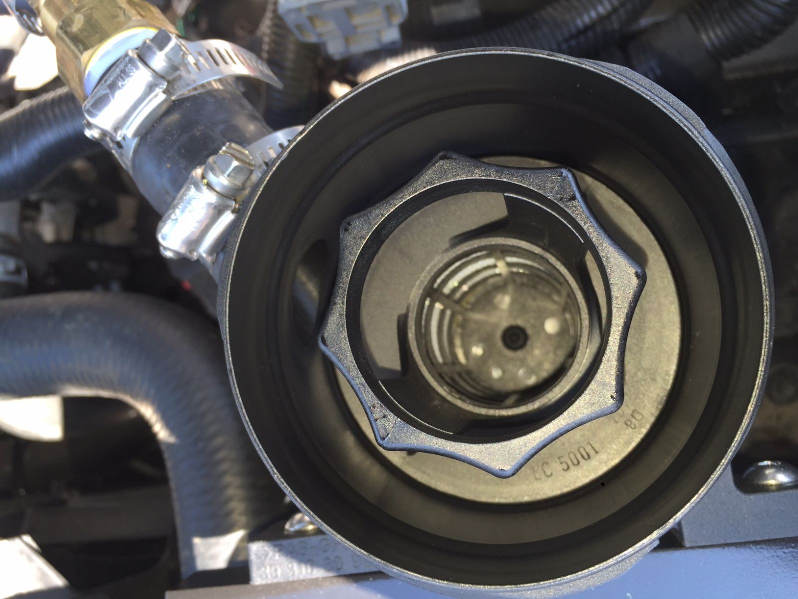

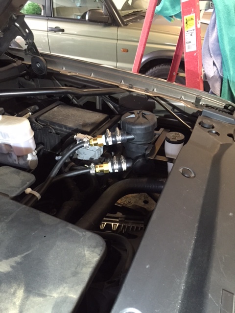

2014 GMC Sierra 5.3L with 3.42 gearing - I have roughly ~44,000 miles on it. Anecdotally the truck does seem to run better after running a can of CRC through it prior to each oil change. It's very hard to say, in my case, if there is an actual improvement or if it is more of a placebo effect that I am imagining.
As for the separator/catch can system I am running...... take a look at the last pic I have in this post. It is the current state of my PCV filter. It appears to be removing material. How much as compared to the total amount, and how much benefit it is providing in the long term I wish I could say.
Several oil changes ago I started running a can of CRC intake valve cleaner through the system a day or so before doing the oil. Been using a flex nozzle off a can of WD40 and inserting it right before the throttle body.
I also retrofitted a Mann Hummel Pro-Vent 400 Oil Separator (i.e. catch can) to the truck at around ~20,000 miles. It is a canister filter with a replaceable paper element as opposed to the colescant filtration typically seen on other catch cans. It has a drain hole below the filter element which in typical installations for TDI engine can be routed back to the oil sump. In my case I routed it to an additional collection sump below my bumper to eliminate any possible concerns with contamination. When I have emptied the sump I have only really seen water condensate in the collection area. A big plus for this layout is that it pretty much eliminates any concerns I have with condensate freezing in the main filter area and clogging the system.
I've been using CRC every oil change so at ~7K intervals. I believe the instructions on the spray can recommend every 10K. As for the Pro-Vent, I check the condensate canister every month and will be changing the filter this next oil change. I'm pretty sure the instructions for filter changes recommend once a year depending on soot levels - and I am actually due to change the filter this next oil change.

My Setup:

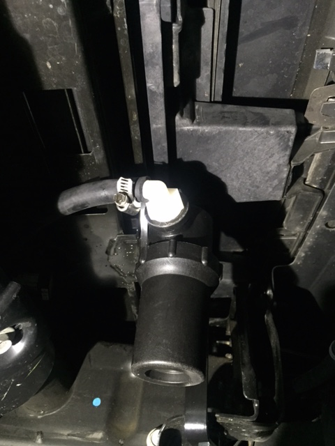

Filter and condensate sump location
View attachment 461450View attachment 461447

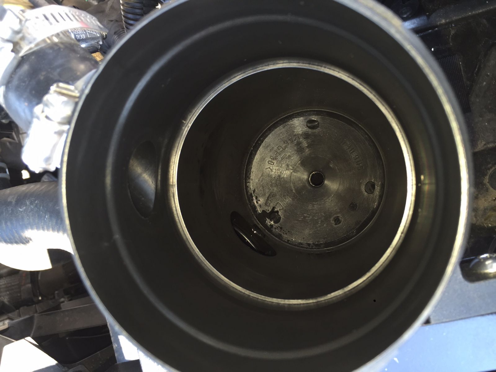

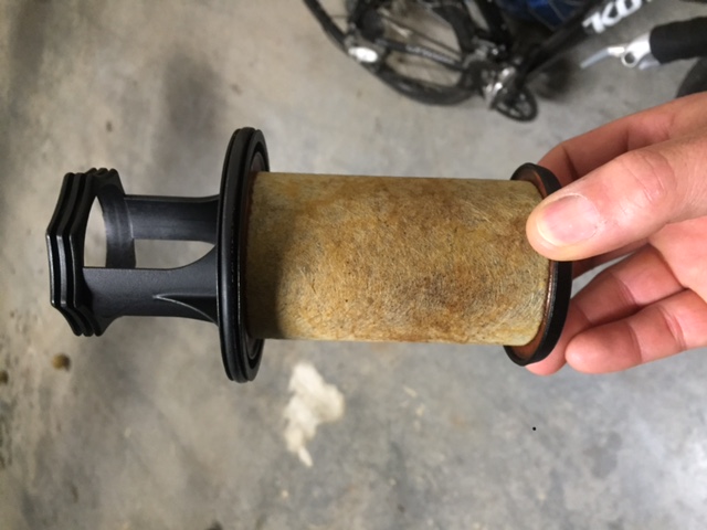

Filter canister with and without paper filter (drain in 2nd pic leads to the condensate sump below the bumper)
View attachment 461452View attachment 461451
Current state of the paper filter
Thanks for all those details and pics. I don't know enough about the 5.3 to make further suggestions - to my eye your setup looks well designed and installed.
I prefer to learn about issues beforehand if I can..... why I started this thread. I hadn't thought about the condensate freezing issue - that alone is worth my keyboard time here........ You do have an advantage over me on this issue (unless you make long drives to go sledding in the Winter :cold: ), as I expect that you don't see many -30 days in GA.
That filter you used looks to be high-capacity, and only lightly contaminated. If it was intended for tdi applications, it would have been designed to deal with a lot of contamination - I've seen the top ends of EGR tdi's taken apart - in stock configuration they tend to carbon up to the point where the intake is severely, or sometimes even completely, blocked with carbon.

If I remember correctly I believe the filter I am using is a standard efficiency and they do offer one with a higher filtering capacity. I'm on the fence at the moment about switching as I don't want to create too much resistance. That is also why I'm probably going to be changing filters about once a year. I can't remember the service duty for the filter currently installed but I want to say it is something rediculous like 60K. I know it is over kill but given that this a nonstandard application the last thing I want to do is change the vacuum pressure too much. As it is I had to switch the intake and outtake ports to circumvent the relief valve. The Pro-Vent I used is rated up to 400hp but when I routed the houses as directed I had a constant vacuum leak at idle. Seems to work fine that as there are no baffles in the canister and no leak issues.
