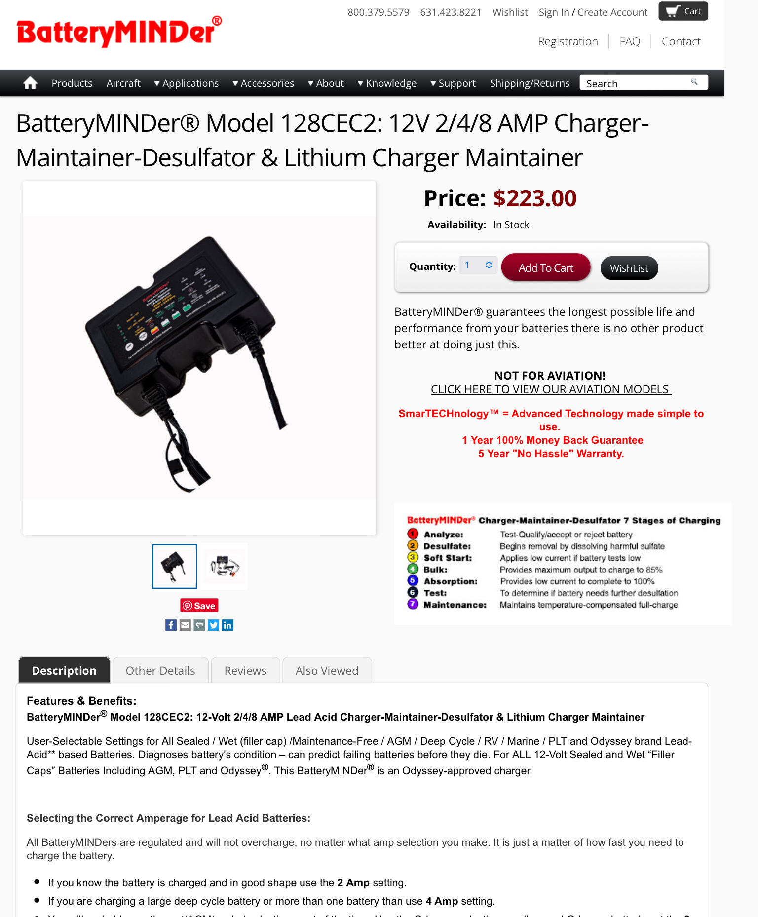

Best charger I have ever had. At 8 amps it's not a fast charger, but certainly an overnight recharge for a dead battery. Also a great maintainer / desulfator, and can maintain multiple batteries.
Battery Minder also makes less expensive 2 amp maintainers that are very popular.
