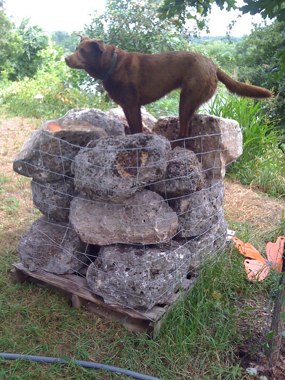

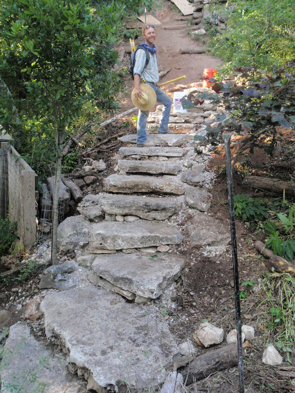

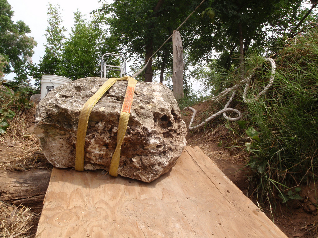

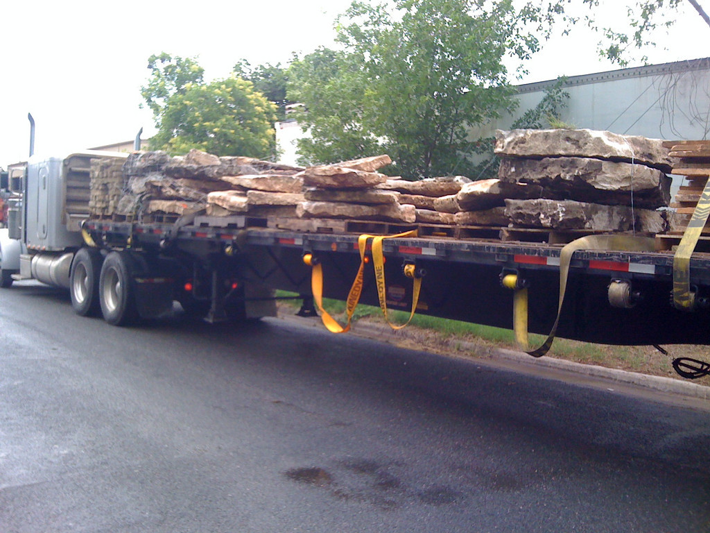

Thanks for the feedback. Concerning the pallets of rocks. For my particular project I've placed large orders where they show up on a tractor trailer.
Thankfully, those bulk orders are over (I hope). With those deliveries a large skid steer unloaded them. Believe it or not-I moved all those stones with rock bars....Egyptian style, creeping to the edge of bluff on logs. Once to the edge of steep bluff-gravity takes over. They're strapped and move down a ramp, slowly, with 3 pulley anchors to manage the load.
Now I'm grabbing a pallet or two at a time-so I'll be unloading them. They also won't be as big as before-those stones were mostly stairs-all in the 300lb + range... The stair case is mostly finished - 65 steps down a 90' bluff.
I guess I'm partial to Kubota because I did a similar job with one a couple years ago. Moving rocks, etc....That machine was very reliable. The work I'm doing is extremely dangerous and I don't need equipment hiccups. The problem is
the fella whose tractor I used for that job has moved and I can't for the life of me remember which model he had.

Wow, very nice work, I'm impressed. I'm guessing you'd be hard pressed to find a tractor under 50 hp that could lift some of the pallets off the truck anyway.

Also very nice job on the stairs:thumbsup:
