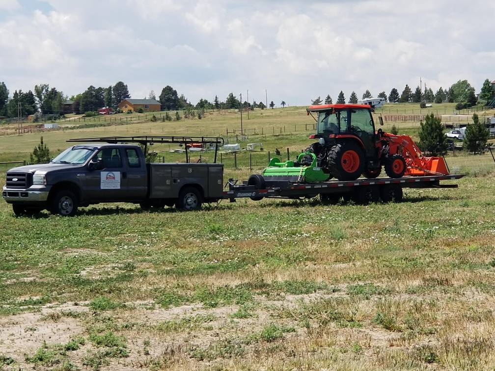

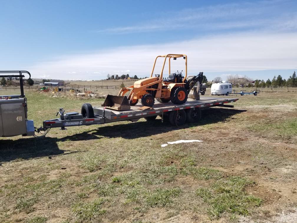

22' tilting deck... some of my impliments will drag a touch if I'm parked level. I try to park nose downhill or backed up to a slope of some sort to minimize it. The little berm behind the trailer with the small backhoe on it is plenty. The roller on the back of the flail mower makes it mostly moot when I'm hauling the mower.
I miss my old low profile gravity tilting deck at times. It was nicer to load a tractor on with minimal deck angle. But no fenders or side rails for wide impliments (flail mower) & loading not the tractor is worth dealing with the extra deck angle. 20180618_122125.jpg20190401_113044.jpg
I miss my old low profile gravity tilting deck at times. It was nicer to load a tractor on with minimal deck angle. But no fenders or side rails for wide impliments (flail mower) & loading not the tractor is worth dealing with the extra deck angle.View attachment 606056View attachment 606057
