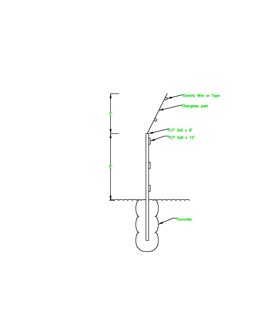

With as much time and money as I have invested in starting my vegatable garden this year, I figured it would make good sense to take the extra step and put up a good fence. My main enemy is deer. We have a large population around the property that has become accustomed to people and even the dogs.
I have a design in mind that will incorporate a "three rail" fence that is popular around here (southern Ohio) with an electric fence. I hope to have something that looks good to human eyes but means business to the deer.
See the picture for my design concept. I sketched up a side view of what it might look like.
The reason for the angled portion of the electric fence is to provide the "3-D" effect that I have read on this site and others is very effective in keeping the deer from jumping over. This would face away from the garden.
My questions for y'all are:
  1. Will this work?
  2. Any suggestions for improvement?
  3. What is a good way to attach the fiberglass pole to the top of the post?
Thanks in advance for any comments and suggestions.

I don't know what your spacing is on those lower boards - but I've seen deer go between the wires of a 4 string barbed wire fence -- at a run.
/ Deer Fence Design #4
If those 3x5 posts are landscaping timbers, they usually have a very light pressure treatment and will not last more than a few years as posts. You would be much better off using 4x4s which are more heavily preserved.
/ Deer Fence Design #5
Studies at Cornell show the deer can jump over an 8ft fence so make sure it is high. With the higher attachment facing outward it should be effective. The other system I've seen that works is one with 2 fences the inner is about 6 ft high and the outer is at a 45 degree angle from the base of the inner with wire strands run through it so the deer can't get near the inner fence to jump up.

I agree with what chatcher is getting at. A 3 board fence looks nice but it will do nothing to keep rabbits, coons and other varmits out of your garden. Unless you are going to put fenceing behind the 3 board. A 2x4 fenceing maybe with a finer mesh along the bottom to keep the rabbits out. And keep the fence line clear of all weeds so you can see if something is trying to dig under (you could lay some chicken wire along the ground to discourage digging but that would be up to you).
I personally just use a 5' woven wire fence to keep the deer out of my garden. It is tall enough that they will really have to have some ambition to want to get in. And there is plenty of other food outside of the fence so they do not bother trying to go over my garden fence. Now I only use 5' woven for a temporary fence. If it is going to be permanent I would sink 12' post into the ground and put up an 8' woven wire fence with a fine mesh over the woven wire along the bottom 2 o 3'. We use 8' woven wire to keep deer into pens and wild deer out and have never had a problem with a deer going over.

Your design looks good to me except for leaving the bottom part open. If I go to the trouble to put up a fence, it needs to keep the hungry rabbits out.

Deer can jump high (over 8 feet) and they can jump wide but they can't jump high and wide at the same time. Horizontal extensions of lightweight material at the 8 ft level at the top of a conventional fence will discourage deer.
Electric fences up in the air won't do the trick as the deer can't touch the ground and the hot wire at the same time.
I have seen deer crawl on their bellies under the bottom wire of a 5 wire barbed wire fence instead of jumping the 4 1/2 foot fence and other times clear an 8 ft fence.
To keep critters (all critters big and small but not winged) out of the garden can be done but requires a fence with close spacing for the first few feet and must be tall.
There are outfits selling the materials for making horizontal extensions on the top of fences to deter deer. These are not so much a physical barrier as a visual one. If it looks too high and wide to jump the deer will not challenge it.

That is an excellent point, Pat. I'll have to rethink the placement of the electric wire if I use it at all. It's hard to beat the price of electric fence, though.
That's interesting and disappointing. I would have guessed that pressure treated is pressure treated. Those timbers are half the cost of a standard 4x4.

You just have to run a hot and a ground wire up high. They touch both when they jump up and get zapped. Would love to see a video of that!

From what I've seen up here in Maine, a two fence system works well. Basically, have two parallel fence lines spaced six feet apart at about 3' off the ground. I've even seen this using only single wire fences. Apparently, the deer will jump one fence no matter what, but they don't like to be stuck between two. I've also heard that you sort of have to train the deer by putting pieces of foil on the wire and bait it with peanut butter. (Oh, I see mjfgox6 pretty much posted the same thing.)
The downside is that you have a six foot wide perimeter that needs to maintained between the two fence lines. Electric fence is a psychological barrier, not a physical one!
