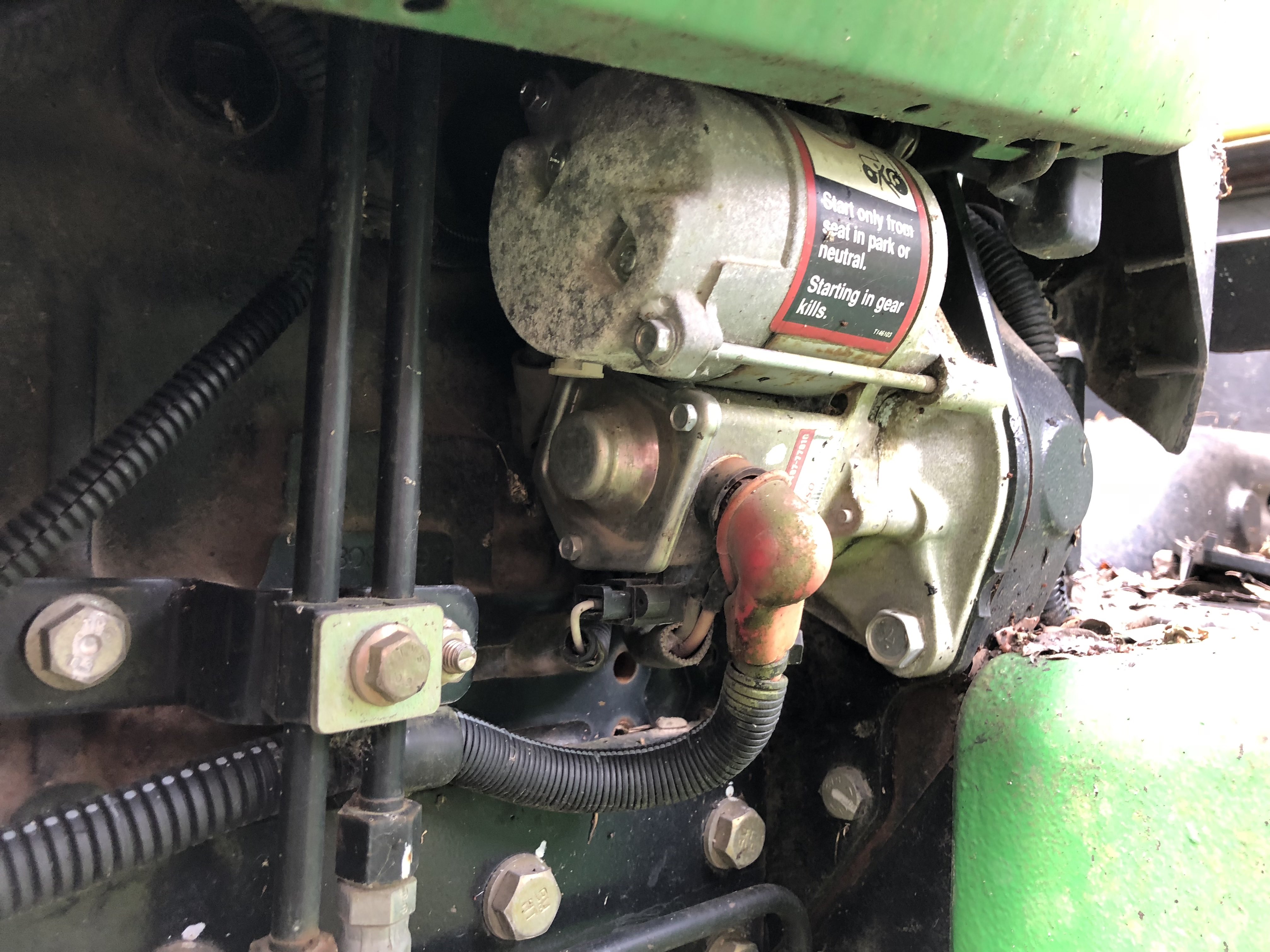

I also thought about jumping the starter but when I looked there was only one cable and I'm used to seeing two terminals and hitting it with a large screwdriver.. not really sure how to do it here.?
   / Deere 3038e won't start, just a click, but not the good click.
Here is the starter on my deere 3038e

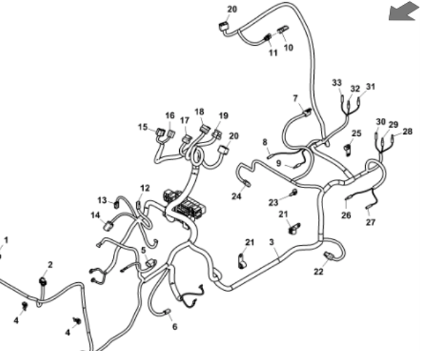

Try running a jumper between the two leads on your neutral safety switch. It should be a shielded loom on the left side under the floorboards that goes to a sensor on the transmission. On the schematic it is #22. Part # RE12363
My 4310 had similar issues and I just pulled the two wires out of the loom and then pierce the insulation with a test light and jumped it with a paperclip just to see if it would work and it solved my issue but mine is power reverser. The sensor on mine is really buried under the floorboards to the point where I could barely see it.
pull that red cover back, there's more than one wire in there, try jumping the small red wire to the battery + and see if it cranks.. it could be that the black wire needs to be grounded though, depending on the safety switch arrangement..
