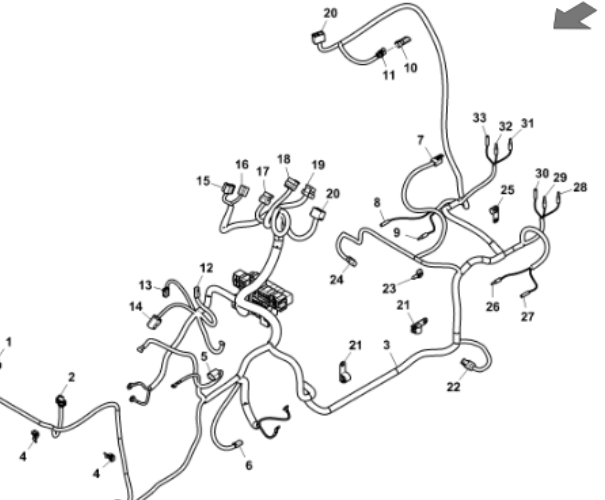

Deere 3038e won't start, just a click, but not the good click.
   / Deere 3038e won't start, just a click, but not the good click.
#11
Try running a jumper between the two leads on your neutral safety switch. It should be a shielded loom on the left side under the floorboards that goes to a sensor on the transmission. On the schematic it is #22. Part # RE12363
My 4310 had similar issues and I just pulled the two wires out of the loom and then pierce the insulation with a test light and jumped it with a paperclip just to see if it would work and it solved my issue but mine is power reverser. The sensor on mine is really buried under the floorboards to the point where I could barely see it.
awesome man I've been looking for that! I found the sensor, pulled it and jumped it and unfortunately no change...

   / Deere 3038e won't start, just a click, but not the good click. #17
View attachment 574206[/QUOTE]
you can start this manually by disconnecting the spade terminal connector on the bottom of the start and touch the spade terminal on the starter with a jumper wire to the hot terminal behind the red protective cover on the starter wires

#20
you can start this manually by disconnecting the spade terminal connector on the bottom of the start and touch the spade terminal on the starter with a jumper wire to the hot terminal behind the red protective cover on the starter wires[/QUOTE]
went out this morning and check the battery, it was at 12.08.. so I did what you suggested and jumped from the spade to the hot terminal and it cranks.
I assumed I could start the tractor this way but it wouldn't ever start. it just kept cranking. I tried turning the key at the same time and made sure all the safety switches were in the correct position. checked for fuel and there is fuel.
So I'm getting it to crank this way but now I'm lost even more lol.
metered the seat safety switch as well and it was open but when I turned the key i would get 12.
