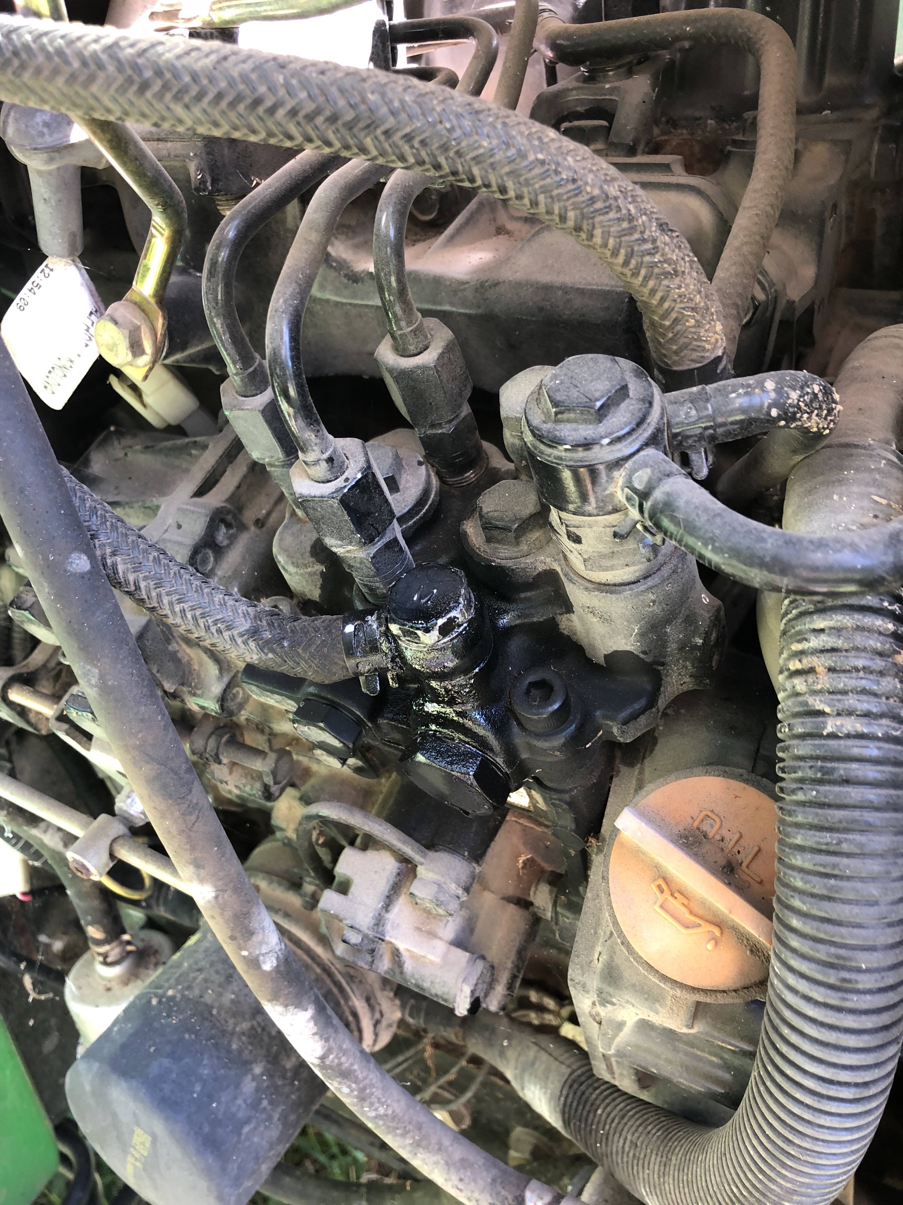

I'm getting fuel, when I crack this bolt (see image) open fuel is being pumped freely when the key is turned on. I removed the fuel relay to see if it made a difference and it didn't. it is cranking like no fuel/fire though.
Back to my original problem, me jumping the starter gets it to crank, so what am i bypassing that could cause it not to crank with the key? On a car we would do this when the starter solenoid was bad but we would no this from the clicking noises..

Sounds like the thermistor. Loosening that nut on the injection pump only proves that you're getting fuel up to that point (your lift pump is working properly). The fuel solenoid on the injection pump is still closed and preventing it from injecting any fuel into the cylinders.
