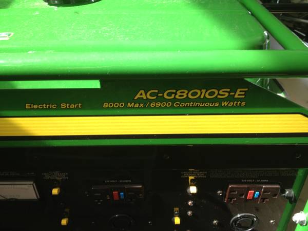

I am supposed to wire up a generator cord for a friend this week. The 30A 240v plug in this pic doesnt look like my twistlock L14 30. The best I can tell it may be a L17 30 receptacle?? Does anyone know for sure so I can be prepared??

The one on the right is a L5-30P 125 volt-30 amp.
The one on the left I don't have the package to but I do have 2 of them.
Home Depot should have all of them. Does that genny have sine-wave power?

The 120/240v looks like a 20A but specs say it should be a 30A 240V

- Two 125 Volt, 20 Amp, Duplex (2outlets), GFCI protected receptacles.
- One 125 Volt, 30 Amp, Locking Type Receptacle.
- One 125/250 Volt, 20 Amp, Locking Type Receptacle (AC-G6010).
- One 125/250 Volt, 30 Amp, Locking Type Receptacle (AC-G7510, AC-G8010).

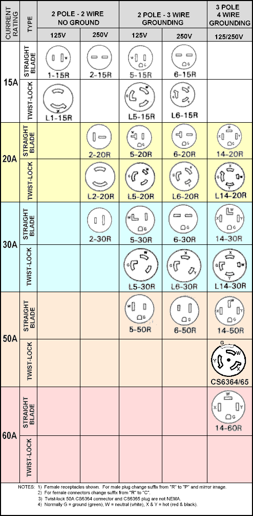

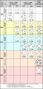

/ Deere Generator 30 amp #5

That won't be a sine-wave generator. Receptacle on the left is a 125 volt 30 amp (NEMA L5-30). Receptacle on the right is a 125/250 volt 20 amp (NEMA L14-20). I don't see a 125/250V 30A receptacle on the generator pictured. Strange for an 8000 Watt generator, but who knows were "John Deere" is having these made. Good Luck.
/ Deere Generator 30 amp #7
Sure looks like an L14-20R (20A) to me. I would have thought it would have been a L14-30R(30A). Notice that the ground tab(the one with a bend on it) is turned out on the L14-20R and it is turned in on the L14-30R.

I thought it should be a 14 30 also but it does appear to be a 20. I will stop by a dealer today and check it out.

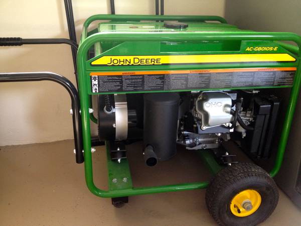

Howdy ! Hope all well. I have AC-G8010S-E JD generator. Saw where you wired plug for friend for this model. Recently bought brand new one , same model except has electric start also. Haven't had time to play with mine. I was wondering if you or anyone had any comments good/bad or ugly regarding this unit ? Or if You know friend still has it and or how its performed ?
Got mine at 50 % off regular price felt like I couldn't pass on it when I 'am in future need of a genny.
