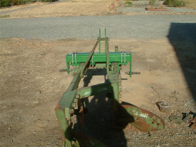

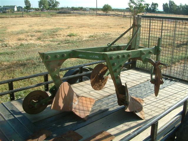

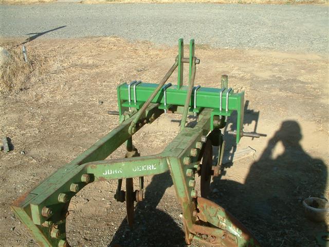

You sir are correct. Here's my JD 2-14 plow that I bought for $200.

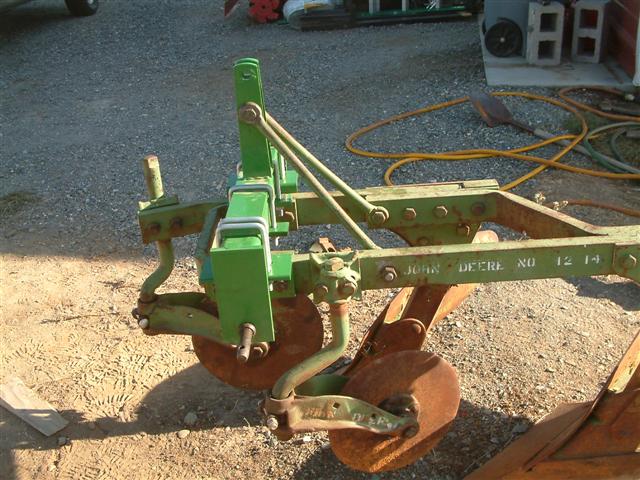

The 3pt hitch mechanism on that plow was shot--wouldn't hold adjustment when plowing. So I spent about $20 on some steel and welded up a replacement. I suspect many old plows have this problem.

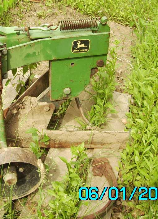

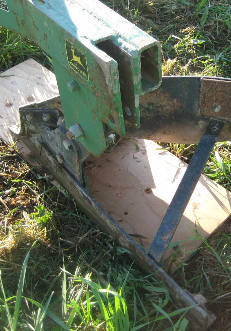

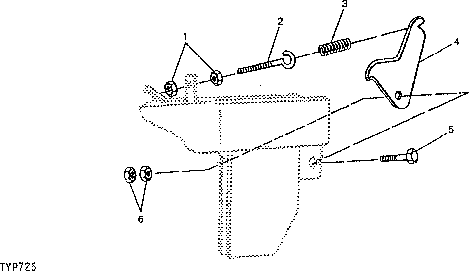

When you look at these two plows, does it look like the trip kit could have been an "option"/extra? If shear bolt protection was "standard", is that how it'd look on the first plow? Or, is the trip simply missing from the first plow and somebody cobbed it together using that upper bolt and hole? Notice those bolts are inserted in different directions in the two pictures, for what that's worth. I'm attaching the schematic of the trip kit image from JD Parts.com.

I think you are correct about the added option kit for tripping the plow. And correct about the shear bolt located above the pivot bolt (if indeed that bolt is keeping the plow from tripping). I didn't understand the "inserted in different directions" statement. ??

Oh, just that in the first plow picture, the nuts on the pivot bolt and the "shear" bolt are on the left side (the side we're looking at). In the second plow picture (the plow with the trip) the pivot bolt and the trip bolt go through the frame the opposite way with the nuts on the right side.
The drawing seems to show the trip bolt going through with the nut on the right side, so I was assuming the second plow has it correct, and it's possible that somebody had the bolts out at one time on the first plow and put them back the opposite way. Not sure than means anything really.
I'm mostly just wondering if that upper bolt is the original shear protection on the first plow, and whether it looks typical for a shear bolt protected Deere plow.
   / Deere Plow - Oldie but Goodie? #15
Appears to be the shear bolt, and "direction" or side the nut is on shouldn't enter into the performance. :)
