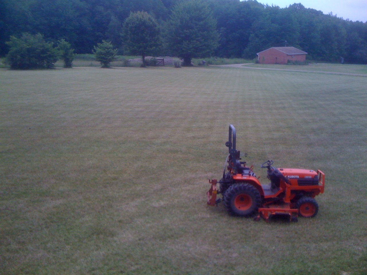

I went with the 72" MMM as I was hoping it would cut down on my mowing time. Now I make 2 passes on the paths with the 72" MMM I could do a path in 1 pass.
It likely will ..... although I usually overlap my previous pass by 12" or so - when I mow, and the mowing is done with each pass in the opposite direction of the last.
The overlap is done in to run the deck over where the front and rear wheels on one side have mashed the grass down - in an attempt to stand up any mashed down grass and (re)cut it.
Somewhere in these forums someone stated that they started with the 60" MMM but moved up to the 72" MMM and were glad they did as the deck sticks out a bit more and it is easier to go around trees and bushes.
Dunno who said it, but it's a good and valid point.
Most of my land is flat but there is one area that I think I would scalp pretty badly with the 72" MMM as I already experience some scalping with my 54" MMM.
I really don't have much in the way of scalping problems .... the couple of areas where I do, are either areas where I need to fix the grade, or just areas I shouldn't even be trying to do with the MMM (like the edge of lawn where it drops 4" to the driveway.
Attached are a couple of pics of the last mowing I did - they aren't the greatest quality (taken with my iPhone), but they might give you an idea.
FWIW, a word about the condition of the lawn - it was cut about 2 weeks ago for the first time this year - and the grass was around 3' tall at the time - so the lawn isn't in the greatest of shape.

I have a B2910 with the 72" MMM ..... I would not buy one again .... and am a bit disappointed in the dealer for recommending it - mostly for the PR/sales pitch I got when it was sold to me: "cuts pretty good" (yeah, it does - but it ain't that good) ...... "it's easy to remove and install" (well ... your idea of "easy" is a little different than mine ....)
a. A belly mower or rotary finish mower typically does not have a full width roller to avoid scalping which also increase the pounds pewr square inch of contact pressure at each roller where a full width roller has a lower PSI as the entire weight is spread across the full width roller.
b. The RAD mowers from canada are what they offer for the kubota belly mower and they cost less to buy and sell.
c. if you travel slowly anything cuts good but a belly mower or rear finish mower tears the grass as it moves(no matter the speed due to:
c 1. the horizontal rotation of the blades
c 2. the high blade tips speed which allows a faster cutting edge speed due
to the limited amount of cutting edge on each blade
c 3. the forward or rearward direction of travel
While it does a decent job - the front R4 tires always squish down a fairly wide swath of grass as you run over it -
and, depending on your mowing height, it may result in the grass that has gone under the front tires not being pulled all the way up when being cut (unless you plan on redlining your tractor every time you mow) ..... after a few days (a little post-mowing rain always seems to help) the grass that went under the front tires is a bit longer than the rest .....
