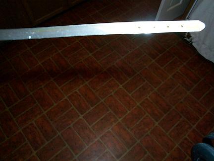

Heres what delvac looks like around 30 hrs in a gas engine.

</font><font color="blue" class="small">( Heres what delvac looks like around 30 hrs in a gas engine. )</font>
No matter when I change my diesel oil, it never looks so good coming out as does oil from a gas engine! It's always dark dark dark. I know every 50 may be overkill, but it's an expensive piece of equipment and grease and oil is cheap in the long run. I suspect that most any properly API rated oil will do just fine at every 50. I'm not into leaving oil for long periods, but could probably be left a lot longer than one would think without the acidic changes that pit metals.
I've not used the synthetics in my tractor, but use them in my RV generator just fine. John
