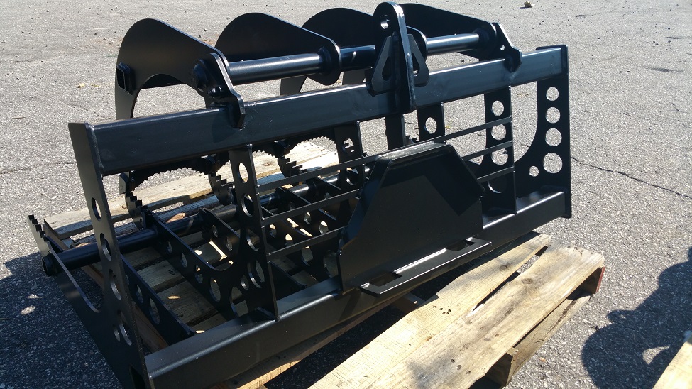

Kent's Wicked Grapple grapple is now in the pool of sold grapples awaiting final assembly....cylinders, hoses, etc.
Unfortunately, this is our most back logged dept. as of late!
This will give you some time to work on your hydraulic mods, Kent!

I just got word that our first narrow(er) grapple with a mini skidsteer universal hitch is almost complete.
Kent, you're an inspiration!!
I'll share pics soon!
Travis

Hope it ends up being a good seller for you guys! You should certainly be able to price compete with Bradco and some of the other guys! I'll be interested to see those pics! Are you keeping the 30" lid -- or is that still TBD? I'll also be anxious to see how much it weighs -- maybe you can get it down close to the 200lb point.
Meanwhile, it will provide very strong/robust alternative to the PT-offered T-8 light utility grapple of a similar size. I really don't think the whole difference in mounting plate angle to be a big issue for the PT machines. As I've stated repeatedly, it is more important to be able to curl down with your root grapple -- not only to dig roots and compress the brush pile before clamping -- but also the grapple holds the load in the bucket when curled up, contrary to a bucket of dirt or rock which needs more bucket curl up...
