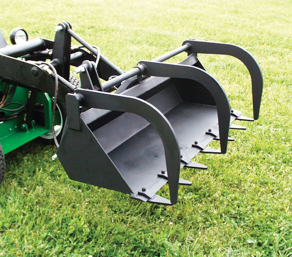

I'll admit, I do not know much about these cool little machines, but we had a customer that demanded one of our 50" Wicked Grapples for his Power Trac PT425.
We obliged and are in the process of building it.

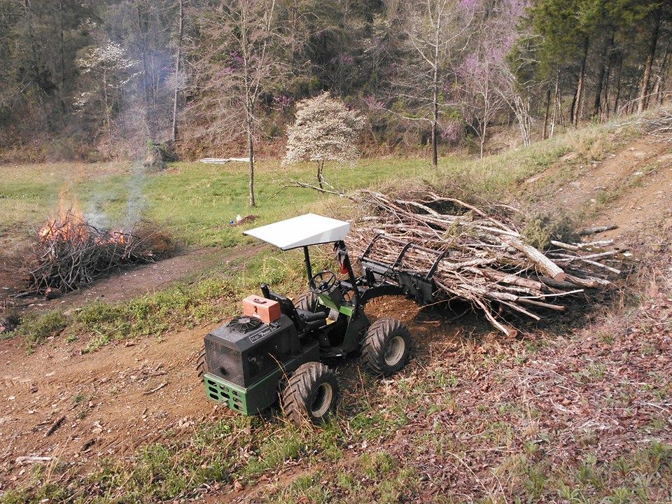

Having used one of their T-8 grapple buckets for about 10 years, I was pretty aware of their capabilities. But, I have a 60" rock/dirt bucket with teeth for the new-to-me PT-1430, and wanted to have a more specialized grapple. (My grapple bucket has been my most used attachment.) I also stress-cracked that T-8 grapple bucket with my PT-425, digging roots (and had it repaired), so I was aware of its limitations. But, don't underestimate its ability to handle brush. Here's a couple pics of grapple loads that I've moved with the 45" T-8 grapple bucket on my old PT-425.

Yeah, brush is loose and a grapple is perfect to squeeze it, get and go! I pull lots of 40-60' telephone pole sized locust trees out of our woods with the 425. I doubt most of them weigh over 500#. A few with butts starting to get over 14" are pushing the PT and it puckers. Then I just cut it in half with the saw. You're 1430 will be fun, for sure! :thumbsup:

A 30" grapple with a 30" lid and a 30" opening, at around 200 lbs, would certainly be a wicked grapple for the PT-422/425 size machines. I wonder if that 30" width would also work for the mini-skidsteers, like a Toro Dingo? That would really broaden their potential market. I looked at some of those mini-skid grapples, and boy are they heavy for their size! Not sure why, since those mini-skids only have lift capacity comparable to the T-8 class...
But, I wonder how much the 45" PT grapple bucket weighs -- they are fairly heavy. in addition to the added weight of the grapple lid/fangs and it's full width pivot, you have three mounts for that pivot, the hydraulic cylinder and mount, and longer bucket teeth... They are almost certainly over 150 lbs, probably closer to 175. There' not all that much weight difference with their 50" compact grapple. As I've said before, the limitation with brush is how much you can grasp, not how much it weighs. Carrying logs, though, is different... there weight becomes a big factor.
