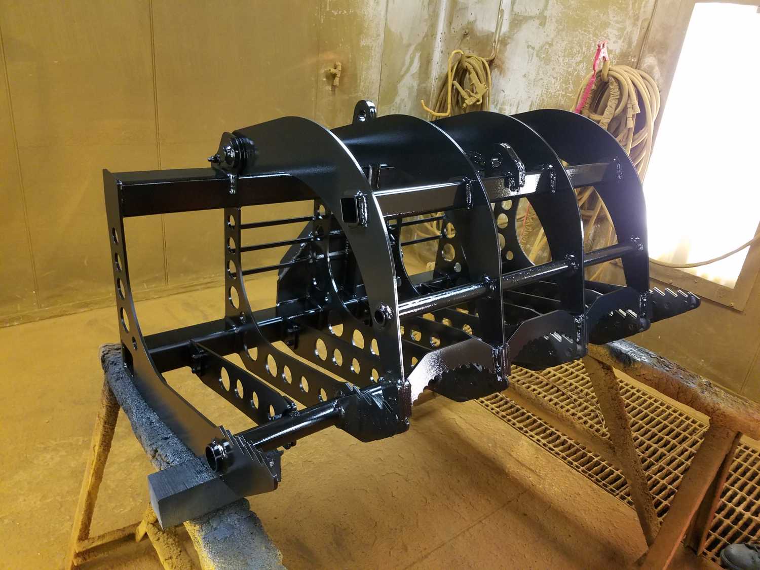

#57
Say hello to my new little friend. Just under 33" wide.
This one has a mini universal skid steer quick attach.
Travis
   / Demand for a PT Grapple?? #58
Now that is just too cool!!!!! :)
What does it weigh?
   / Demand for a PT Grapple?? #60
Nice!
How much with the PT425 QA?
How much does it weigh?
