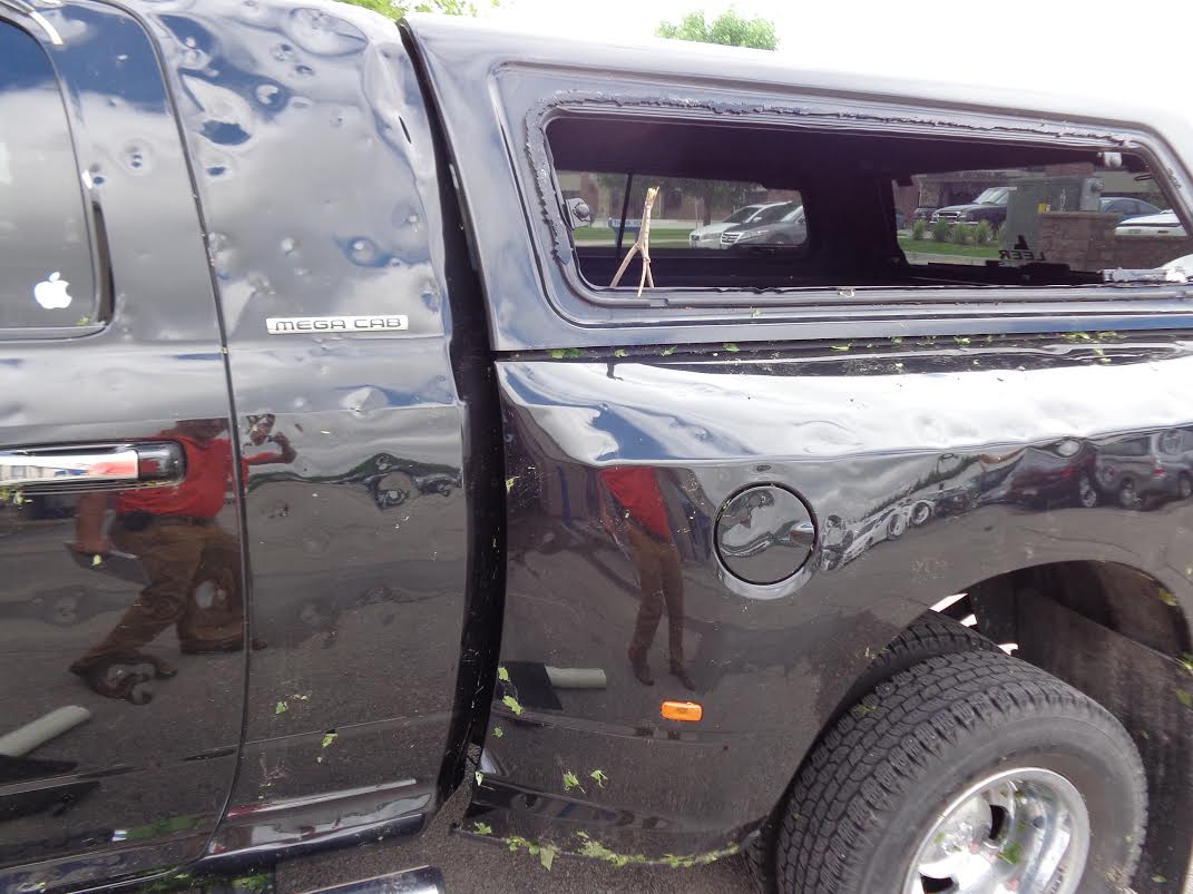

Below is a picture sent to me by friend who works for major insurance company catastrophe team. This is the kind of stuff they can fix.

I don't think the truck in that picture is a candidate for Paint less Dent Repair.
While I'm sure any of those dents can be removed that way. That vehicle just has too many to be cost effective.

According to my friend who has been doing this for well over 30 years, 10 on Cat Team. About 30 to 40 dents is max for a hood or deck lid. Bolt on and off panel $ 1200 to $ 1700 depending on cost of panel, labor and paint inside and out. A QP or Roof is a complete different thing. It can easlly go over 4 to 8 k. I like ray66v have a lot of experience in repairing damaged vehicles back to oem condition and none of it is cheap.
I find what good PDR people can do hard to believe also.
But trust me on one thing Insurance Companies are by far the best business people in the world. If they can get a 5 K job done for $ 3000.00 they will encourage and promote and mandate it until it becomes the standard.

Oh I totally see your point. I'm sure that is what's done.
My only concern as a customer if that was my truck in your picture, its black, the amount of dents large and small on those panels means the original support of those panels will never be as new. They may be pushed out at the time and look great but After a year once the insurance paid the bill and I have no recourse. I would find it hard to believe those black panels in the hot sun and cold winters that those panels won't distort somewhat after that enormous amount of reconstruction the panels went thru.
I would insist the truck be totaled or the panels replaced. Or a lifetime warranty. Yes it's more work and money to replace the panels but they won't distort down the road.
It's Black, my fear would be nothing but ripples apearing in certain light. Your in auto body repair, ray66v is or was in auto body repair and so was I. I think you see my point. Sometimes bodymen can see things on a panel others may not notice. If you know what I mean. I would not want to be walking up to my truck in a parking lot and see the side of my black truck moving as I walk.
