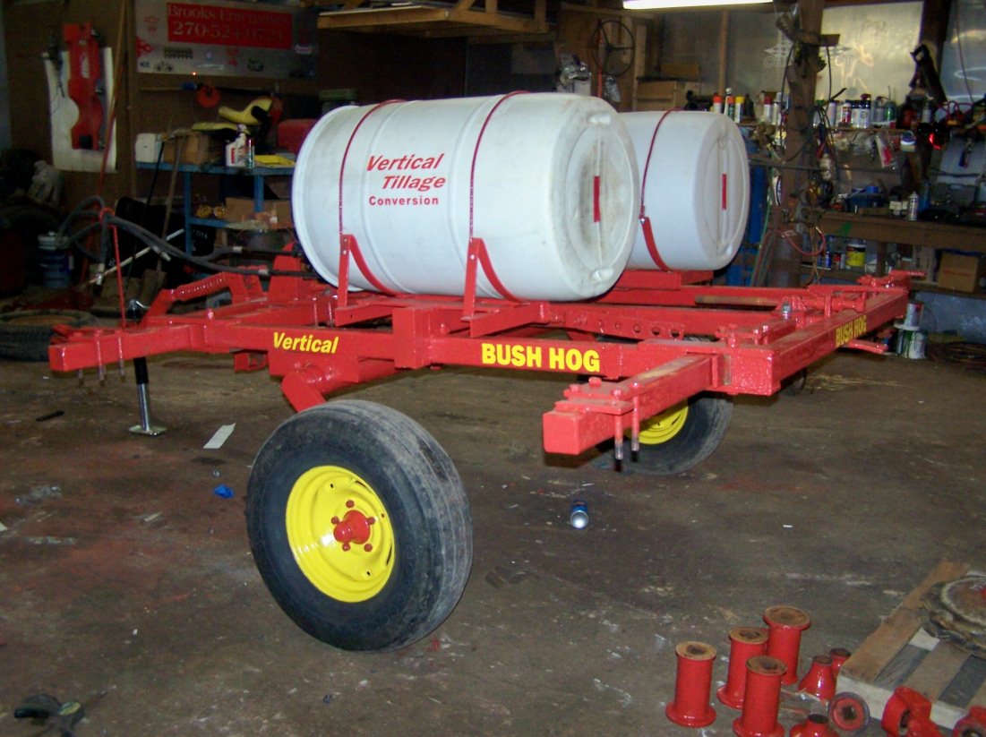

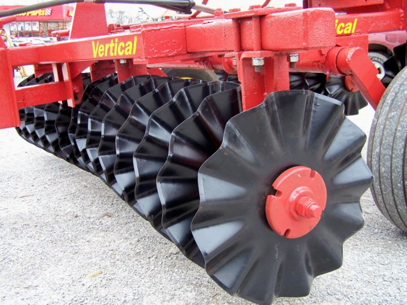

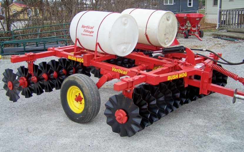

Should work fine if you can run the discs straight and be sure to keep the axles a little longer for the thicker 6mm coulter blades. Ken Sweet
No problem. Now I need 28 coulters--maybe an early birthday present for myself :).
   / Depending on Demand, We may be going Vertical.
#22
Great Plains is now making one with the disks at a slight angle. It does not work like a usual disk, but it is better at killing weeds. My dad has a 25' (i think) straight blade model an it does not do as well as he had hoped for killing weeds especaily mares tail.
Corn tilled only with it did do quite well though.
We make ours gangs adjustable, just in case, the customer has a need to run at a angle. Ken Sweet
