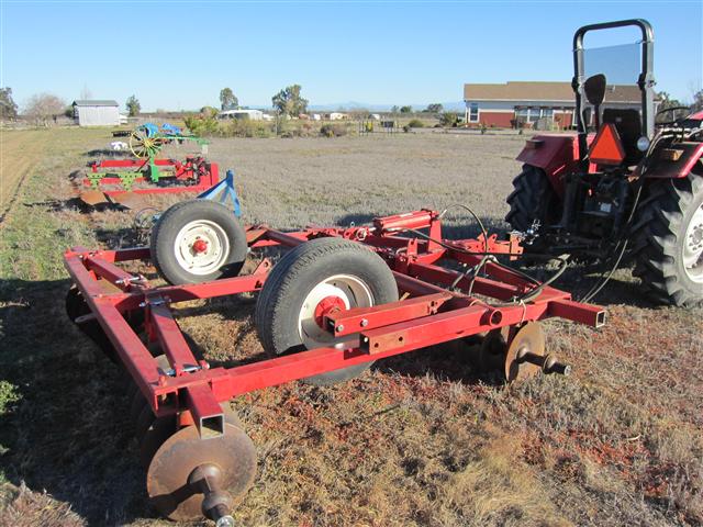

UPDATE: Here is pictures of the finished refurbed and converted Vertical Tillage Tool for smaller farmers. Ken Sweet
Do you think with the blades you now have on it that if the angle was changed to be sharp again it would be like a disc? You know where it may serve as both a vertical till and a tandem disc?
   / Depending on Demand, We may be going Vertical.
#12
I am thinking that 5-10 degrees is about all the angle side load I would want to put on the 20 inch flat/wavy blades. Ken Sweet

Mostly just curious here but, do you think it would even be possible to make a smaller (say 5ft wide) VT and still maintain the proper disk to weight ratio, such that a CUT would be able to pull it and achieve the desired effect? If so, do you have plans to eventually build one along that size??
#15
We are working on that now. Ken Sweet

Update: Sold our first 8 Ft Vertical Tillage conversion tool to a fellow in North Carolina. Starting on second one currently. Ken Sweet

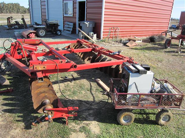

Now you've gone and done it -- you've inspired me to start yet another project--converting my old Minneapolis Moline KS1300 (made by Krause) wheel disc into a VTT :D. Should be relatively easy to do since I cut that 13-ft disc down to about 7.5 ft wide so my 2008 Mahindra 5525 (54 hp engine) can handle it.
View attachment 252185View attachment 252186
Should work fine if you can run the discs straight and be sure to keep the axles a little longer for the thicker 6mm coulter blades. Ken Sweet
