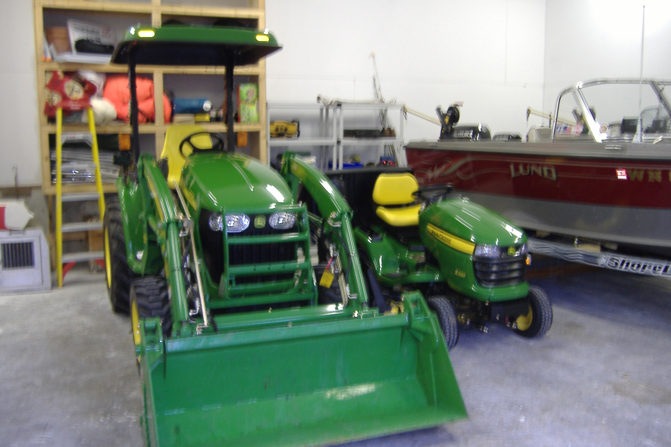

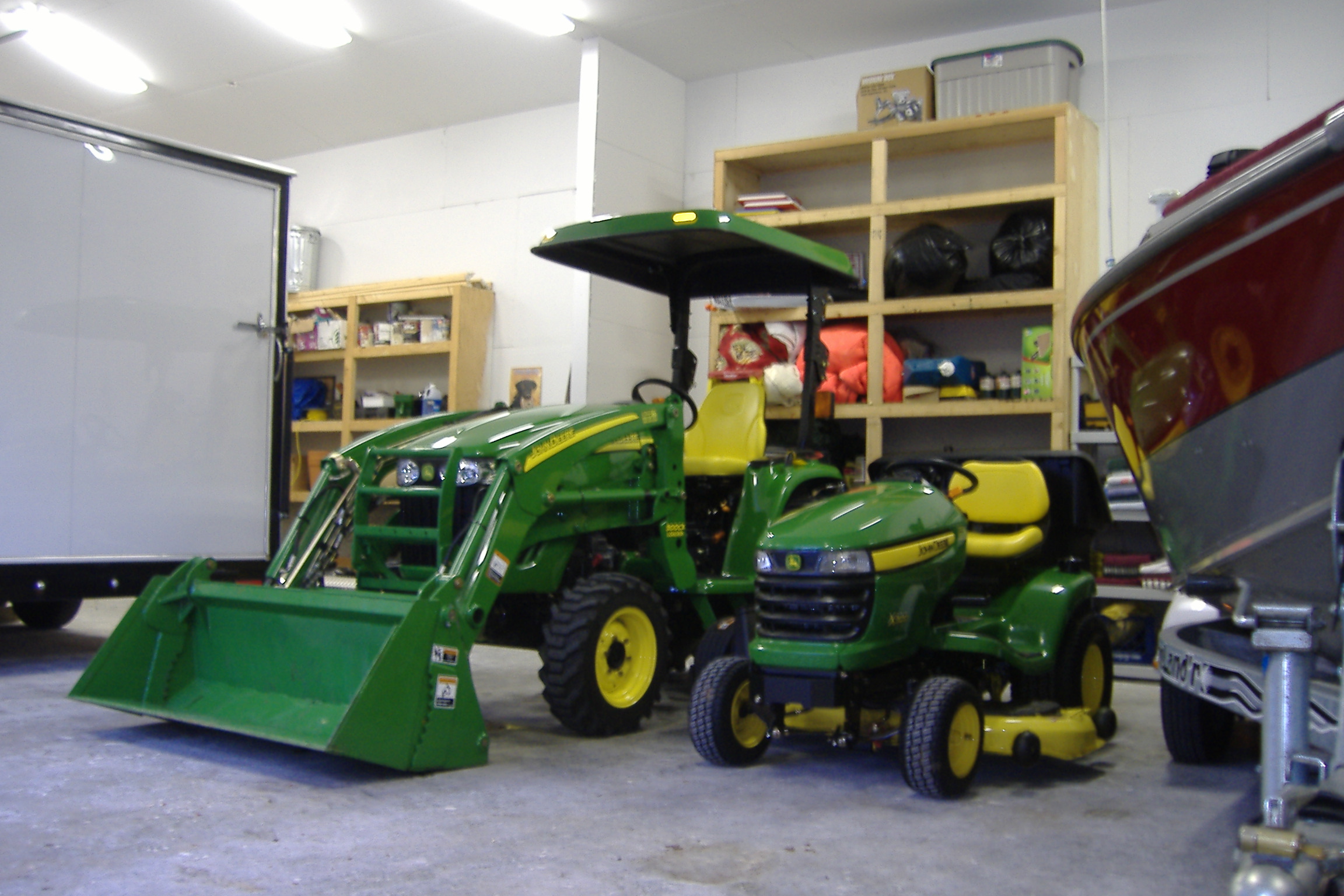

Yesterday I found an old loafing shed for my friend that she didn't know she had. Burn pile is too big now and now that I'm an expert I figure the free work is over. I brought her home to give her a good cleaning.
Heck, I even drove it a couple miles up the road to a party last night. Fresh salmonon the BBQ. I've been so wrapped up with the new toy, I fogot I have a boat that hasn't been wet in a while and the Silvers are a runnin! No Ho like Coho!
   / Destruction of a new guy, and his tractor
#20
Time to rest the green and try to get some silver in that red (boat).
