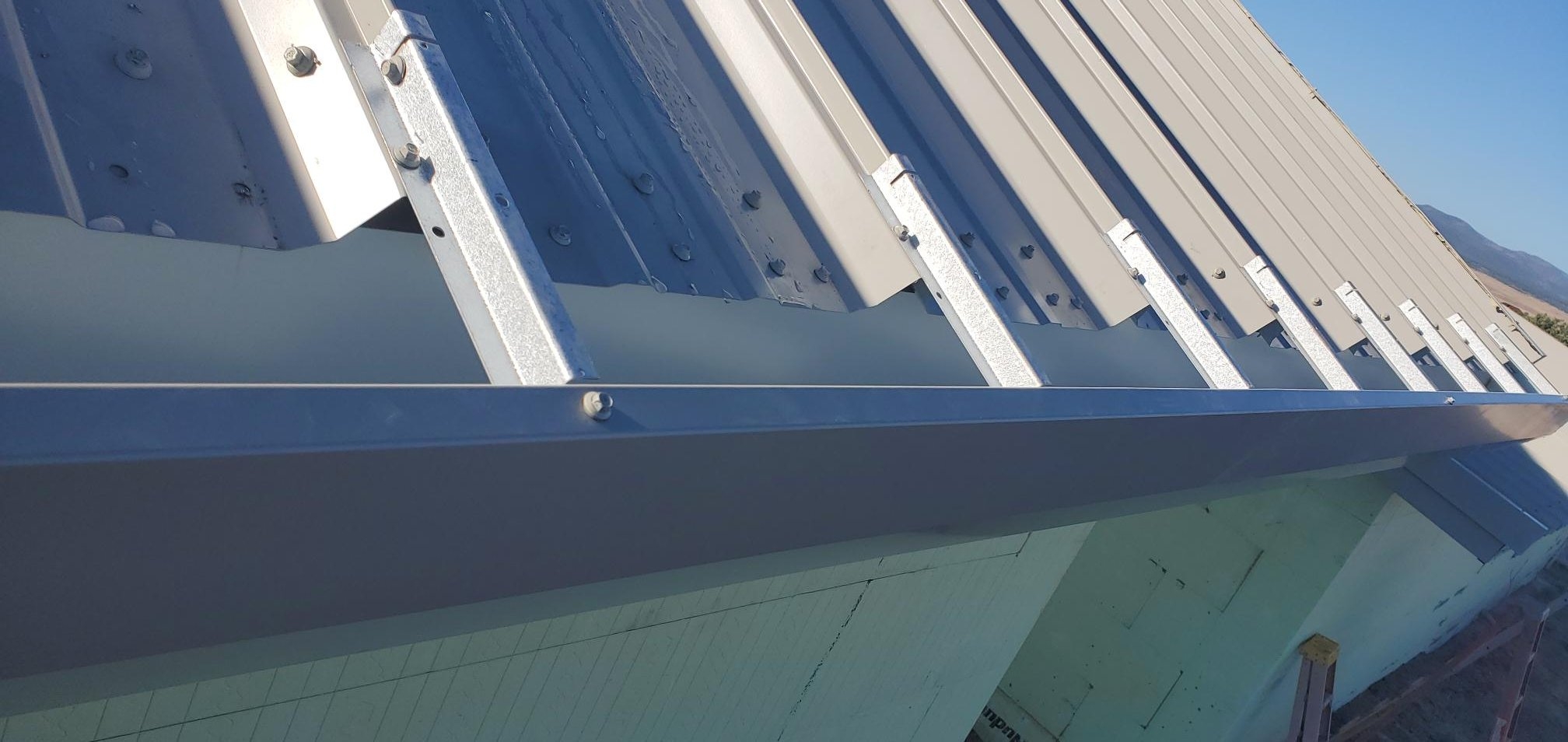

I agree that gutters wont stop snow from sliding. They may only delay it slightly.
You can absolutely pull snow off gravel. My entire driveway and garage approach is gravel also. Just keep your blade an inch above ground if you need to.

I realize that it would be one more expense, but I would think about paving the apron/slope into the garage to keep things cleaner, and help dealing with any snow dumps.
