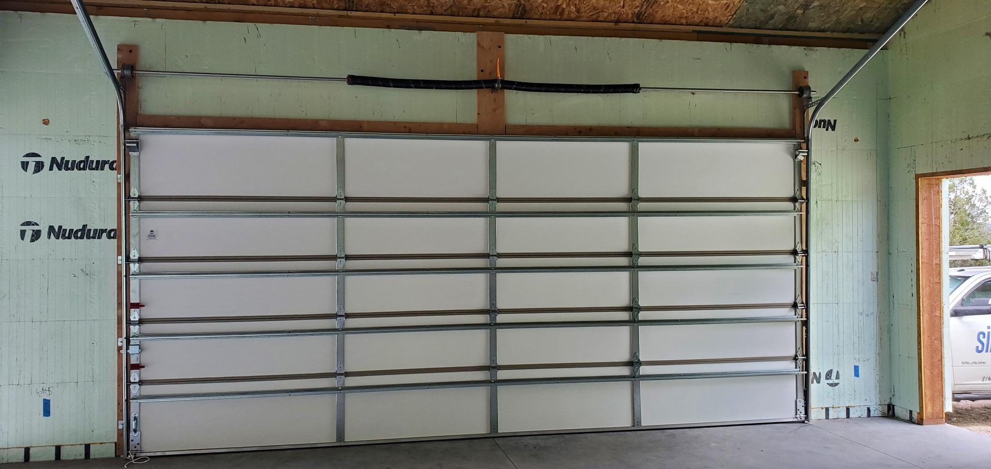

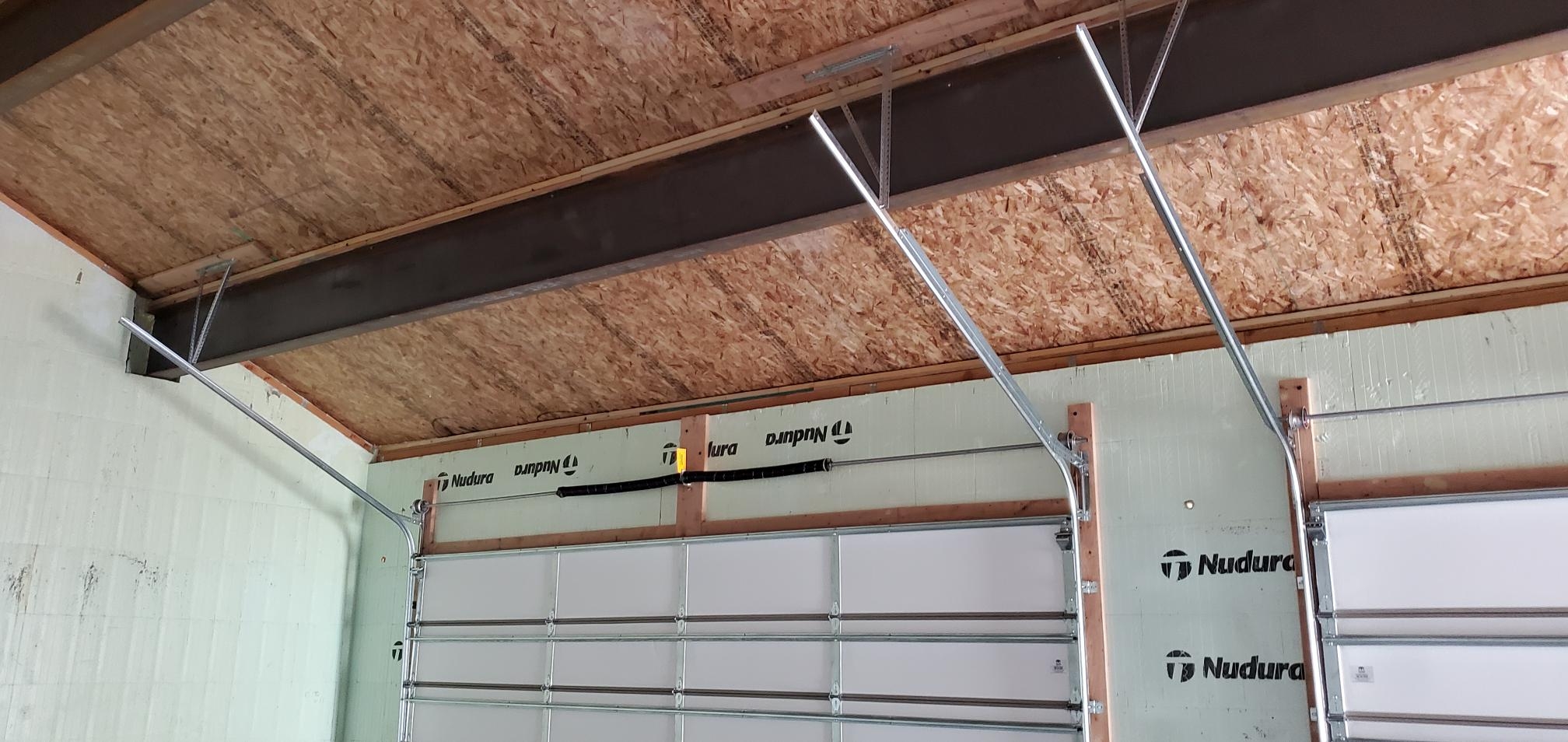

#112
Garage Doors Installed. The spring tension is pretty insane going up that 5:12 pitch

   / Detach 48x28 Garage - Footings #113
Kind of explains why pitch following doors are so pricey, doesn't it?
The doors look great!
All the best, Peter

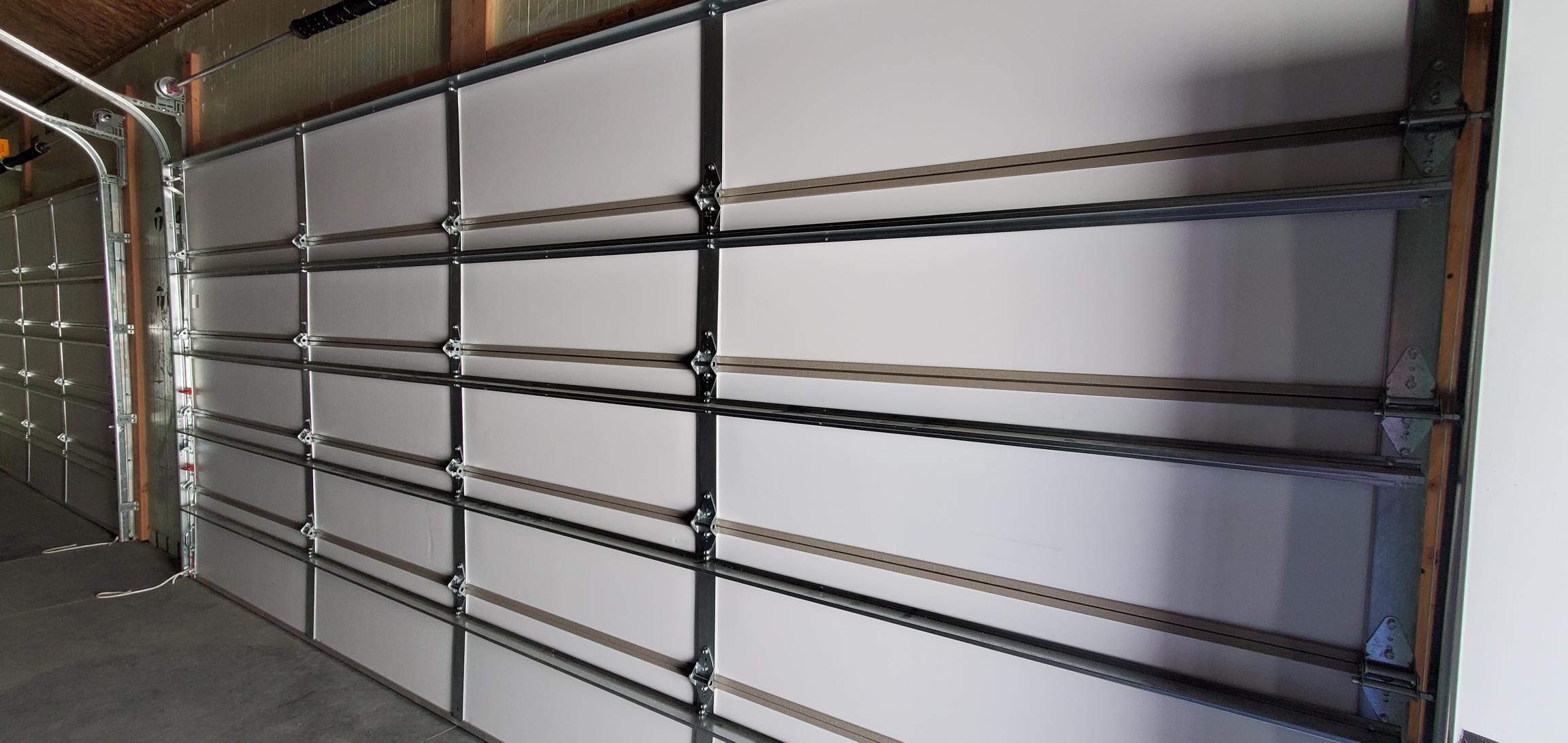

#114
My 18x8 door is reinforced by 5 metal channels as seen in the photo. Last week we had winds hitting 40-45mph. I noticed the doors would kind of flex in the middle as the winds were blowing. Nothing was damaged but it kind of looked concerning. Door installer claims the doors are rated for 90mph with those channels. He said that most doors only get one or two channels and I have 5 which is why it has the 90mph rating.
I know they are not "hurricane rated" but is it normal for them to flex in high winds like that?

18’ doors are gonna “breathe” a bit bud.
The “struts” come in different sizes….3” tall 4” tall etc. I wonder which ones they used?
How well the tracks are attached to the jambs and the track gauge and rollers make the most difference with wind load.
   / Detach 48x28 Garage - Footings #116
Short answer, yes some flex is normal, but how much is ok is a bit difficult to diagnosis from a distance. The horizontal metal rails are basically your "U" channels to resist inward pressure. The heavier they are the more resistance you have.
You can help your doors by not having open windows or doors on the opposite side. i.e. keeping the pressure up inside.
I measured and the channels are 2.25" tall
There are at least 7 anchor bolts holding each side of the track into the wood trim pieces which are anchored into the concrete wall.
All the best,
Peter
Interesting you should say that. When I opened the side entry door, the garage doors definitely started to flex more. Then when I closed the side door, the flex was notably less.
So the side door creates more pressure inside? I didn't know that but it does makes sense.
   / Detach 48x28 Garage - Footings #119
Garage doors aren't airtight, but they do flex due to the pressure difference between the outside and the inside of the door. So, if the air leaking by the door gets trapped, even for a little while, it will help raise the pressure inside, and lower the pressure differential across the door. A small pressure difference adds up to a lot of force over a large area door.
